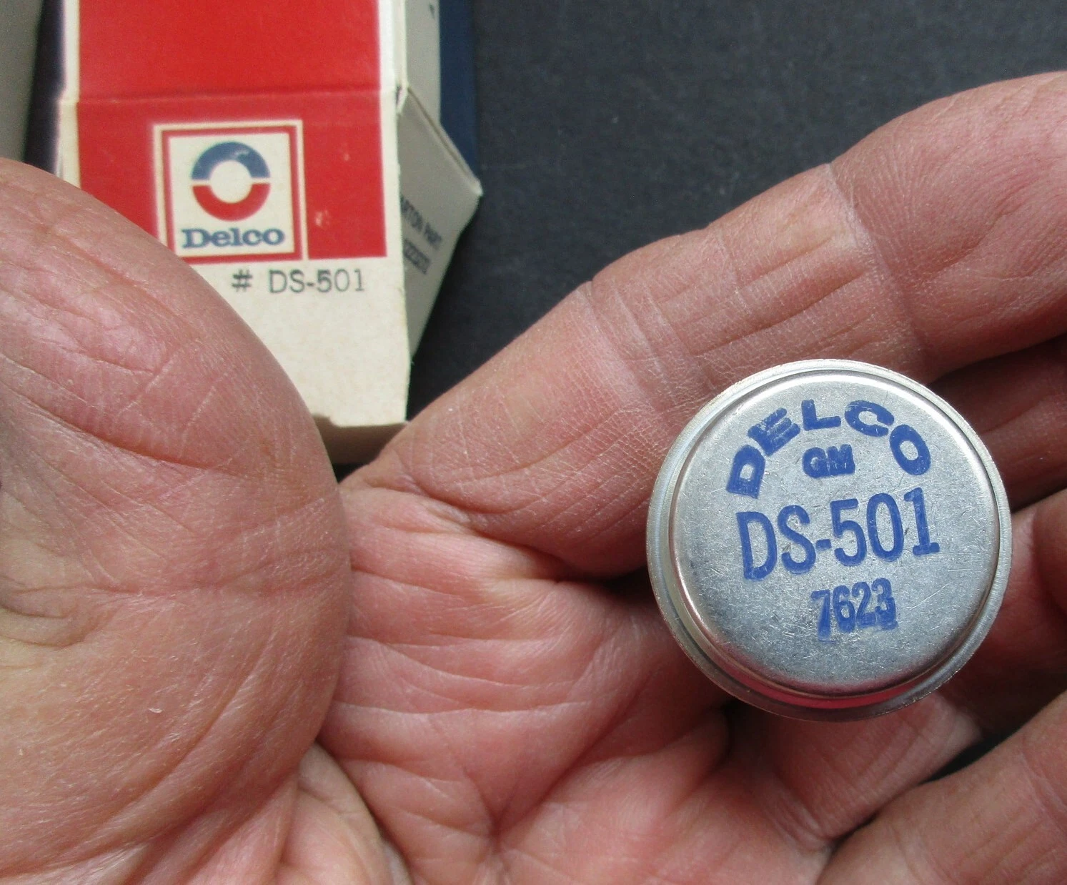

I was having an issue with the factory AM/FM radio in my Blazer. The volume would fade in and out, and sometimes would not come back at all unless you shut off the radio and turn it back on. The weakest link on these old Delco radios is the germanium output transistor. I noticed that a previous owner had replaced the output transistor with a cheap replacement, not a Delco part. I happened to have an old convector (amplifier) assembly from an early '70's Pontiac that had two original DS-501 Delco output transistors. I swapped one onto my radio, which on the truck/van AM/FM units is easily accessed in the aluminum heat sink on the side of the radio facing the passengers side of the truck. After swapping it out, I bench tested the unit, and it came to life, and the irregular volume was gone.
