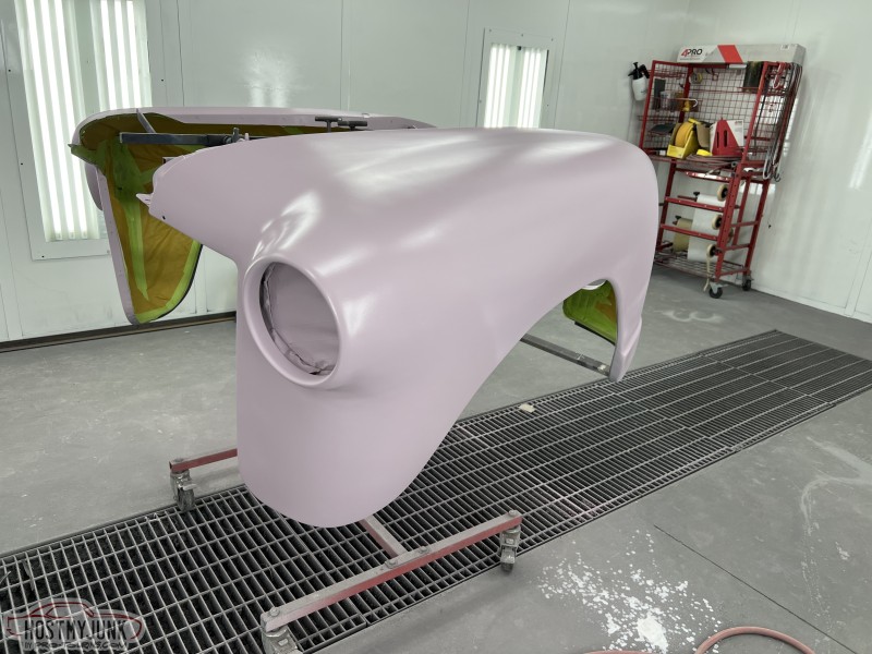

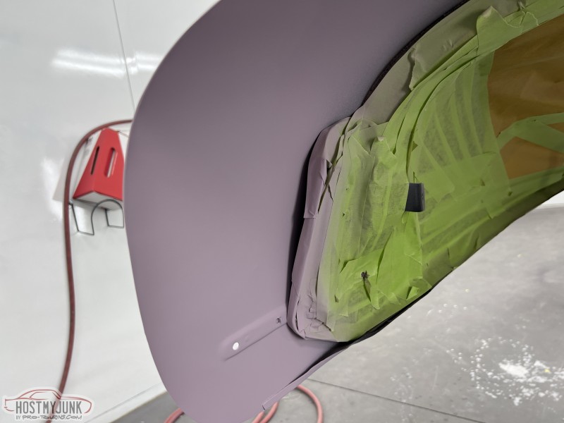

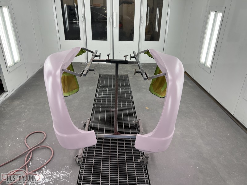

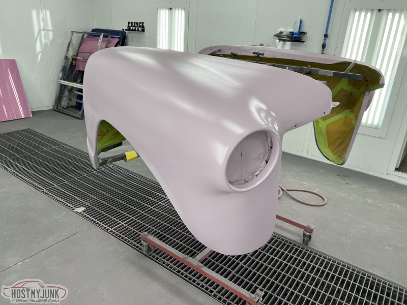

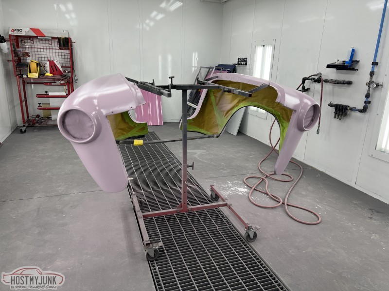

I brought the front fenders to work and today I was able to get them in the booth for a few coats of Evercoat Optex polyester primer. I will let these cure and shrink up until next week some time and then start blocking them.

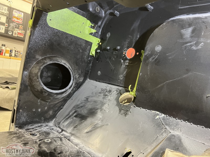

Not being able to do that I removed the front inner fenders to block them. Its been so long since I have worked on them I forgot that I only stripped them to bare metal and sprayed epoxy, I had never done the filler work where I did some fabrication around the new suspension. So I have now spent roughly ten hours doing just that. One is complete and the other about 70% there. Hoping to finash them both by weeks end, or over this coming weekend so Monday I can bring them to work and get them, sprayed with the Evercoat poly.

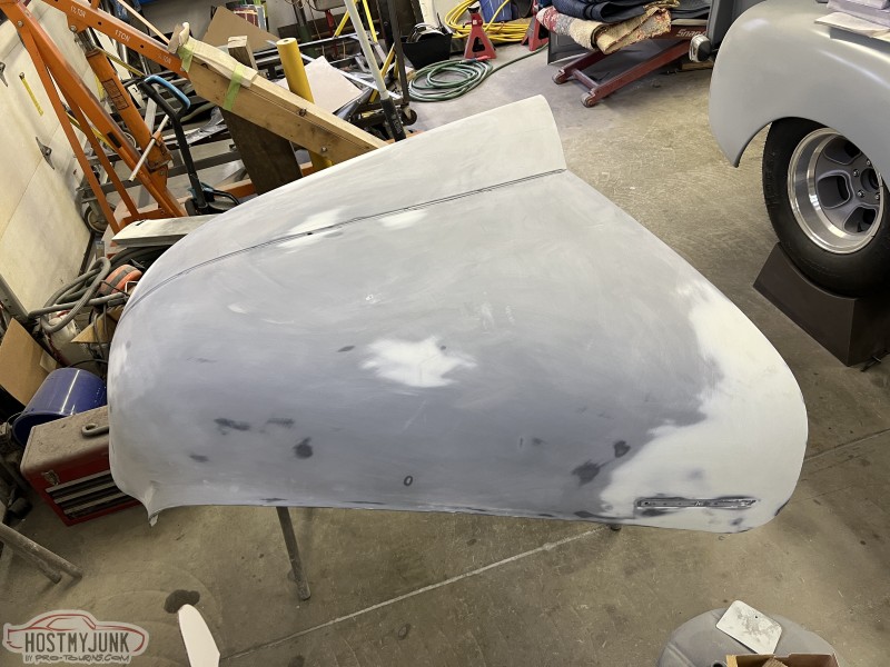

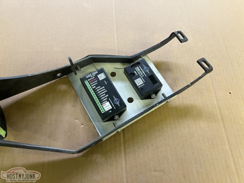

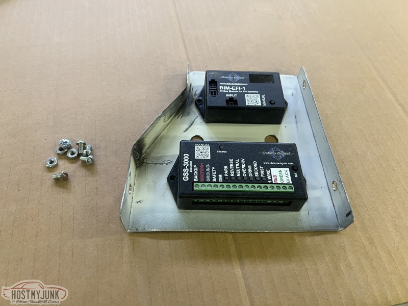

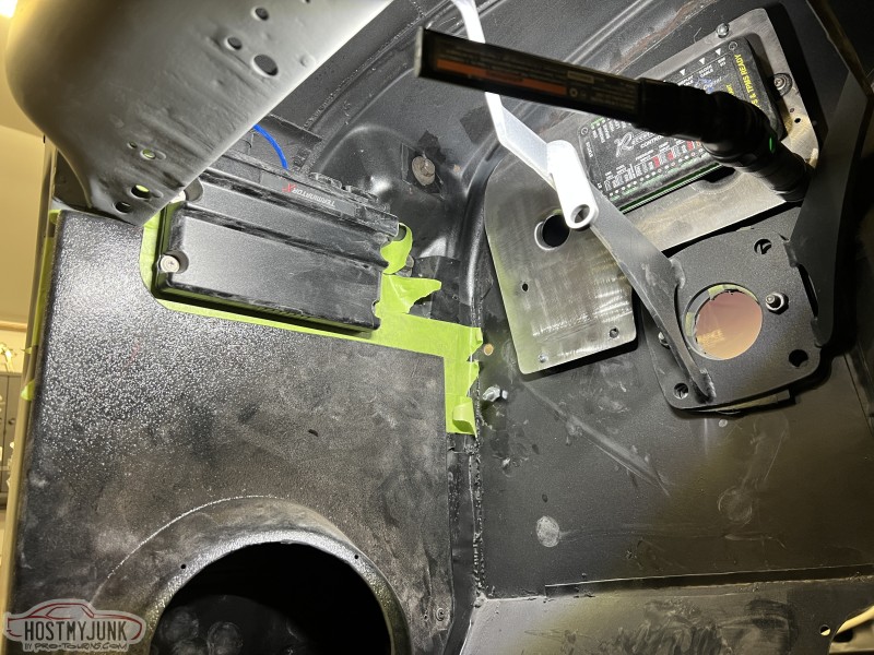

I spent 11 hours last weekend doing bodywork on my hood. I didn't take a lot of pictures, but here it is waiting to go to the booth for poly prime. Just when I thought I was done I flipped it over to mask the underside so I don't get a ton of overspray on the bottom. Thats when I realized that the roughly 1.25" wide flat on the edge of the hood that rolls inward at the fender looked like crap and will toltally be seen with the hood open. So another couple hpurs fixing that and its all now done.
I ended up with the day off today due to some snow which gave me some unexpected shop time. I should have spent it doing final body work on the inner fender, but in all honesty I just wasn't into it. So instead I did some much needed clean up and then moved to some of the inetrior things that still needed to be addressed.

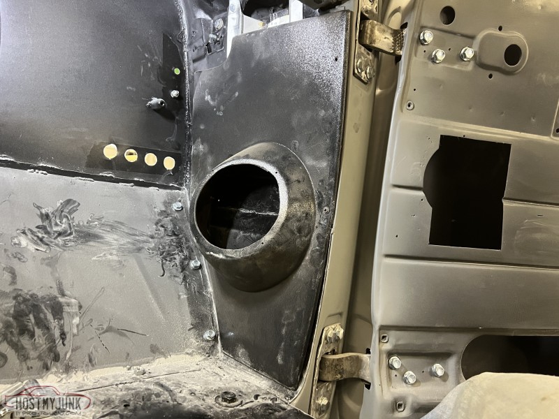

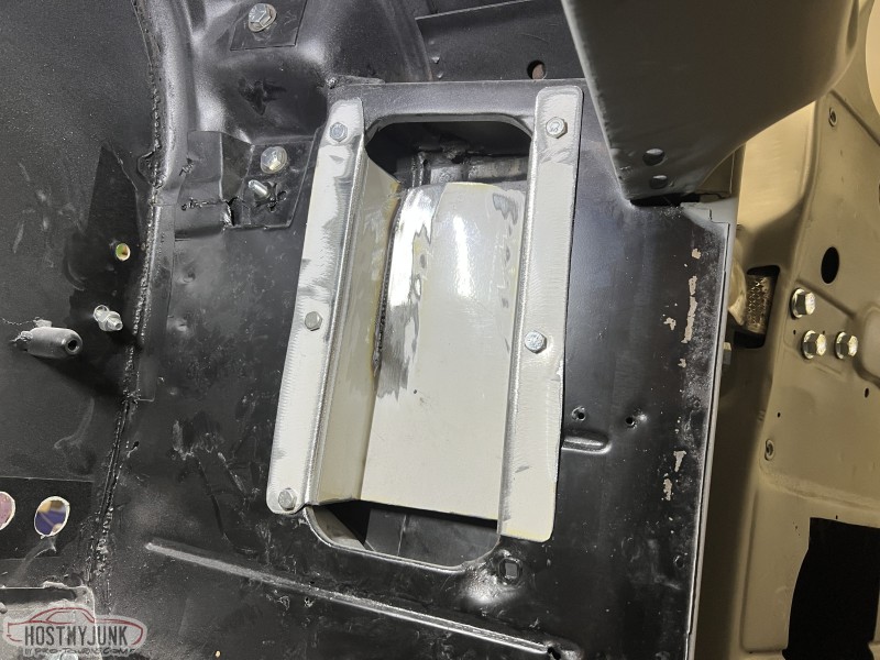

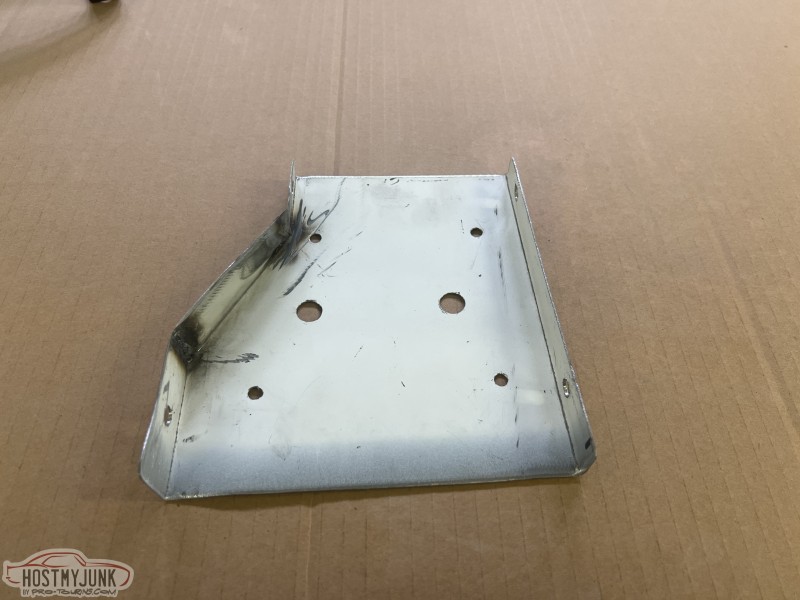

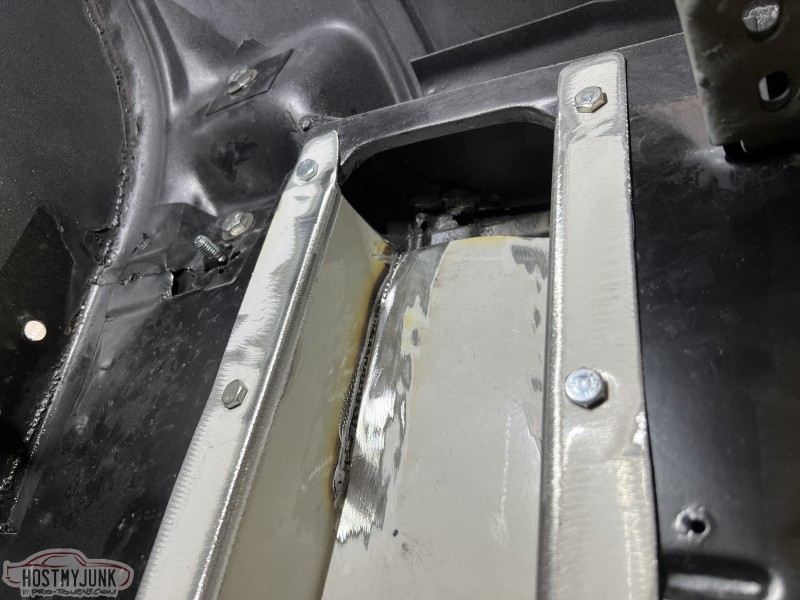

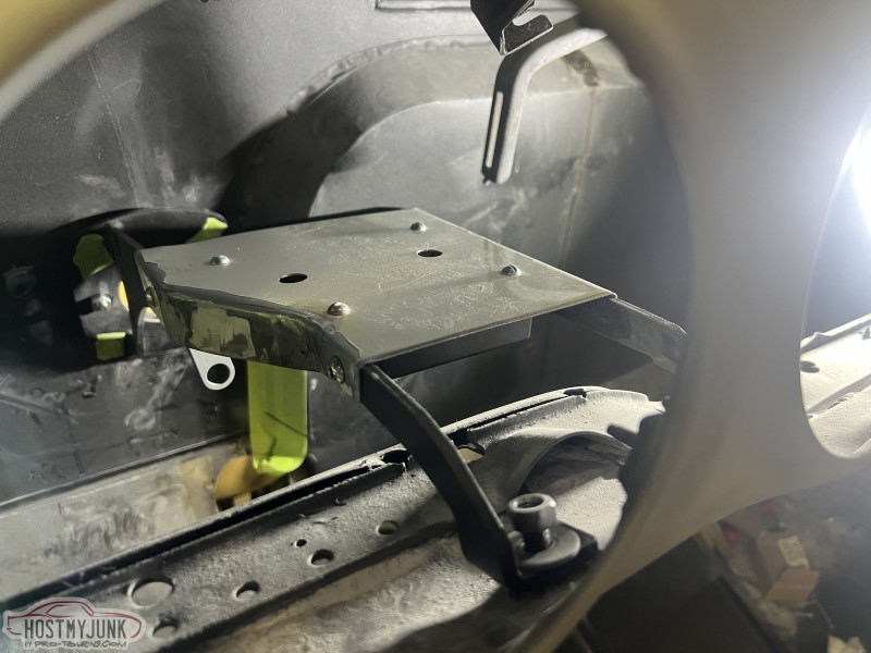

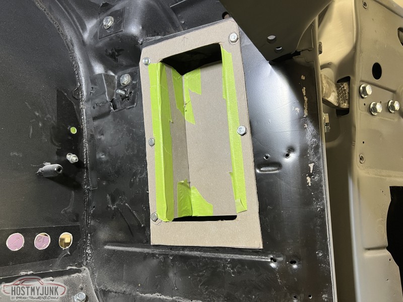

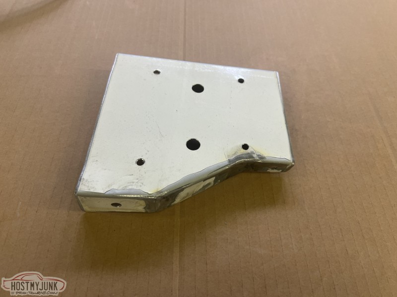

I have this pocket on the passenger cowl side that I decided to make a filler panel to use for mounting something. Not sure what yet, but I know this will end up being useful. I may end up putting the Bim modules in here for the efi and shifter if the wiring reaches. This also might be a good place for bus bars fr the wiring. Again, this is up in the air.
First I made a cardboard template... Then I transferred that to some metal I had on hand. In the end I didn't make it with the top and bottom cross pieces like the template. I don't see the need, also I left the top and bottom open to be able to run wires through it for the power windows and whatever made need to go up through the top.
I then fitted the passenger-side kick panel I have.

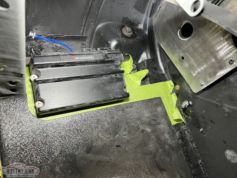

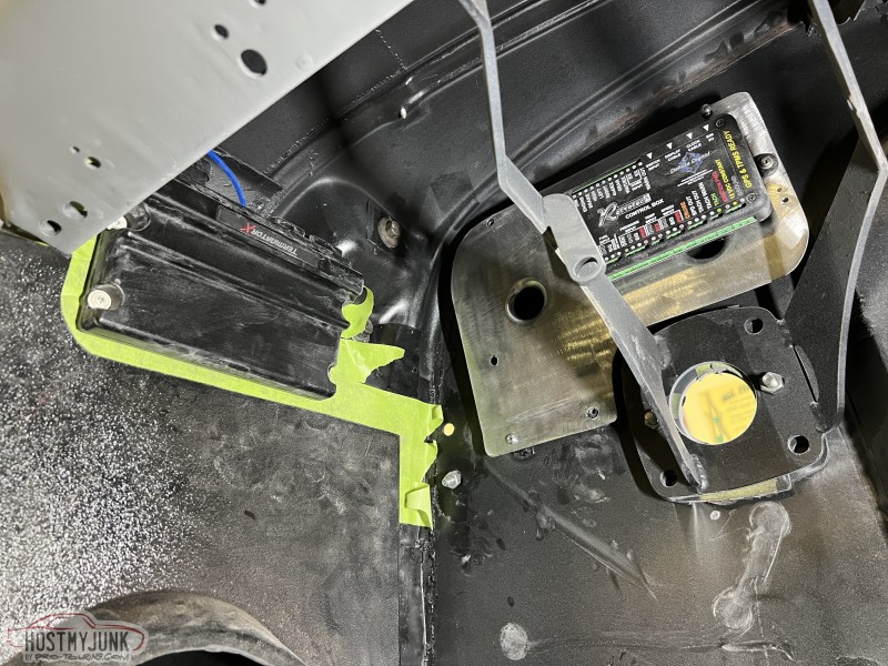

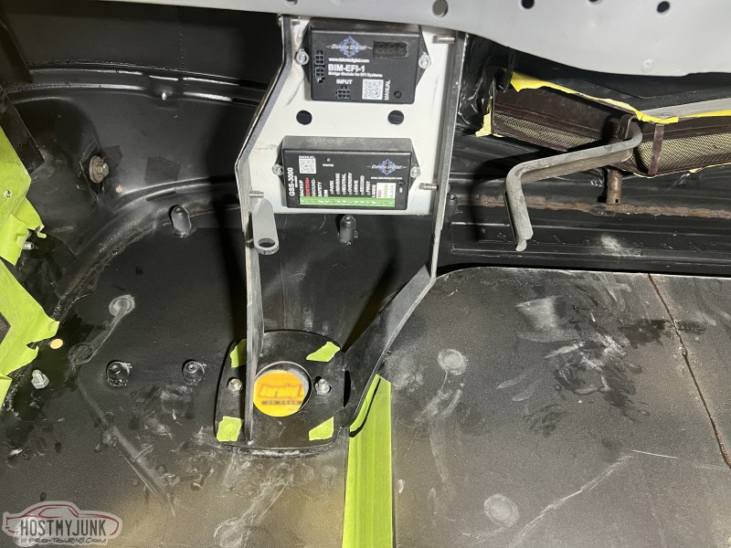

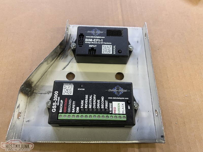

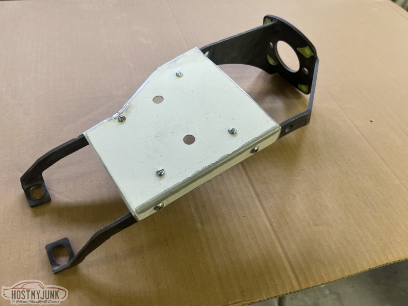

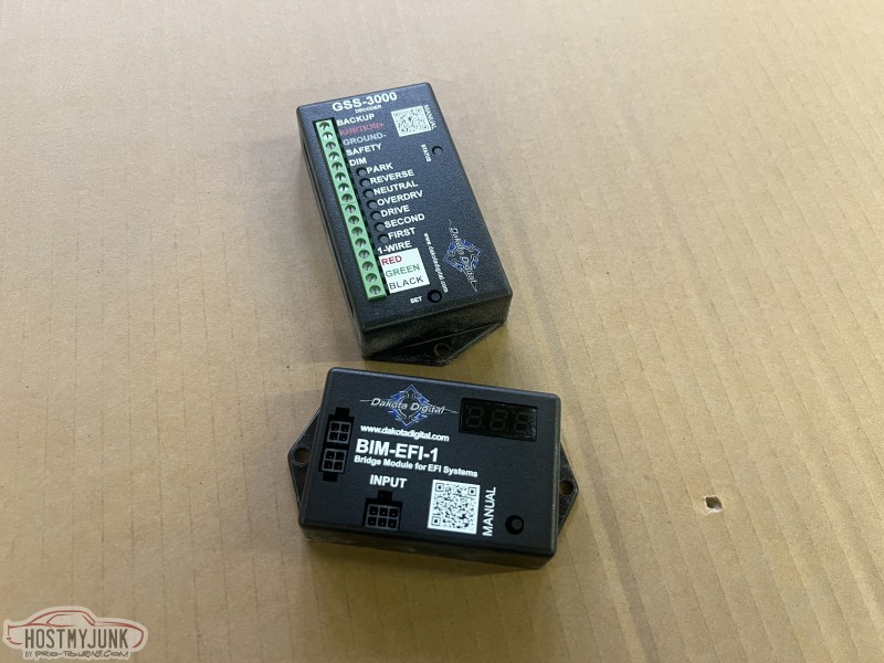

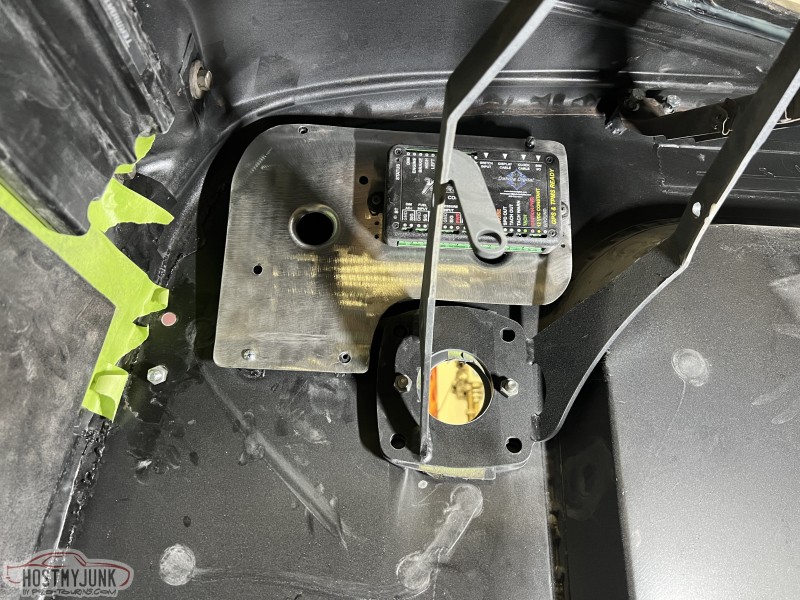

After I was done on that side I went over to the driver side. I now have the Holley Terminator X computer and harness to run my EFI. I had to figure out where to mount that in relation to the Painless wiring harness and the module for the Dakota Digital RTX gauges. This is what I came up with.
Technically, the ecu is upside down, but I mounted it this way so I can easily see the lights on the bottom edge to verify everything is working properly, or not.
I'm very happy with how thiings are working out here. There is so much to cram into a small area that it can make it hard to fit. I will use some rubber isolators in between the ecu and the metal body for vibration. Not sure how much it will help, but its worth a shot.

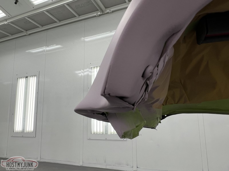

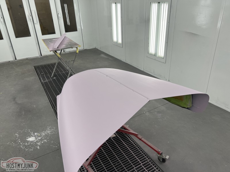

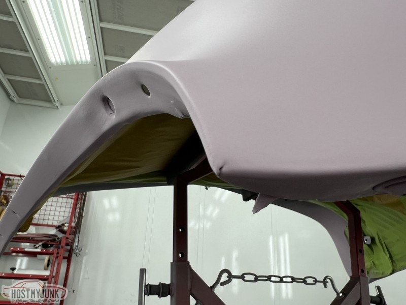

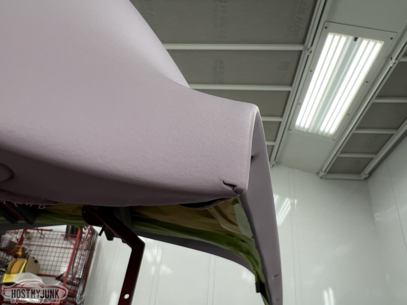

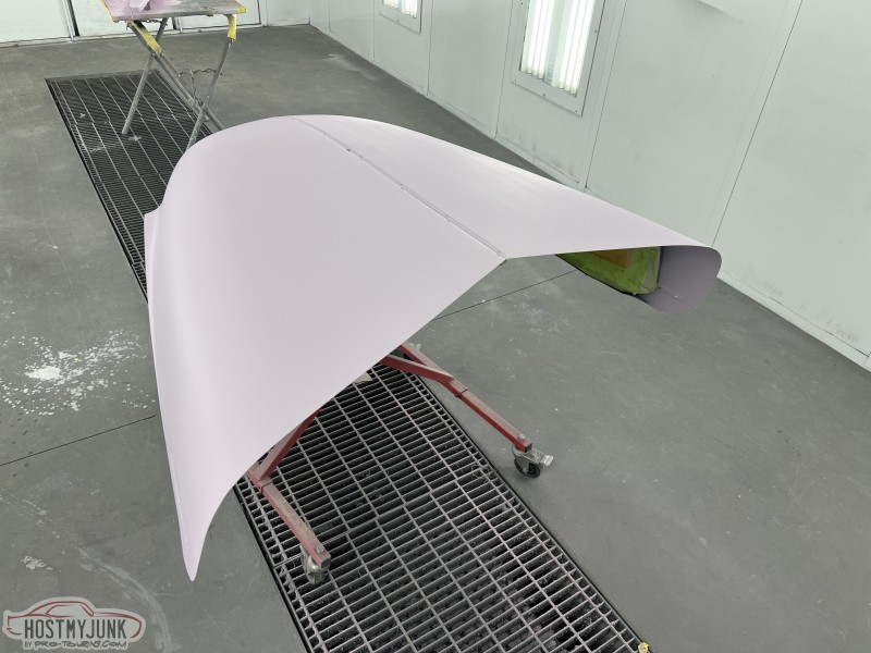

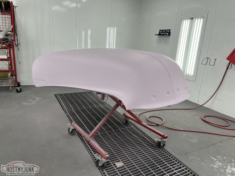

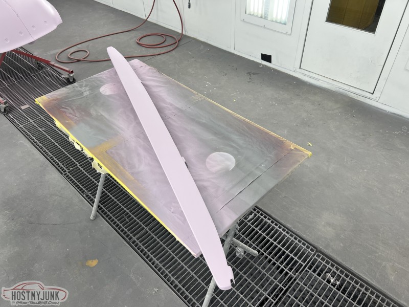

Its been a few weeks now since I got the body work done on the hood as well as the newly made filler panel that goes between the rolled pan and bumper. I would love to have sprayed these a bit ago, but when loading the hood in my truck to bring to school I had to stop dead in my tracks. Seems the hood is too wide for my Toyota Tacoma bed! I knew I had the hood at school before so I figured this was how I did it. Once my memory kicked in I remembered that I had borrowed a friends 2500 GMC and slid it in his bed. Once I remember that all I had to do was ask to borrow his truck, but here is the tricky part...he was having some heart troubles and was in the hospital. While we talked every day the last thing I was going to to was ask to use his truck.
In any case, he is out and fine now. So he came over and helped me load the hood and we swapped trucks for the day so I could bring the hood to school.

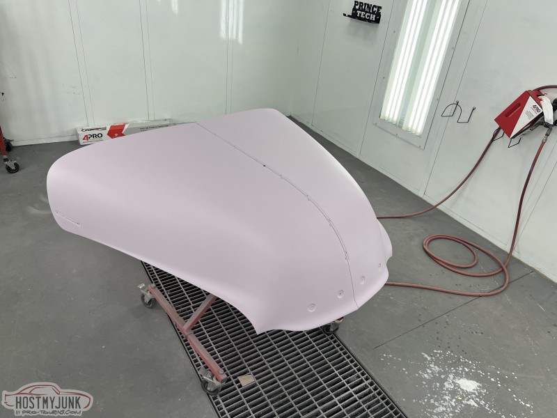

Here it is today in three coats of Evercoat Optex poly primer.

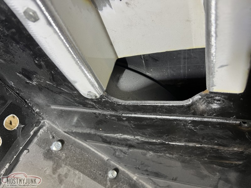

Everything was looking good and I was feeling like progress was being made in a major way.....until I noticed the cracks! I'm shocked I had not seen them before at any time when I stripped the hood to bare metal, or sprayed the epoxy, or block sanded every inch of it as well as the filler work. How could I have missed them? Your guess is as good as mine. But here I am with two identical cracks on each front corner edge of the hood. Is this normal for these hoods, given that it's an original 51 hood?
So one step forward and two back. Now I will flip the hood over, grind down the areas, and weld the cracks, body filler, and reprise. All in only a few hours, but it sucks to go backwards no matter what.
And for the record, I am now at 926.3 hours in this project!

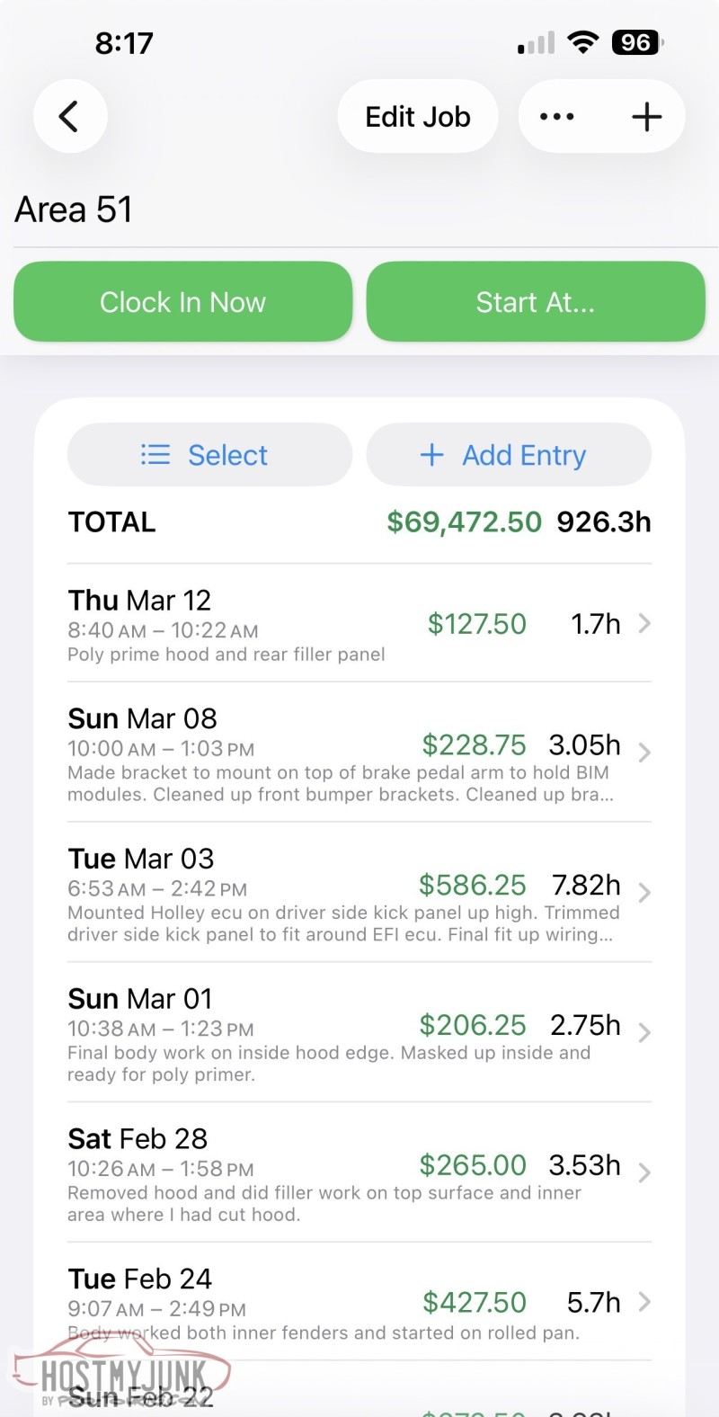

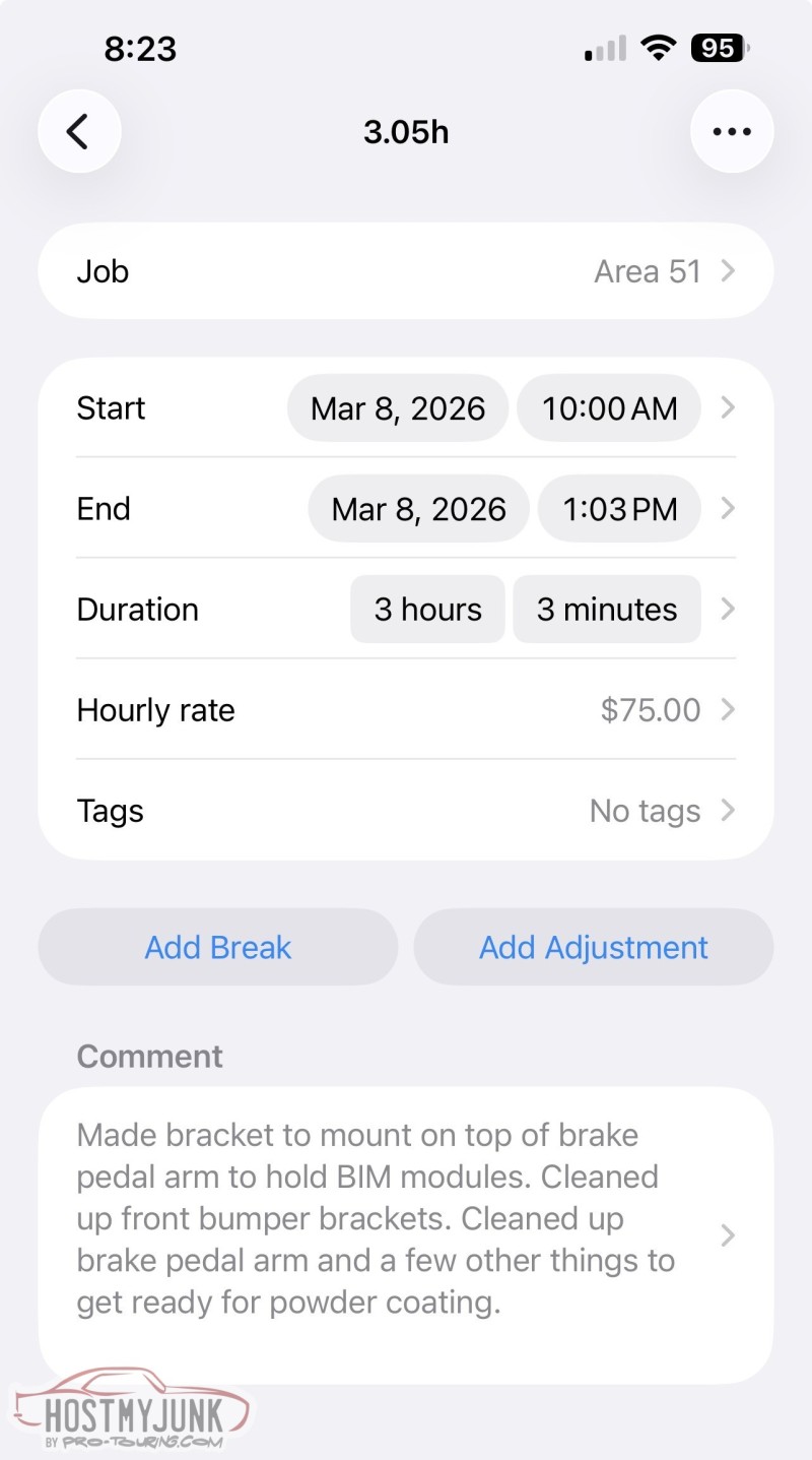

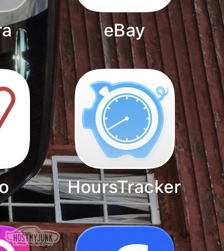

Because I do a fair amount of side work on hot rods for people I needed a good way to track my time that was better than using a pen and pad. I found this app called "Hours Tracker". With this, I can create a job, name it, give it an hourly rate. Then punch in and out to the minute. Give each time stamp a comment on what was done during that time period. I can also export it to an email that creates a bill for a customer.
Here is the job for my truck, I call Area51 with all time stamps so far. Now I obviously am not charging myself, but if I were paying someone to build this truck this is what it would co$t.
And here is an actual time stamp from last week. This shows punch in and out, hourly rate, and the note for what I did during that time.

So today is my 57th birthday, and as such, I spent only a couple of hours in the shop working on buttoning up a couple of things I had already started.
To go back to a previous post about finding ways to mount everything under the dash that needs to be put somewhere. I have these two modules from Dakota Digital. Once is for the gear selector interface that wires between the transmission and the gauges that will show what gear it is in, much as a new car does. The other one wires between the Holley Term X and the Dakota Digital module for the gauges I showed previously.
So I started thinking about all the dead space above the steering column support bracket I am using and thought that might be a good place for some things.
I had used some poster board material and made a quick mock-up of what I wanted, then transferred it to some sheet metal I have and made this.
I drilled out the mounting holes for the modules as well as two larger holes that will eventually get grommets installed and use them as a pass through for the wiring. Here are the two modules bolted in place.
I drilled mounting holes in the column support and tapped them to accept 1/4-20 screws. Here, the bracket is mounted.
And finally, here is the entire thing bolted in place inside the cab. I admit that at first glance it might seem odd to have them facing down, but my thought is that I need to have easy access to them at any point I need to be able to see them. If they were mounted on the top the only way to see them is if the gauges were removed, or with a mirror.
This also leaves the top of the bracket open for mounting something else if I see a need.
I hope you’re all enjoying this build thread. I’ve noticed it’s mostly the same four or five people commenting, which is totally fine—I’m not posting this to feed my ego. I’m really just trying to get a sense of whether the thread is useful or interesting to anyone beyond myself.
I also hope I’m not getting too far into the weeds with all the detailed photos and explanations. I was fortunate to grow up with a dad who taught me a lot, along with several mentors and friends I deeply respect who also shared their knowledge with me.
As I’ve said before, my main goal in this thread is to share ideas or techniques that might help others. Even if it’s just a small tip or a different way of doing something, it's worthwhile. And if people are here simply to enjoy following along with a build like this, I’m happy to provide that, too.

What started out to be a simple refresh on my '49 has now lead to many upgrades. So far I've followed your lead on rounding the bed stakes. The rear fenders are now at a friend's shop having some dents & cracks reworked. Also, we are installing tubs in the bed, but not your usual style. We are taking a pair of rear fenders and cutting them so they fit between the bed sides & the frame rails.
So right now, I'd like to know where you positioned your gas filler in the left fender. Some dimensions would really help. Thanks much.

On my fuel filler, I made a template of the shape of it and moved it around in the area I knew it needed to be until I landed on a spot that fit well. I let that dictate the exact location.
Tonight I will go out and take some measurements and pictures of exactly where I put mine if that helps you. Stay tuned....

Apologies for it taking so long for me to get you these measurements. I have had a crazy week, and today was the first time I have had to get out in the shop.
I hope these measurements and pictures are helpful. If you need any more specific measurements, please let me know.
The leading edge of the gas filler opening is 5-3/8" from the fender edge
Using the center line of the 3/4" tape, it is exactly 3" from the closest slotted fender bolt hole. You can also see that the tape runs right next to that indentation in the fender.
Using those measurements will get you to here for the filler tube/hose to get to the tank.
