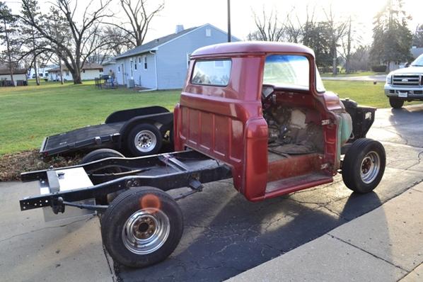

Now onto getting everything else off of and out of the truck including that original fuel tank. The tank wasn't even strapped in and the filler neck wasn't connected to the body. I am guessing that the previous owner lost the key to the locking gas cap on the body and decided to bypass it. Not good!
I guess I know what the truck's original color was now!

You should have seen the neighbor's face when I fired it up and pulled it out onto the street in this condition! I just wanted in facing the other way in the garage!
