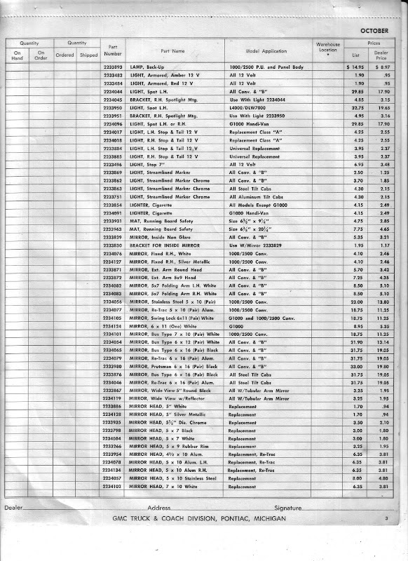

there are some of those big truck mirrors on ebay right now. for 1965 prices too. I almost jumped on them. intill i realized how much of a pain they would be in a parking lot.
