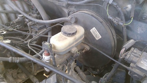

I have a firewall mounted brake booster for drum/drum brakes and all new lines plumed.
Wait... Most of the guys here are under the assumption that your truck is using a '70s style master cylinder / booster combination that looks roughly like this:
If your truck just happens to have an OEM style Hydrovac then diagnosis of the "pedal to the floor when the truck is running" is very different.

thats why I asked to have a few pics posted, to see exactly what is being used for brakes, booster, master cyl, pedal etc.
i recommend starting at one end and working through to the other end. check, adjust or replace as required. try not to skip anything because "that should be fine".
