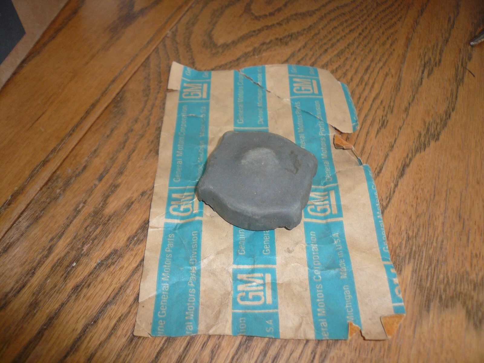

I did use stock style head bolts mainly for the aesthetic. Another thing I hope I don't regret.
Advanced Distributors rebuilt my distributor. Note red factory mark.
By the parts book, this shouldn't be the correct oil fill cap. But I believe it's what came on this engine. And the 80-mile barn find 70 looks to have the same cap. So I found an NOS version for the build.

On my 1970 K/5 TBC 350 engine, as well as my grandfather's 1970 350 K20, they both have/had the oil fill tube on the drivers side valve cover, with the twist on steel cap with heavy cork sealing gasket. This is GM 3714893.
The original tires on the 1970 K series were Goodyear Custom Xtra Grips. This was the case with both the K/5 I own as well as the K20 that my grandfather owned since new. Both have/had the 8.25" wide 16.5" wheel option.

I should have been more specific. I was referring to the driver's side oil filler tube, not the distributor vacuum tube as being on K series.
Additionally, I have the original carb from my grandfather's K20. It's a 7040208 versus the 7040511 on my Blazer's TBC coded engine.
I would love to see pics of the oil fill tube. I was not aware that a valve cover oil fill tube was available in 70. I know a lot of us add the 71-72 oil fill tube to pre 71 trucks for the convenience. I did it on our 70 Blazer.
