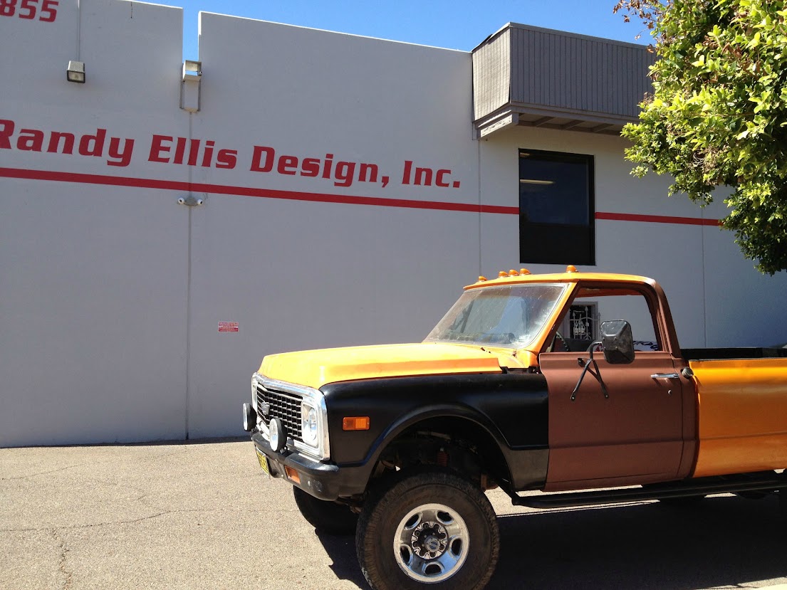

So, this morning, I backed out the truck for the last drive as a gas powered beast....
Glory shots of my not so beautiful truck....

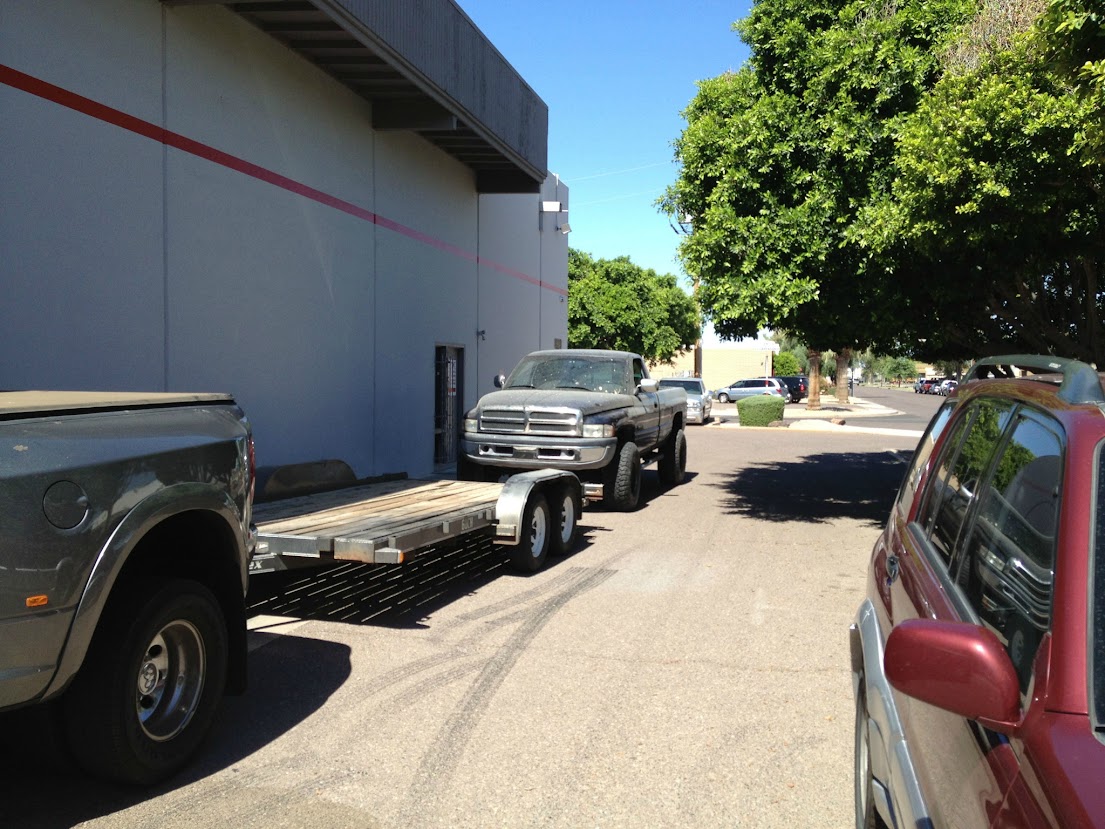

Following in the trailered 1994 Dodge....(no tags, not registered...)
