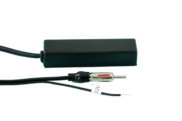

thanks guys. i really didnt want to shave this at first, but another member showed me this cool electric antennae, and for the price....why not! i think its gonna look cool on there, i hope it works as good as it looks.
$69.95 from Dakota Digital

that looks familiar. great work on the patches! keep at it!
there you are. thanks for the antennae idea, it really motivated for me to shave my current one, lol.
