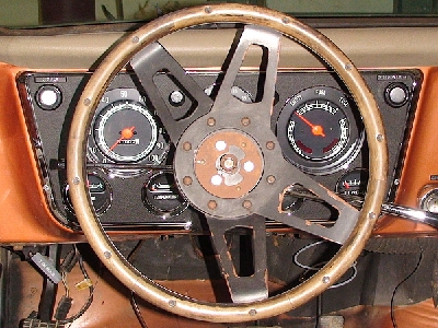

Wooden steeringwheel sand blasted
Cool, you have a steering wheel similar to mine (I don't see them around).
I didn't sandblast mine though, just sanded down the wood.
Any idea what brand/model? I've enjoyed reading your build thread.
I like seeing how it's done overseas. Keep up the good work.

Originally Posted by litew8 View Post
Cool, you have a steering wheel similar to mine (I don't see them around). I didn't sandblast mine though, just sanded down the wood. Any idea what brand/model? I've enjoyed reading your build thread. I like seeing how it's done overseas. Keep up the good work.
I can see the similarity, I'll check if there is any brand on it..I haven't seen anything that cought my eye, but I'll check and thanks for the support!

Old 01-03-2014, 06:47 PM   #22
Steve-W
Join Date: Aug 2010
Location: Hoofddorp, the Netherlands
Posts: 582
Re: 1969 Custom/10 clean up
So back from the holiday's, hope y'all had great days with family and friends.
Poland had no snow, so no white xmas this year but driving back from Wroclaw to Berlin the roads where empty, so I could do 450 miles in just under 5 hours. (yes indeed almost a 100MPH average, thanks to lack of police in Poland and no speedlimit on the German Interstate)
went to work on the truck yesterday and didn't feel like attacking the wiring, so I decided to change the ignition lock cylinder.
I discovered that the previous owner had bought new door and ignition locks going through a box with miscelanious parts.
having no idea how to change it I turned to google and ended up at this great movie on Youtube:you gotta love youtube!
didn't get much more done, my mate was there working on his '69 Charger, so it was all talk and no show
Steve-W is offline   Reply With Quote
Old 01-11-2014, 04:44 PM   #23
Steve-W
Join Date: Aug 2010
Posts: 582
I have another thread going only for the wiring stuff: http://67-72chevytrucks.com/vboard/s...82#post6465482
and as I describe there, we got the wiring figured out! I didn't get everything hooked up yet, but atleast I now know where everything should go.
(I couldn't figure out the ignition switch and gauge cluster wiring)
hopefully I'll have some time tomorrow to get is mocked up and see if everything works, the I'll cust the wires to length and tidy them up.
and then...I'll still have plenty to do
