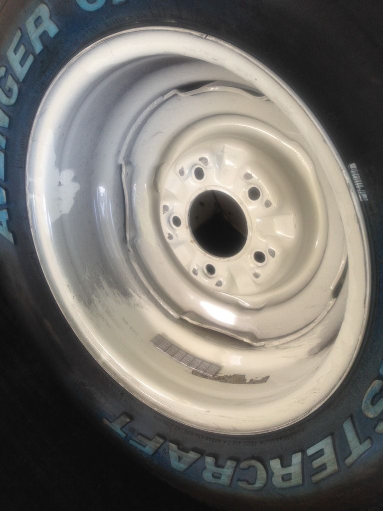

Cool thanks. Just picked up my front wheels and tires from having them re-balanced. I think the guy that did them the first time maybe had a few puffs before. They were quite a bit off.
