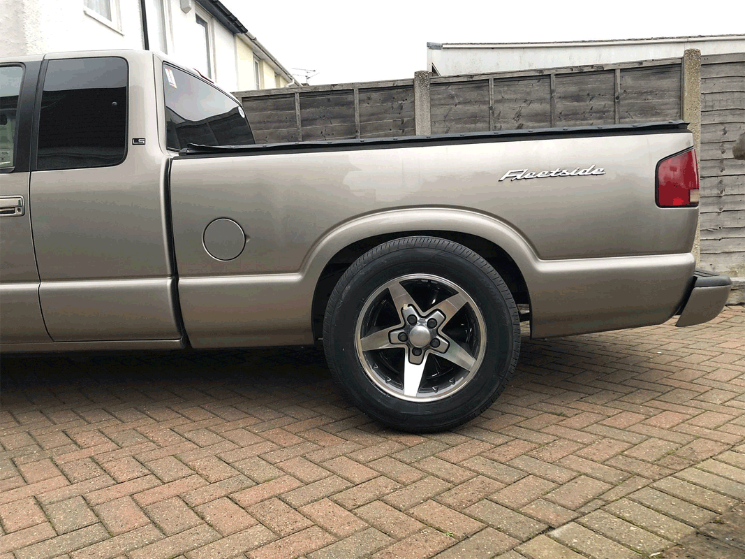

Anyone interested in what greeted me at Kerbed Wheels when I got there at 3.00 this afternoon ??
I have never spent this much money on wheels and tyres in my life and this will actually turn at £900.00 or $1260.00 ince fitted to the truck.
The way I justify it was to say the truck is in such good condition that it deserves to be treated well.
When I got there, there was also proof that they strip more than just wheels.
Vespa scooter frame.
Then on to the wheels.
Mind blown.
STARTING WITH THIS
Dark Anthracite and silver.
And with my not so sexy centre cap fitted.
I really do live these wheels and and so pleased I did nor do this myself.
Enough??

07.00 this morning I was out there, the night had been long, waiting to get up and test fit.
Couple of things became apparent, brakes have not worked for a while, pushing and pulling the truck around on the driveway.
Also, top and bottom control arms need to be serviced and greased, just like my 1966 C10 grease nipples everywhere.
And the turning circle may be impaired by wheels that are too wide, compared to OEM fitment rubber.
Then, on to the front and rear hubs.
Fronts now show why we have those huge Mexican hats as centre caps.
Needs around 60-70mm tall caps/cups up front, there is also space for a spigot ring, or for the cups to become captive from behind.
Maybe a spigot ring is not needed, but the wheel is sitting nice and loose.
Rears fit tight enough that it needed to be whacked to remove after the test fit.
So some flat cap will work here.
The truck also came with locking wheel nuts, something I dislike intensely, and I did not get the socket that unlocks it when I bought it.
Thankfully I managed to get both loose, one was quite loose, possibly finger tight.
So getting decent new nuts makes sense

I am still in two minds, there are a few options at this point.
@forddan68 and @freshandminty are possibly along with a few others the guys to ask about this.......
Wheel protection.
One of my friends, Paul, off a bike forum suggested I consider protecting the wheels with the following product.
And Henry @rider51 suggested ceramic coating.
Now in my wildest dreams I never thought there was a way to protect the protection on the wheels, but there is a learning in every day.
What is the consensus here please
I was looking at some really manky wheels in Romford, supposedly from a Cobra (Replica?) that were Ex Jaguar to possibly run as winter wheels.
Seller reckons the tyres are good, I am not convinced.
I showed him the rears on the truck, even the central moulding stripe has not been run off, Nankangs, and yet, in my book, only good for destruction.
These do look pretty rubbish for £50.00 but could they be a chance worth taking @rider51 ?
Imagine them blasted, painted with Hammerite or some bronze type colour, winter wheels.
And finally, pics taken this morning.
These were removed again after the photoshoot, done for the pleasure of those of you who do take the time to write, click respond, share knowledge.
And the rear view.
Really happy so far.
Once I figure the wheel nuts, centre caps etc, we should be in business.
