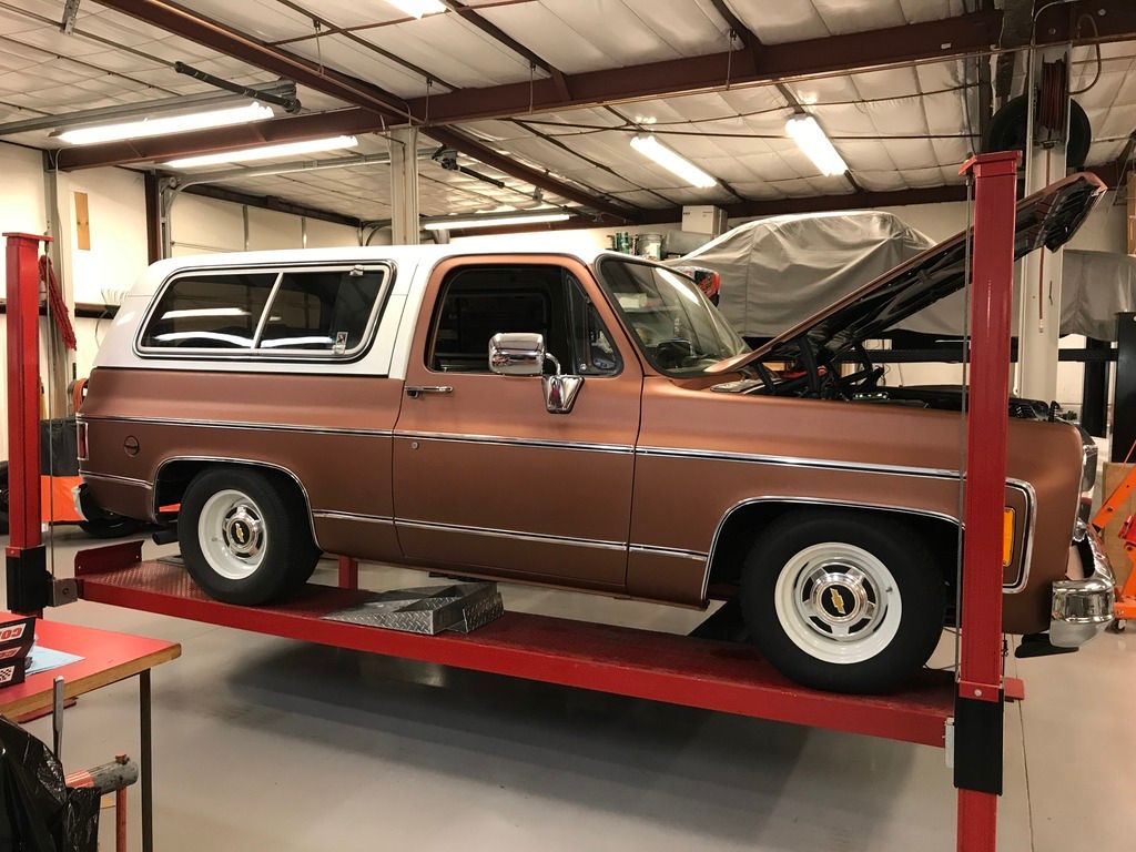

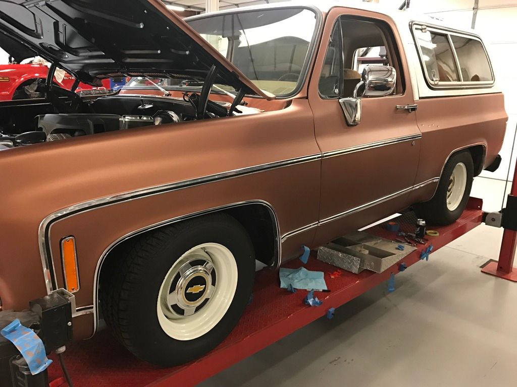

I know I'm slow as I really only get to work about 12 hours a week on the Blazer, but man, installing this trim is taking WAY longer than I expected!!
I also learned that the 2-sided tape that ships with the trim from LMC is absolute junk. Even using adhesion promoter the side pieces were still falling off. I went to Home Depot and grabbed some 3M Extreme Bond tape and so far so good! Worst part is getting the old tape off of the clips on the trim. I've been using a razor blade and adhesive remover to get them off but it's a slow process.
Here is where I'm at after about 5 hours of work so far... I'd say the only thing saving my back is our 4 post lift! Being able to set the truck at a height you can drill and work standing straight up is a life saver!!

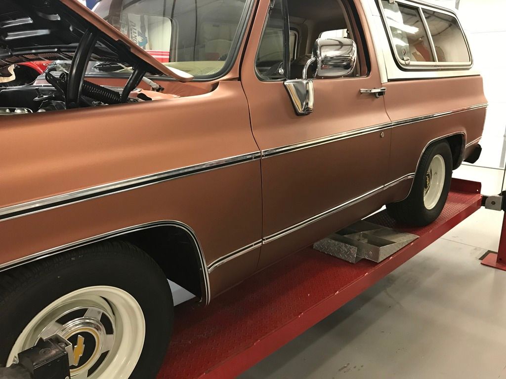

Moved on to the driver's side. Definitely going quicker on this side!
Also spent some time really dialing in the up and down alignment on the tailgate. It was working just fine and the window fit great, however, the passenger side was up about 3/16" higher than it should of been. Really just fine tuning everything at this point in prep for installing the rear tailgate trim.

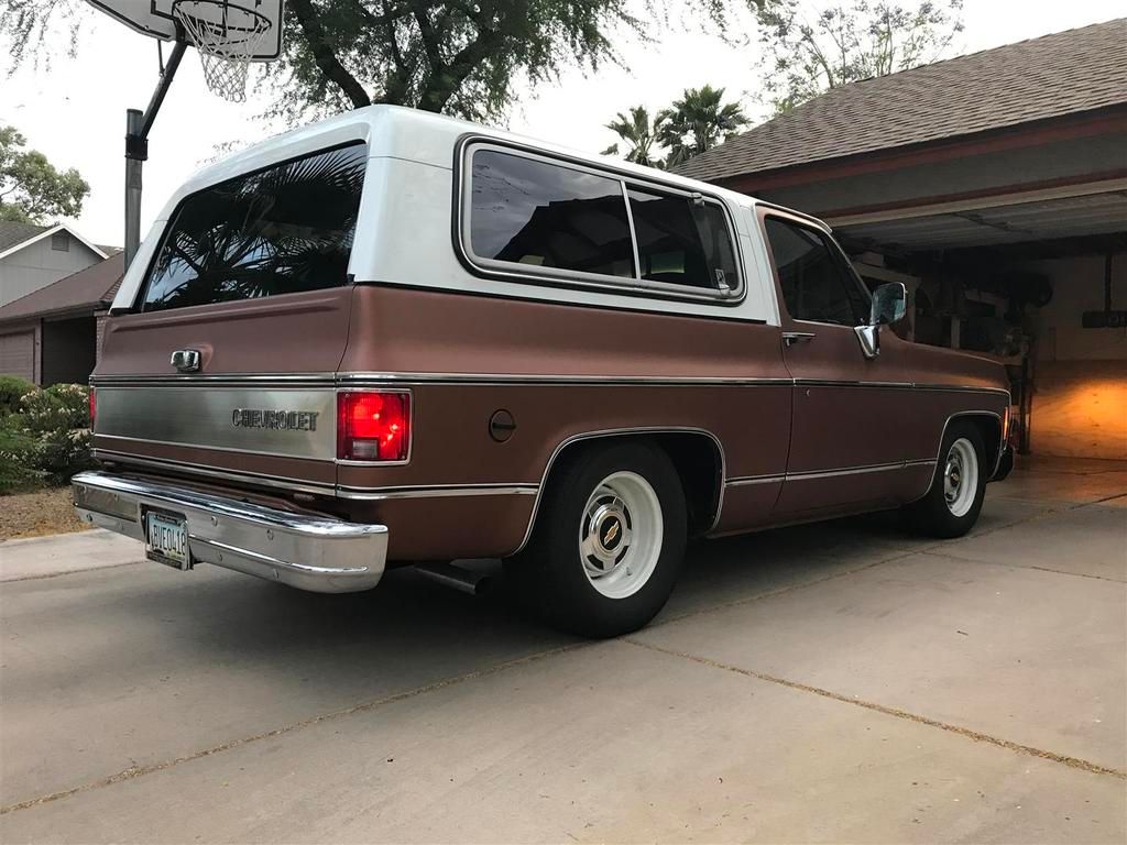

Well I'm sure everyone is probably pretty bored of seeing trim installation pictures so here is the final one! We were able to get the rear tailgate pieces installed yesterday. This finally completes that project. Took me 3 like freakin weeks to get them all on but it's a much larger job than i even initially anticipated. That's for sure.

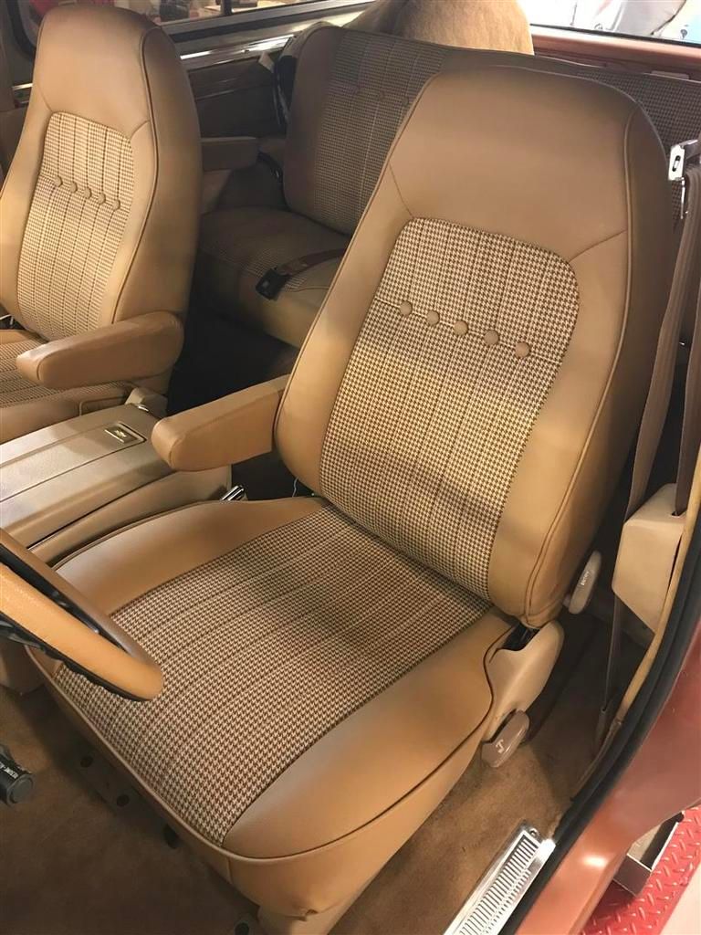

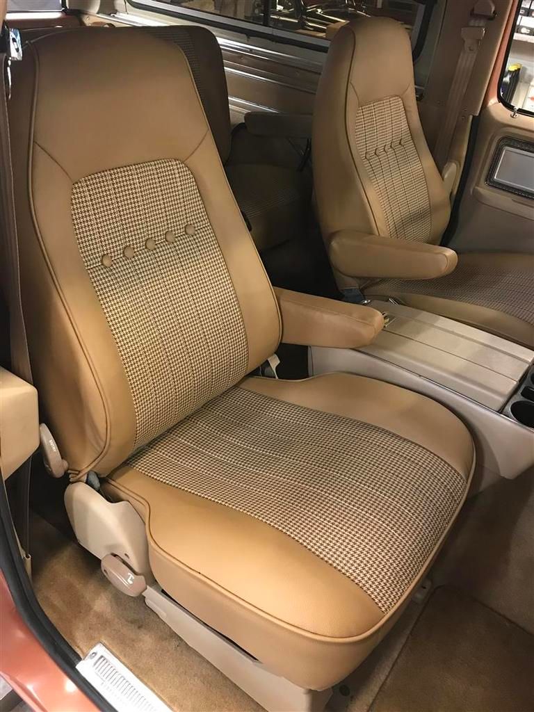

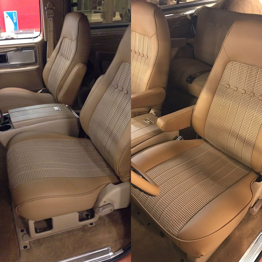

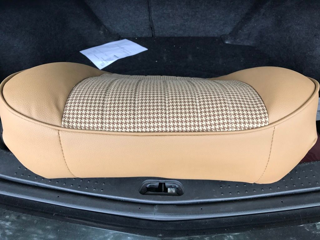

After that we moved on and got the front seats reassembled. That's not a tough job but it definitely takes 2 people to make it manageable.. Really happy with the change. I know it's subtle, in fact most people wouldn't have noticed but when sitting in them you now have a supportive feeling on your thighs and it's not like your sitting on a flat bench anymore. Here is a little before and after side by side as well.

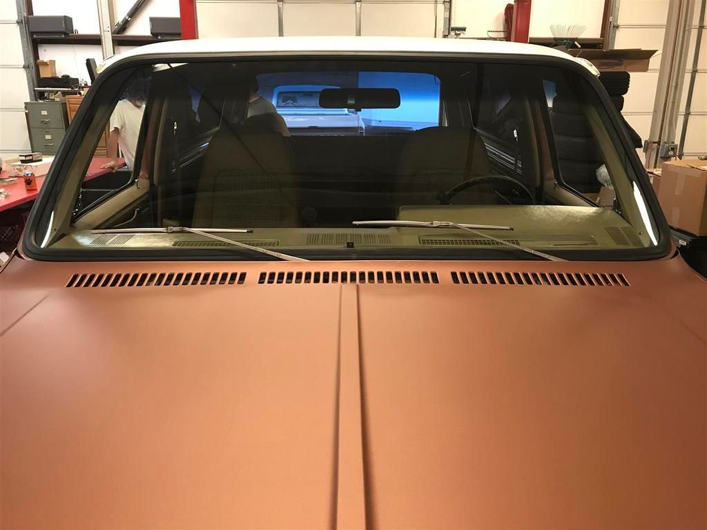

After that we moved on and got the original style wiper blades installed. I can't tell you how much having aftermarket black blades on there upset my soul. It just looked so wrong. I need to get the drivers side arm dropped down one notch but you can see the change.

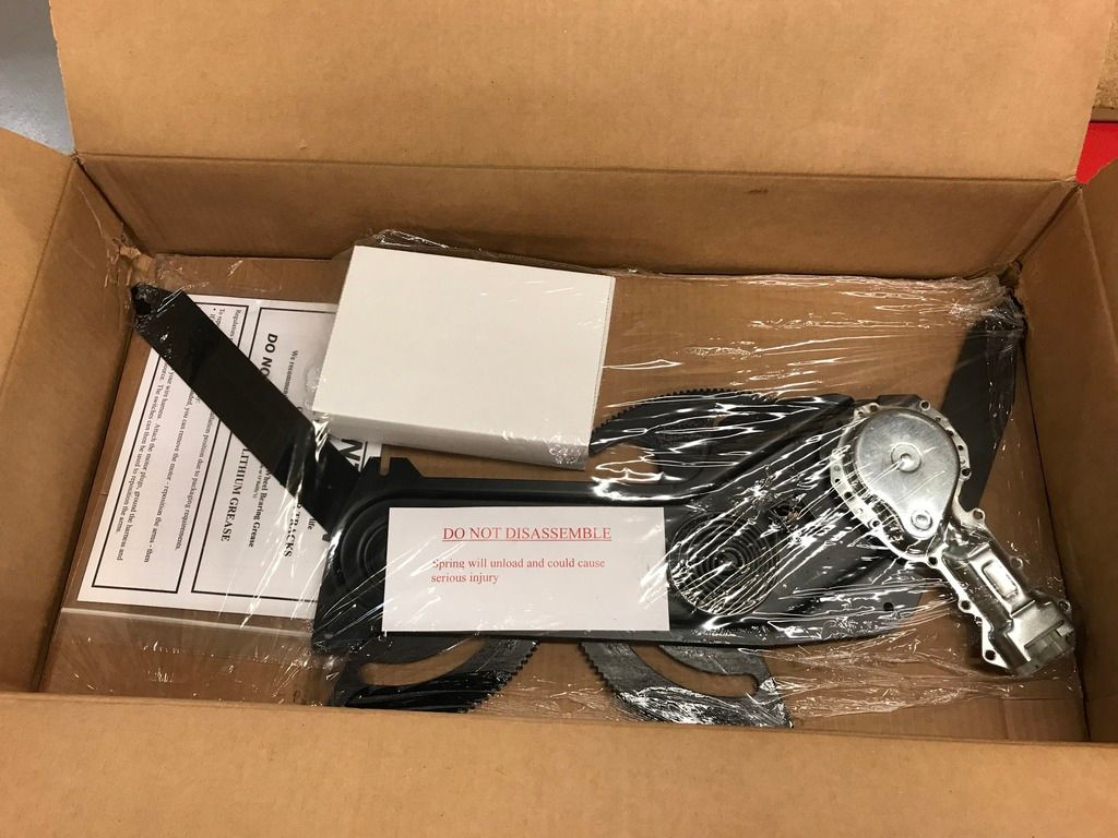

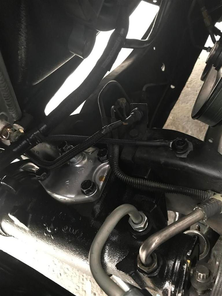

After only driving the Blazer a few times really, and I've already come to realize that rolling down the back window manually sucks. If you've got something in your hand it's made even worse as you fling that handle around and around only after awkwardly fumbling to get the thing unlocked if you've done so.. After reading nothing but horror stories about 40 year old motor/cable/transmissions not working right I decided to give the guys at Nu-Relics a call. Dusty there was super nice. He explained that while they are unable to provide a all new solution, if I sent him a power regulator he would modify it with a reliable motor on regulator design he's come up with over the years.
What I got back is nothing short of awesome! They hot dipped and stripped my regulator, replaced the original transmission with a new welded on adapter ring and then mounted the new style motor right to the regulator. After that they cleaned and even painted it as well as replaced both rollers for me. It wasn't inexpensive by any means but it was the do it once and hopefully not worry about it again solution!
Here are a couple pics of it when I opened up the box last night..
Wish I would have taken a before picture but I didn't. Just imagine a nasty grimy piece that you definitely didn't want to handle without gloves on. It had broken rollers and a broken cable transmission. Now I've got this bad boy! Really looking forward to getting the harness run and wiring it up.
Definitely wire up a switch for the dash. It's like heaven.
Most definitely will be doing that! However because I don't feel like cutting a square hole in my freshly painted dash I'll be mounting a toggle underneath in the driver's side so I can easily reach it when standing outside the truck as well.

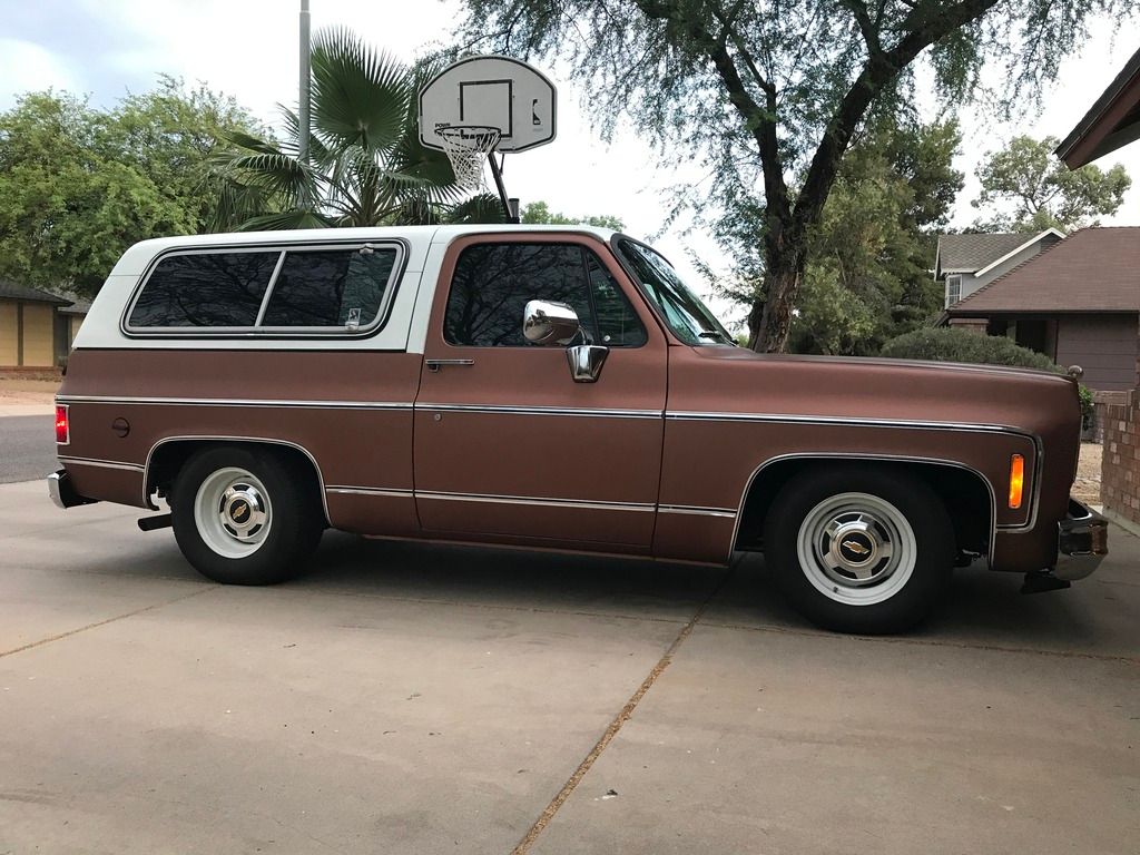

Well this is it guys! Finally drove the Blazer home over the weekend. First time since taking it to Vegas back in November. It's been a lot of work to make the necessary changes and though it doesn't look much different other than the moulding on the outside this thing is flat out awesome around town as well as on the highway now. The new CPP lower control arms couples with the new Lee Engineering built steering gear is just awesome. It handles great and the feel in the wheel is just like a new truck. Seats are amazing and sit up nice in the vehicle, plus the new Vintage Air was blowing 36* out of the vents with enough volume that you could easily feel it in the back seat with the deflectors positioned straight and angled up for best reach. I haven't begun to tackle the rear power window kit but of course when I do I will post that up.

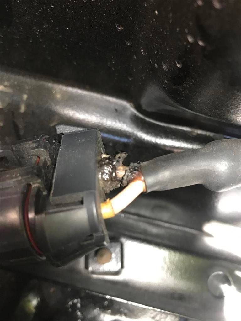

Had a weird thing happen last night. I say it's weird because before tearing it apart we had driven this to Vegas and back so really thought all was well in this department.
Yesterday I was making some changes to the transmission tune and noticed the A/C got warm, then I heard the safety switch cutting the compressor off. Hopped out there and noticed the fans we'rent on. Checked the fuse real quick and all was fine there. Reached down and moved the harness around for the fans and saw it spark and smoke some as they came on!
Got lucky that it was only a high in the 80s yesterday so I decided to unplug them and make the 25 mile drive back to our shop after work. Made it about 90% there before having to pull over and open the hood for a few minutes. After that I only had to shut it off at 1 stop light and then made it in. Which was suprising as it's like 20 stop lights along the route. Figured out that the ground wire had somehow built up a bunch of resistance and completely melted the Metri Pack 630 housing and melted the wire jacket right off of it. Ended up redoing the grounding strategy and should be good to go now.

Here is what I did with the ground circuit. I pulled it back out of the harness and went straight to the chassis. We got a little out of hand with the paint stripping so I need to touch that back up, however that's just an update to how I reworked it.
