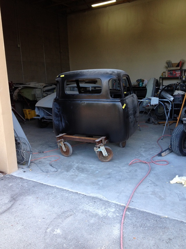

After trailering the disassembled truck to Phoenix, I took all the sheet metal to a local blaster that did a lot of work for car restoration projects to do as little damage as possible to the steel. I tried having the doors and running boards chemically dipped, but didn’t like the idea of residual chemical in the seams and corners, and had the dipped parts blasted too. Here's the cab in Southern Poly epoxy primer just after blasting-
http://talk.classicparts.com/media/s...poly.6666/full
The results of the blasting showed just what condition the cab and doors were in. The bottoms of the door pillars were rusted out, the drivers and passenger side floor was pretty much gone and one of the cab corners needed replacing. There were holes in the bottom of the doors on the inside panel. Previous owners had punched holes in various places in the cab, including what must have been an antenna in the roof and a big hole in the dash where they’d shoved a tach or something into. I like to do paint and bodywork, but this truck was going to take a lot of time. I still work full time and was remodeling/selling my house, so I decided that I’d hire the metal work done, or this project was going to take a long time to finish.

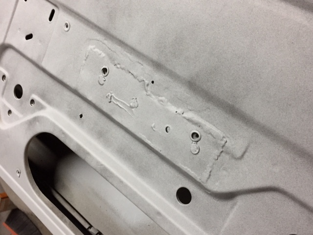

The dents, welds, and imperfections were bumped out with a hammer and dolly and the metal finished to a degree where it didn’t require any filler, only Feather-fill high build primer.
There were a couple of areas that required a skim coat of bondo to level the surface, but only sparingly.

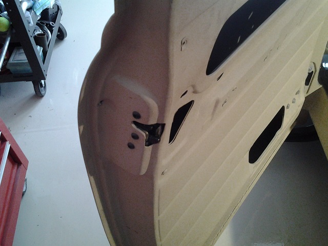

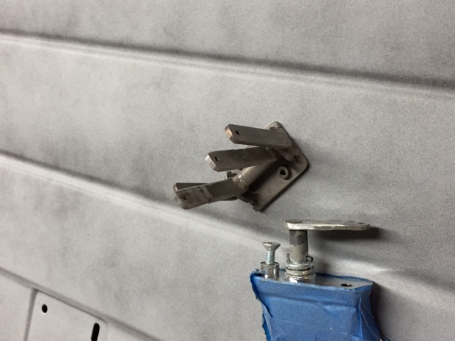

I rebuilt the door hinges, but had heard too many stories about doors popping open using the original latch and striker plate. After showing Wyatt the Altman bear claw latches for the AD trucks, he said that he could make it a lot more pleasing to look at with a custom bear claw latch. Here’s how it ended up-
http://talk.classicparts.com/media/bear-claw.6665/full
http://talk.classicparts.com/media/b...ilar.6664/full
The stock door handle no longer engaged the lock mechanism so I had to fabricate some linkage to get from the door handle, around the glass channel and into the new bear claw.
http://talk.classicparts.com/media/linkage.6641/full

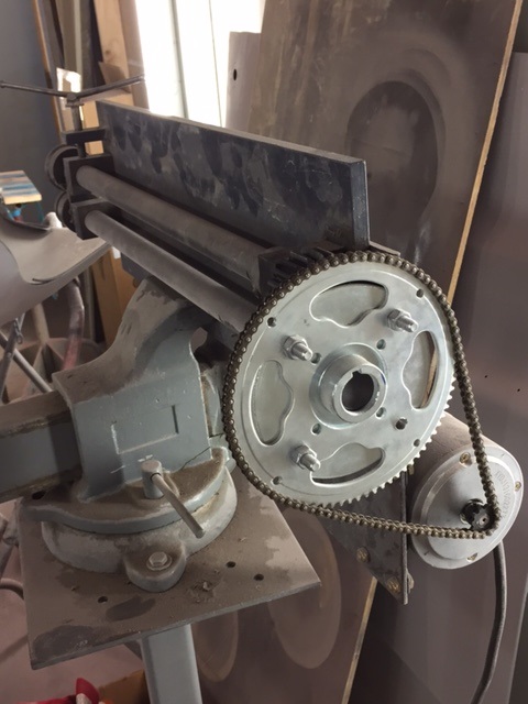

I got sidetracked for a while figuring out how to motorize my bead roller so I could make my aluminum door cards by myself. Here’s a foto of it – it has a 40 amp 12VDC electric scooter motor with a 8:1 speed reduction through some sprockets that use a #25 chain. A 20 amp LED power supply is modulated with a PWM to vary the roller’s speed with a potentiometer. A junk guitar Cry Baby foot pedal houses the pot that allows me to use both hands to guide the metal through the dies and control the speed with my foot. So far I’ve not used it.
http://talk.classicparts.com/media/b...ller.6642/full

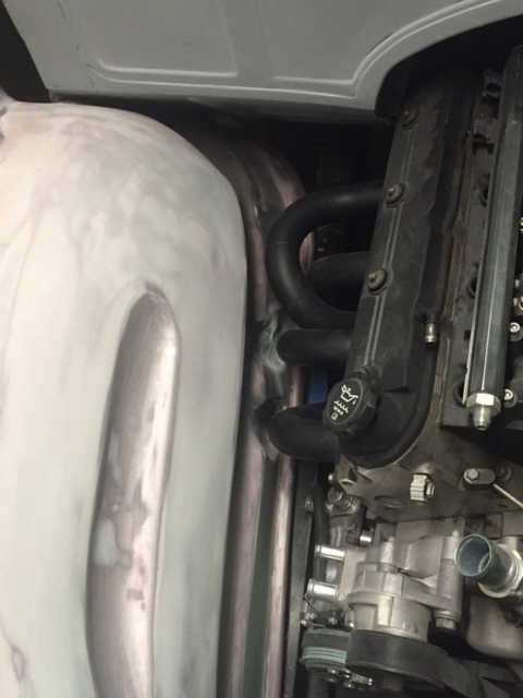

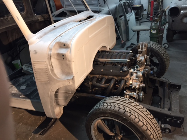

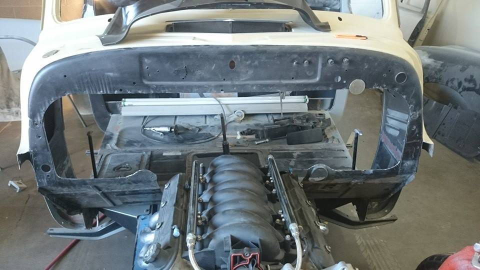

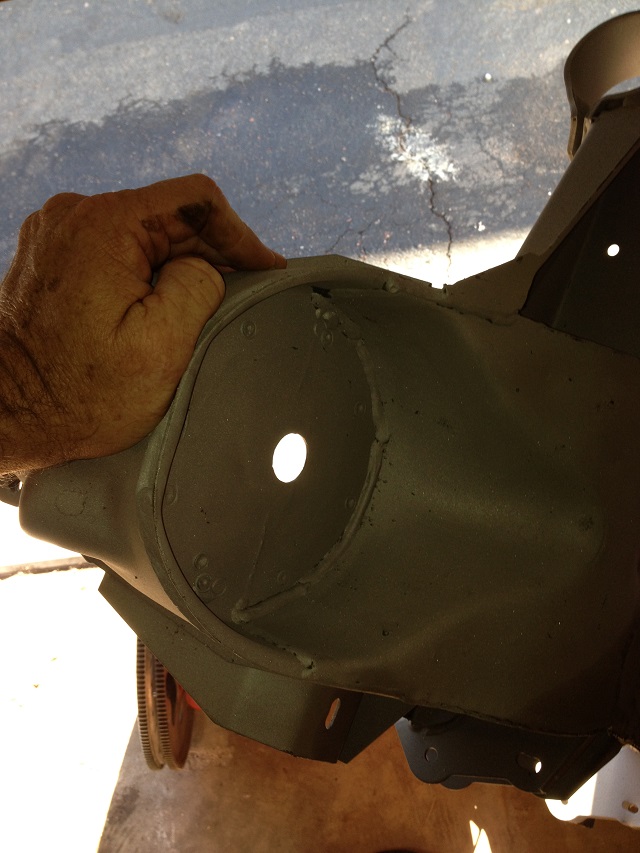

I wanted to move the LS engine as far back as I could in the engine bay, and Wyatt suggested that while he was replacing the floors, we should think about a custom firewall that would let the engine come back another couple of inches. The labor to build a new firewall wasn’t all that much more than fixing all holes in the old one and smoothing it out. I wanted a finished firewall with nothing on it so he drilled all spot welds out of the inner panel and made a new one from sheet stock using a bead roller to mimic the old factory panel, but with an indent for a V8 instead of an inline 6. To get to the bolts on the bell housing to allow changing the clutch without pulling the motor and accommodate a modern manual transmission, Wyatt made a removable cover for the inside of the cab – one for the trans and the other for the bell
housing. My plan is to put the ECU in the cab and I’ll run the wires through the top access cover and mount the ECU under the dash. Borrowed a dummy Vintage Air evap housing/blower to make sure it would still fit after the firewall modification – it did.
http://talk.classicparts.com/media/f...sing.6644/full
http://talk.classicparts.com/media/f...mock.6645/full
http://talk.classicparts.com/media/n...nnel.6667/full
This is the mockup phase with the engine installed. The engine pushed back like this gives me room to run cheap truck accessories
Here’s the nearly finished V8 firewall.
http://talk.classicparts.com/media/firewall.6646/full

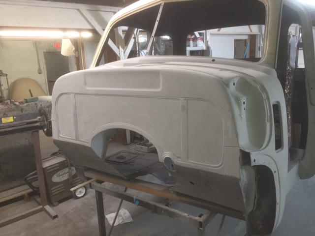

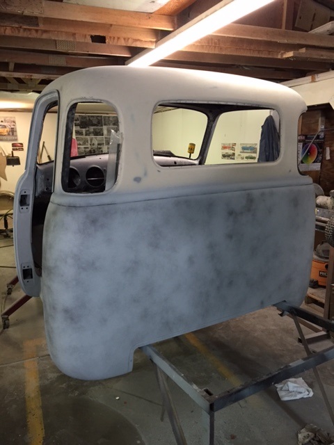

Currently, the cab is nearing completion.The bottom half is in urethane primer and I’m doing the final block-out with 400 grit (adult supervision from Wyatt)
http://talk.classicparts.com/media/rear-cab.6647/full

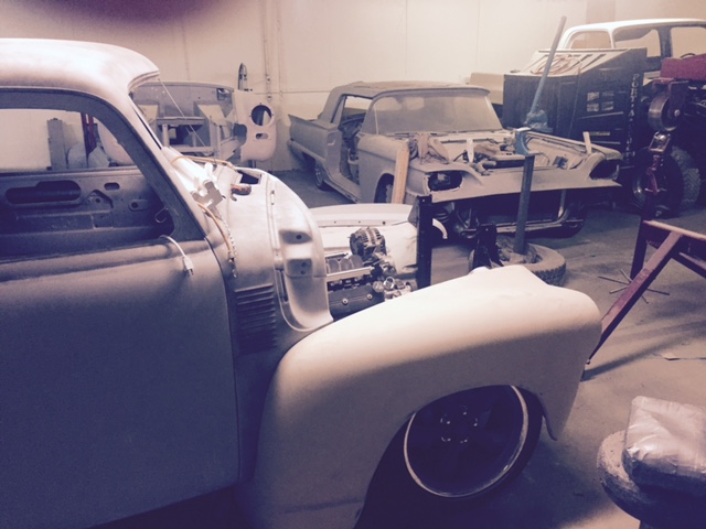

came out of the box, but when I started blocking them out, they had a lot of ripples and dents. Wyatt filled all the extra holes with weld and I skinned them with bondo to smooth them out.
Here they are waiting for a coat of feather-fill to block them out again for primer. Planning on painting them body color
http://talk.classicparts.com/media/i...ders.6648/full
The truck came without a bed or rear fenders when I bought it. Joe (Mother Trucker) in Tucson had a nice set of rear fenders and I bought them from him. A trial fit of the fenders with the wheels I wanted to use showed the fenders wouldn’t accommodate the width of the wheel, so I had to either widen the fenders, narrow the rear end or install tubs. Since I wanted to keep the stock appearance as much as possible, I nixed widening the fenders in favor of mini tubs and narrowing the Jag IRS. I sliced some trailer fenders in half and tig’d on a skirt and Wyatt fabed some L-section on a stretcher/shrinker so the mini-tubs could be spot welded to the new MarK bed sides. Wyatt put a flange on the tubs so they would fit tight to the bed wood for a factory look.
http://talk.classicparts.com/media/new-bed-1.6650/full
Here’s what the truck looked like at the first mock-up of the body panels after the metal work was done and in Feather-fill
http://talk.classicparts.com/media/mockup-too.6649/full
With the bed on the chassis at home-
http://talk.classicparts.com/media/b...-too.6668/full
I jumped the gun a little bit and had Wyatt paint the rear fenders when he had some slack time at his shop. He’s since stopped painting top coats at his shop to focus on just metalwork.
Here’s the fenders sitting in my living room at home. The color is a sage green from the latest Fiat 500s, of all things – it’s the first color that my wife and I could agree on.
http://talk.classicparts.com/media/p...nder.6561/full
I’m shooting for a final fit of the chassis to the cab/fenders/hood at Wyatt’s shop in the next month. He’s already shut down his paint booth, so Rob at Drew Brothers Customs in Chandler has agreed to do the work. The truck with cab, fenders, hood grill will be trailered to his shop, disassembled, painted, then reassembled and back on the chassis. I’ll put the bed and rear
fenders on at home.

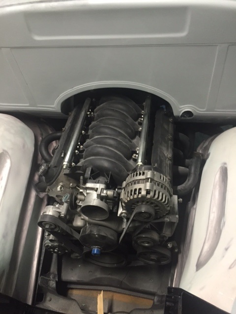

I shopped Craigslist and the local junkyards for a 5.3 truck motor, and finally found an aluminum 5.3 with 95K miles out of a Trailblazer for $650 at a local junkyard. The truck accessories and a wiring harness and ECU from a drive by cable throttle from a Suburban set me back another $100.
I cleaned it up and installed a Corvette intake and shaved the valve covers of the coil mount bosses – I plan to remote mount the coil packs to clean up the engine bay – still haven’t figured out exactly how I’m going to do this.
http://talk.classicparts.com/media/l...vers.6442/full

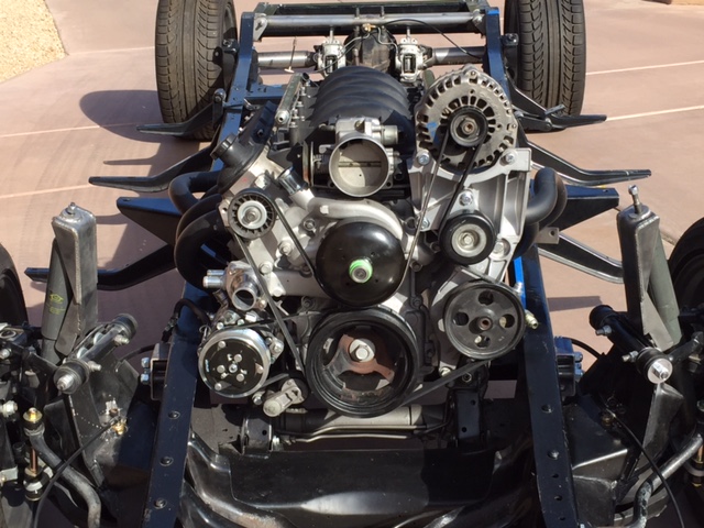

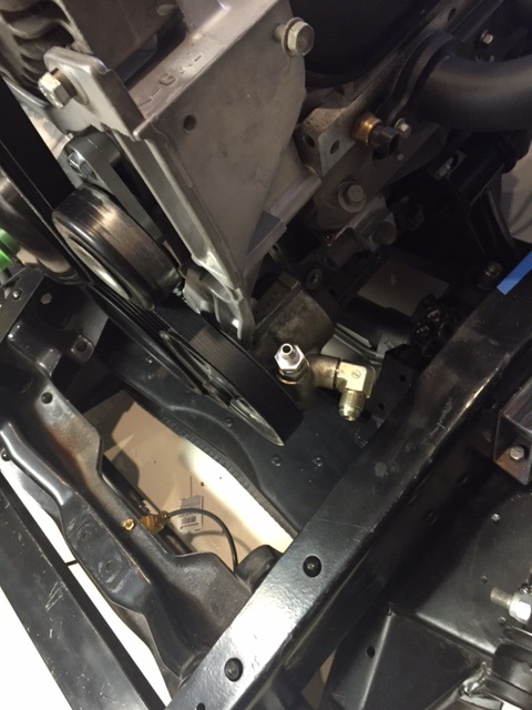

Without buying an expensive aftermarket accessory drive, I didn’t see how anything but the truck accessory layout would work in the ’49. All the truck accessories cleared in the mockup stage, but since the truck pulley and accessories protrude more than the f-body or Corvette, I moved the engine further back into the firewall to give more room up from for the accessories and cooling fans. This also gave me a little more room for headers and a low mount ac compressor by taking advantage of the taper in the frame rails. This is the near-final accessory drive I’m using-
http://talk.classicparts.com/media/a...rive.6652/full
The Corvette intake positions the throttle body such that he throttle lever hits the water neck of the truck pump. I tried heating the truck’s stainless water neck to see if I could move it in the housing, but gave up when it looked like all I was going to do was crush it. A water pump from a 2009 Trailblazer solved the problem with a different location of the discharge tube.
After I put on the Corvette intake with the Suburban throttle body, the belt routing for the accessory drive hit the throttle body. A cheap idler relocation bracket from ebay fixed that problem. (If you’re really paying attention, you might notice the belt routing is incorrect in this photo)
I know this sounds ridiculous, but the plastic power steering reservoir mounted on the pump looks entirely too modern for the engine bay. I took it off and put on a AN-8 fitting on the suction side of the power steering pump so I could fit a remote reservoir. For other projects, I’ve made reservoirs out of two round halves of aluminum AC driers welded together, so that’s what I’ll do for this truck too.
http://talk.classicparts.com/media/ps-fitting.6655/full

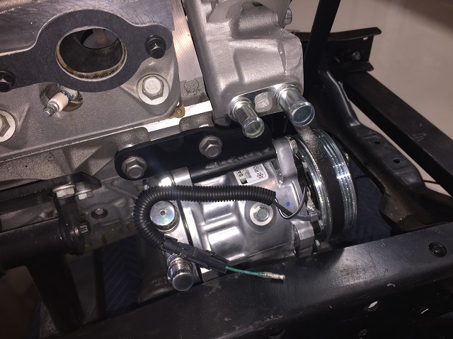

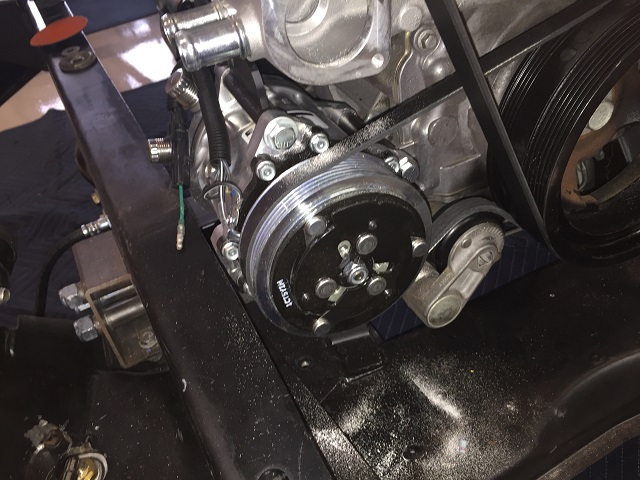

I was too cheap to spring for the $175 air conditioner bracket that Alan Grove sells so I fabricated my own. I had to shave two of the ears off the Sanborn compressor to get it to clear the frame rails, but it does clear.
http://talk.classicparts.com/media/sanden-2.6669/full
I used the truck belt tensioner on my bracket.
http://talk.classicparts.com/media/sanden.6670/full

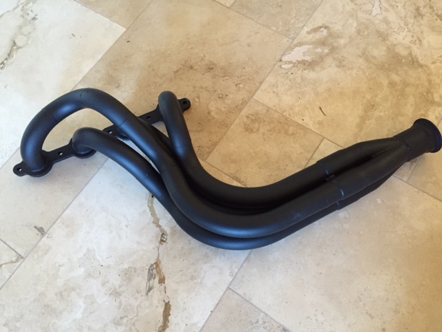

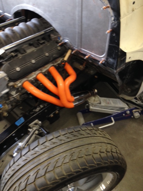

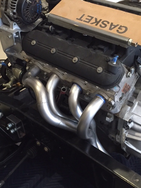

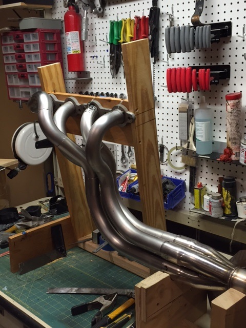

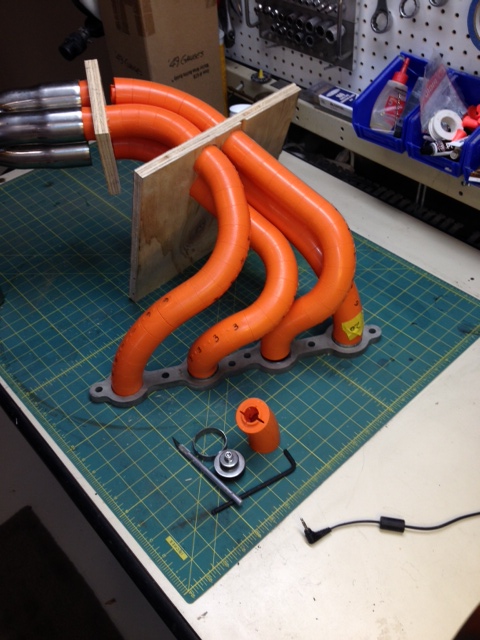

Headers were my biggest challenge. I’d used Corvette sheet-metal headers on my LS Jag conversion but I couldn’t make them clear both the motor mount and the steering rack on the driver side on the truck. I didn’t want cast manifolds either. Pacesetter is here in Phoenix and makes long tube headers and shortys for the LS motors and I went there and bought a pair of shorty Camaro headers. They fit, but the collector interfered with the stock pedal arm (wanted the original pedal setup for the nostalgic look) so I took them back.
The Pacesetter sales manager offered to let me try a pair of Camaro long tubes – they fit too but the collector on the driver’s side hit the brake booster bracket on the chassis. Back again, and he gave me some GTO headers to try, but the collector was wrong and wouldn’t fit. With any of these solutions, I’d need to snake the steering shaft around with a lot of u-joints too. Too many compromises.
I’d built headers before for turbo systems, aircraft and sand rails, but nothing with as many constraints as the LS motor in an old GMC truck with narrow frame rails, an archaic pedal setup and a Jaguar rack and pinion, but decided to give it a shot.

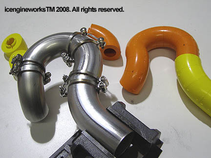

I started with some stainless flanges, cheap ebay merge collectors and a header ‘lego’ kit from ICEngineworks in Texas. With the engine and the front suspension in the truck for mock-up I tried numerous configurations to get the primary lengths to be all around 28 or so inches and have a single steering shaft to the rack from the column with just two u joints. Here’s one of my first attempts with a design that would have gone through the inner fender well-
http://talk.classicparts.com/media/h...type.6654/full
And another configuration in legos on the bench-
http://talk.classicparts.com/media/h...k-up.6653/full

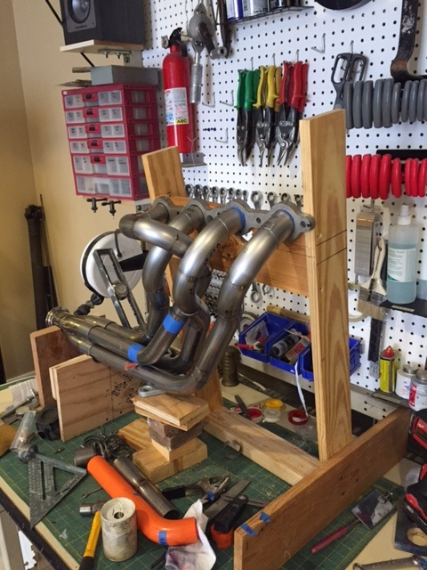

I got tired of getting up and down from the floor to trial fit header tubes in the truck, so when I got a configuration that was close, I built a wooden fixture on my workbench to do the final fit from the comfort of a chair. Once I got the legos to all fit, I transferred the dimensions onto 304 stainless mandrel bends, cut them on my Portaband mounted in my Swag base and then sanded them on a belt sander to get a perfect fit for welding with the TIG.
http://talk.classicparts.com/media/pax-header.6587/full
http://talk.classicparts.com/media/h...ture.6581/full
I had a hell of a time getting the tubes to fit together for tacking. Mandrel tube isn’t perfectly round, and when you mate a straight section to a cut through a curved section, the fit-up of the tubes is always a ‘best fit’ compromise. I bit the bullet for these clamps and it helped immensely.
http://talk.classicparts.com/media/t...ssy1.6661/full

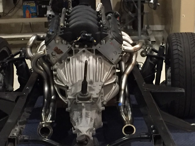

Here’s the finished driver’s side headers in the chassis – tacked but not welded – (the small tube in the middle is where the steering shaft goes)
http://talk.classicparts.com/media/h...view.6658/full
I was going to run bare stainless headers and simply glass bead them and polish them up with a Scotch-brite, but when the final welds were done, there was an ‘aw ****’ moment when I realized I’d somehow picked up a piece of mild steel mandrel and used that for one of the bends. Rather than ordering another mandrel bend, cutting it out and welding in the correct stainless one, I was so darned tired of screwing with headers I had them ceramic coated black. They still look good and will last forever, but that mistake was a rookie move.
I had planned on using slip on collectors, but was too cheap to spring for $600 for a pair of good ones from Burns Stainless. The Chinese ones from ebay looked ok, but where the primary tubes slide inside them was a sloppy fit to the headers and I didn’t see how I’d ever get them to seal up, even with a barrel full of red RTV. A local ATV shop has a plasma table and cut these clover-leafs out of 3/16” plate so I could weld the cheap slip-on merge collectors to the header primaries.
http://talk.classicparts.com/media/cloverleaf.6671/full
Added some O2 sensor bungs and they were done.
Here’s a picture of the final headers in the chassis.
http://talk.classicparts.com/media/h...ssis.6672/full
The final coated header- driver’s side
http://talk.classicparts.com/media/b...ader.6602/full

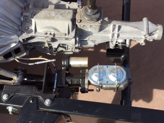

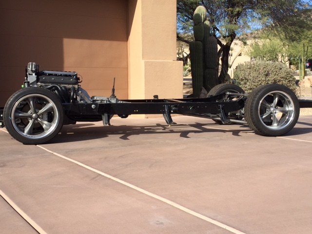

The transmission is a T5 from a 1980s V8 Camaro with a S10 tail-shaft support to move the shifter to a more forward location for a truck. This transmission is rated a 300 ft-lbs and is probably not the optimum choice for the LS motor’s torque and horsepower. But there’s some method in my madness. I’m old and just want to put-put around – my clutch side-stepping stoplight launches are far behind me. The clutch, hydraulic TO and bell housing will work with a T56 or a TKO transmission too, so when I’m ready to change it I won’t have to buy those too. If I don’t trash the T5, I can sell it to someone that wants if for their six cylinder truck - it has much better ratios than the S10 T5s.
The bell housing is a reproduction GM 621 that I got from Kiesler, a Sachs 1050 flywheel for an LS truck and a big block Chevy clutch. The big block clutch on the LS flywheel is a bit of a compromise because the big block’s clutch disk overlaps the LS flywheel area only about 80%. With the torque the 5.3L motor puts out vs the big block, I don’t think it will be a problem.

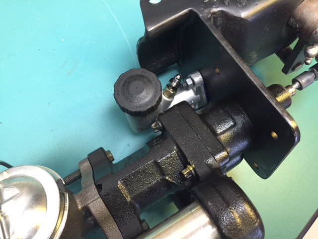

The truck came with a small diameter under cab brake booster, but I had some misgivings on how that was going to work with four wheel disc brakes. I harvested a Hydroboost from an Astrovan at a local junkyard and fab’d the linkage to use with the truck’s pedal setup. For the master, I used a 1.125” diameter Corvette from about 1980.
Here’s a pic of the Hydroboost and master cylinder installed in the chassis- you might notice the Hydroboost is installed upside down, but that’s so the accumulator can clear the clutch master cylinder. The guys on Pirate 4x4 say it doesn’t make any difference and works equally well either way
http://talk.classicparts.com/media/c...ster.6613/full
http://talk.classicparts.com/media/hydroboost.6663/full

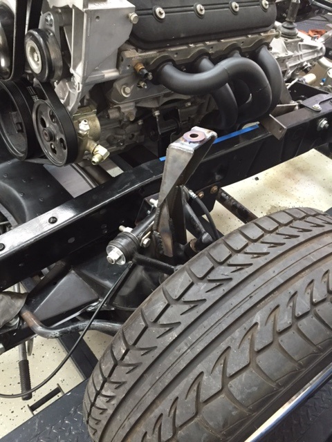

The Suspension
This is where it kinda gets weird and I really start to wander off the AD restorod reservation.

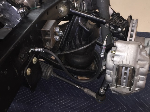

I started this project knowing that the C10 front cross-member it came with was going to be too wide a track for a low truck, and the last thing I wanted was something that was going to ride like a truck anyway. So I sold it on Craigslist and wanted to use the Dakota front end that Industrial Chassis sells. But when I called them, they said it wasn’t currently in production (but it is now I think). I’d recently rebuilt the suspension on my old Jag XJS, and when I was researching truck IFS suspensions, the Jag came up a lot, especially in hotrods in Europe, Australia and New Zealand. It was kinda like the M2 is here. The track width was right, uses a Chevy bolt pattern, has big Girling brakes, they were cheap, I knew how to rebuild them, and they had the additional bonus of being very easy to adapt to use airbags. What’s not to like?
Having rationalized my way into the Jag IFS, I began to wonder if the traditional Jag IRS could work too. The track width seemed right (came to regret this later), lots of Cobra kit cars use them with a fair amount of HP, there a quite a few ratios available, most have positraction, can use Dana 44 carrier/ring/pinion, bolt pattern is good, uses standard ujoints, it is a modular bolt-in unit, and finally, there’s the nostalgic/cool factor.
There are better IRS setups than the Jag, but as a kid growing up in the 60’s and 70’s, I thought hotrods with the Jag rear suspension were the tits. Rationalization complete. Never mind that I could only find a couple of guys that has succeeded in putting one on airbags and you had to drop out the whole rear end to change the rear brake pads on the inboard brakes. How often do you change rear brake pads anyway?
First the front suspension. This is a junkyard Jag IFS
http://talk.classicparts.com/media/j...-ifs.6681/full
The Jag IFS is mounted on rubber isolators, and since I was looking for as posh a ride as I could get, I decided that I’d use those isolators on my truck instead of welding the Jag cross member to the frame rails. Here’s the front bracket that the jag isolator bolts to - the isolator’s bolt location in the bracket set the caster of the front end at about 3.5 degrees-

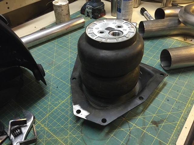

The pan that bolts to the lower Jag control arm was modified to accept the SLAM airbag by cutting out the spring ‘hat’ and welding in a round plate that would be drilled to the airbag’s mount pattern-
http://talk.classicparts.com/media/f...-pan.6677/full
Another view without the bag in the way-
http://talk.classicparts.com/media/f...an-2.6676/full
The Jag suspension doesn’t have its own upper shock mount, so I bought a universal shock tower mount from Suicide Doors and modified it for my truck. It will be welded to the Jag cross member.
http://talk.classicparts.com/media/s...ower.6689/full
Had the steering rack rebuilt at Arizona Rack and Axle, which is very near my work. $150 and a lifetime guarantee. They may come to regret this.
Here’s the complete Jag IFS in the truck with the airbags. Takes about 75 psi to bring it to ride height.
http://talk.classicparts.com/media/f...rbag.6675/full

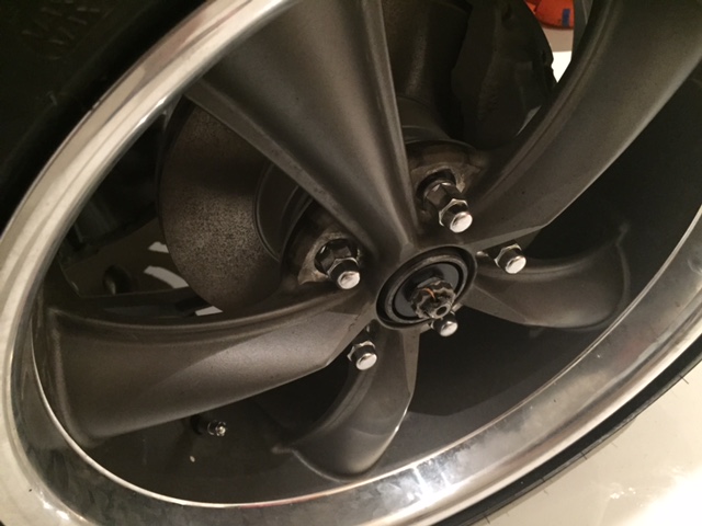

I was a little concerned about how close the front tire was to the fender when the truck was sitting low. I noticed that the mounting flange on the staggered Boss wheels I’m using were much thicker on the narrower front wheel than the rear. I wondered if I could pick up a little extra clearance by having the mounting flange machined on the front wheels to match the thickness of the rear wheels. A local custom wheel store told me that they sometimes do this to fine-tune offset for fender clearance on wide wheels. I found a machine shop here that specializes in machining offsets on wheels in a CNC machine. For $150, they welded the holes closed, machined the back face about .500” to correct the offset and re-machined the bolt pattern on the CNC. Here’s a shot of the final product- it needs to be repainted, but that was a good deal.
http://talk.classicparts.com/media/wheel.6559/full

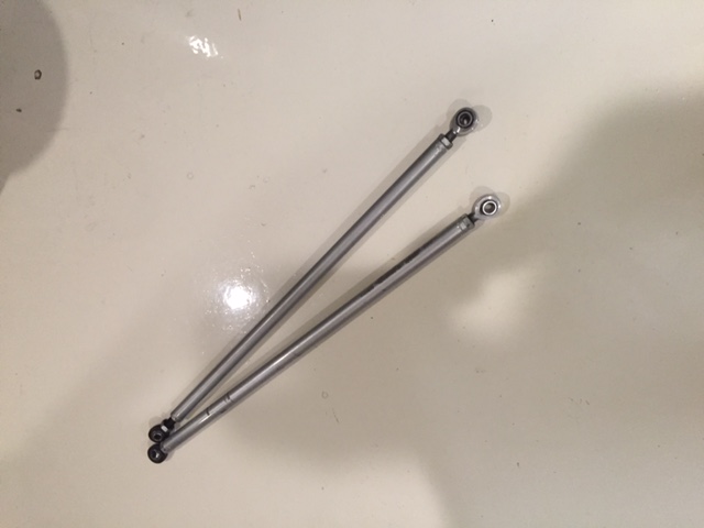

A couple of adjustable rods mounted at the bottom of the diff and connected to the frame will keep engine torque and braking forces from moving the diff and truss too much in the frame as well as keep the diff angle planted to avoid any driveshaft vibration.
http://talk.classicparts.com/media/r...rods.6558/full

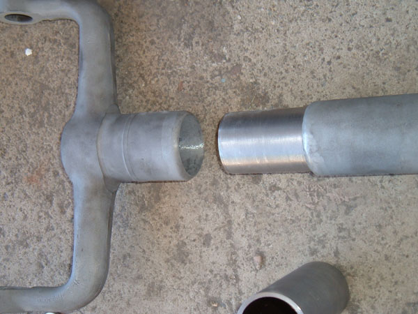

The Jag’s half-shafts are a forged solid shaft, and the idea of cutting that apart, sleeving it, and welding it didn’t seem likely to be successful. They look like this-
http://talk.classicparts.com/media/h...ft-1.6678/full
The XKE driveshaft length would have worked, but they are expensive. Since they are a standard u joint, I could buy Spicer yokes and make them like a Corvette half shaft. Here’s the IRS with the shortened lower control arms and new tube half shafts-
http://www.jalopyjournal.com/forum/m...-1.535611/full

The rear airbag was a bit of a challenge. I suppose I could have used an integrated shock-airbag, but that would put a moment load on the lower control arm and those shockwaves are expensive. What I did was add a trailing arm kind of like a C10 has that moves in the same plane as the lower control arm, so when I put a bag on the arm, there’s no moment load, just a straight force. It uses a 5” slam airbag –
http://talk.classicparts.com/media/r...-too.6685/full

Here’s the chassis ready to go have the MIG welds done next week – this is about normal ride height
http://talk.classicparts.com/media/chassis.6674/full

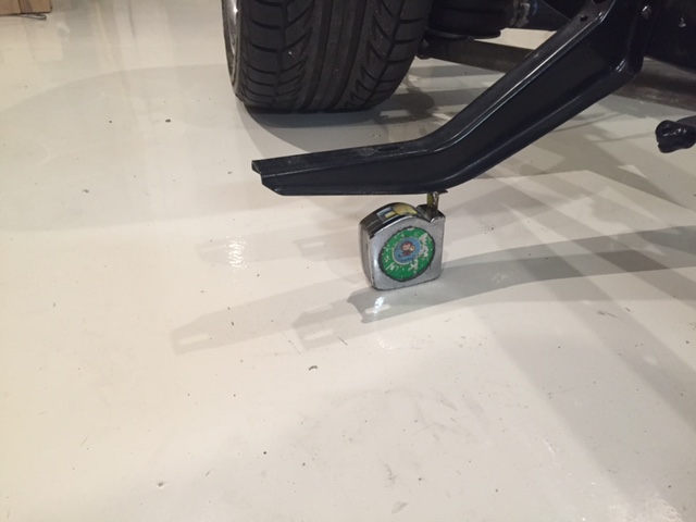

With the bags on the bump stops, here’s the ground clearance. Since I narrowed the IRS, the outboard hub carriers rub against the side of the frame rail now. A little clearancing of the aluminum carrier will allow the truck to drop another inch or so. At this point my truck oil pan will be about 2” off the pavement.
http://talk.classicparts.com/media/aired-out.6673/full
I’m on the fence about how to control the airbag ride height. Manual valves would be pretty simple, but the idea of having all that tube in the cab isn’t appealing. A traditional electrical valve and switch box is a little better but still a little clunky for my taste. I like the idea of the Accuair system, but not the cost. I’m contemplating doing something like this for a set-and-forget type system.
http://talk.classicparts.com/media/slide1.6688/full
Any feedback from any old coots like me with airbag suspensions would be appreciated. Not into the 'aired out' thing, the truck probably will never haul anything more than lawnchairs and a beer cooler so I just want a really cushy ride

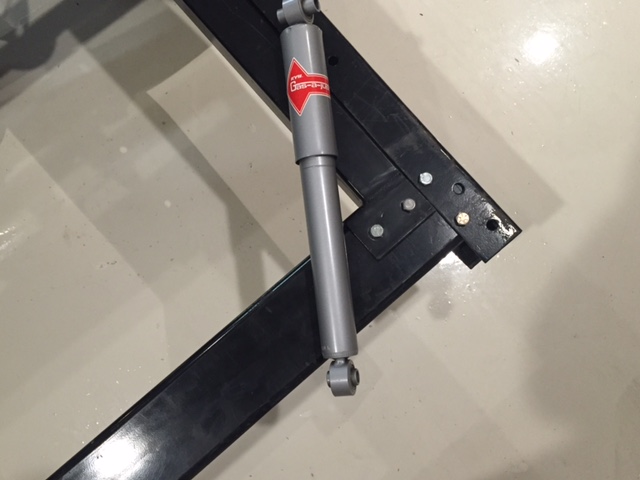

The rear shocks came in. I bought KYB gasadjust shocks with about a 5" stroke.
I'll mount them at about a 30 degree angle. This whole shock-airbag thing is kind of a crap-shoot. All the airbag sites out there seem to be pimping shocks for airbags, but I can't seem to put my finger on just what is different on a airbag shock versus a regular shock.
These are gas charged and were originally designed for a Dodge Durango
http://talk.classicparts.com/media/r...ocks.6692/full

I trailered the chassis back to Wyatt's shop in Mesa and unloaded it there. Next step will be putting the cab on the chassis and doing the final prime and fit of the fenders, hood and doors.
A bit of a aw-sh*t moment when I unloaded it from the trailer and saw that the header collector just kisses the bottom of the hydroboost unit. Looks like I need to tilt the engine down another half degree to get the headers to clear, and it looks like I'll have to wrap about 4" of the collector and fab a heat shield.

there isnt an "airbag shock", just a gas charged shock. if you have really big bags in the back and dont lift it very high you will probably want a monotube high quality shock, because the low pressure big bag will really want to oscillate the shock and a lesser shock will foam. I see you are using 5" slams in direct actuation (not an advantage/lever setup) so those shocks you got will be fine in the sense that they are gas charged.
is 5" stop to stop? that may not be enough, the slam bag lifts about 6 and if you are shooting to lay out you will need a 1/2" on the bottom to allow the truck to lay down without resting on the shock mounts, so that means 4.5" of lift, minus the 30 degrees, so a little under 4" of lift.. and at 4" of lift the shock will be topped out, which will ride like a square wheel. you will probably want a longer shock.
If it were mine, which its not, I would get a shock with about 7-8 inches of travel and set ride height in the meat of that travel so there is travel up and down. Lots of airbag guys can get disappointed in the ride when its really just the shock. On my last bagged truck I used 10.5 travel gas charged shocks from a jeep rubicon. rode like a pillow even a half inch off the ground.
such amazing fab work, thanks for all the great pictures!
e015475 12-22-2016 02:28 PM
Re: 49 GMC Five Window
Great advice - thanks. That's the kind of info I need and the best reason to post a build thread is to tap into the great experience here.
Sized the shock/suspension so that the shock was the droop limit and the airbag was the compressed limit.
A Jag OE coilover shock is only about 3" of travel and I have about 5.5" in these shocks.
At my normal ride height, about a beer can height off the running board, I should be about in the middle of the shock's travel range. Like you said, I realize if I run the suspension up high it will be at the shock's limit and ride like crap.
Will run the ones I've got, but if I have to, I can still build a little tower for the top mount and still clear the bed wood for a longer shock, as you suggest.

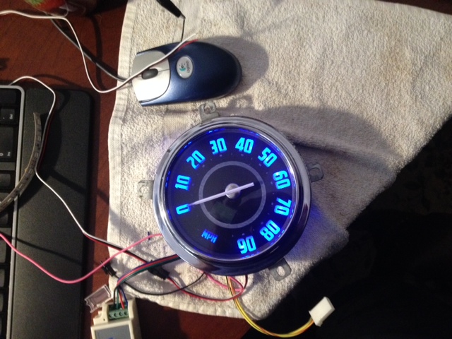

Another science project is the gauges. My transmission doesn't have a mechanical output for the speedometer, so my preference is aftermarket gauges. I had a CAD file made of a new gauge face and then had them laser etched into plastic sign material. I used a Speedhut speedometer and peeled off the gaugeface and needle and installed it in the GM housing.
http://talk.classicparts.com/media/u...eedo.6432/full
Here's the tach and the speedometer together-
http://talk.classicparts.com/media/s...tach.6428/full
I backlit them with a LED RGB and a dimmer. Here's the blue one-
http://talk.classicparts.com/media/b...eedo.6429/full

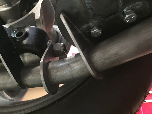

Checking the inner fender clearance to the headers. Needed a little massaging to clear. Everything is dusty in the metal shop - note the paint stick shims on the radiator support.
http://talk.classicparts.com/media/e...ckup.6708/full
Details on the passenger side. Looking for about an inch clearance between the header and the inner fender. Dimples in the inner fender are pretty subtle and made to look like an extension of the factory contours.
http://talk.classicparts.com/media/h...ance.6710/full

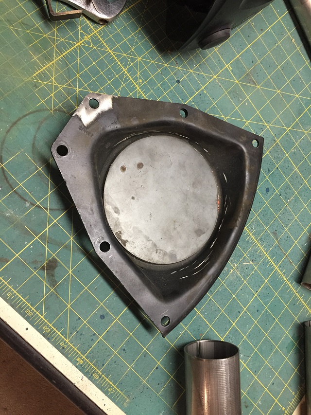

Little planishing and skim coat of filler needed to finish the inner fender bump-outs. Too cold to spray primer this week - maybe it will warm up this weekend.
Will definitely need the rear discharge ports for the Sanborn compressor and to tap the water pump heater lines so I can fit a 90 deg turn downs to clear the inner fender.
Fit up of the front fenders. Very happy with the wheel to fender clearance I got with re-machining the wheel face. Wife is saying she wants to see the truck in steel wheels, whitewalls and GMC hub caps........oh well.
http://talk.classicparts.com/media/f...itup.6711/full
Found a painter who's work I really liked. Trick will be getting the truck out of the metal shop in the condition the painter will accept without wanting to reprime it and block it again. I'm shooting for having it so he'll guide coat it one more time and block it with 600 grit without doing anymore prep. That's the plan anyway.
Back to the grindstone............

Some progress. The to-do list is down to one page. Sitting in urethane primer sanded to 400 grit. GMC grill surround is still in Featherfill and needs more work.
http://talk.classicparts.com/media/r...aint.6738/full
The front sheet metal is all aligned (little adjustment needed on passenger side - I'd started taking the front surround off to work on it when I took the photo)
http://talk.classicparts.com/media/a...done.6737/full
We were afraid that there wasn't enough support for the bear claw pin on the B-pillar so I made a plate out of 304 stainless to spread the load. Surface is brushed and covered with tape to protect it
http://talk.classicparts.com/media/p...x675.6735/full
Needed access to the clutch master and brake master from the cab. Made some floor reinforcement with some scrap sheet metal and the stretcher and plug welded them into the floor pan. Made the covers on the bead roller and fastened them to the floor with a quarter turn Dzus fasteners.
http://talk.classicparts.com/media/c...cess.6736/full

Shop painted the firewall yesterday after moving the body back on the frame and removing the bed. New Iwata gun is producing much better final finish and there's only a couple of dust nibs to deal with in the cut and buff. Here's the firewall at the first coat of base color -
https://talk.classicparts.com/media/...aint.6751/full
The firewall with the final clear coats and un-taped
https://talk.classicparts.com/media/...ique.6750/full
Inner fenders in base coat and waiting for flash off so the clear can be applied
https://talk.classicparts.com/media/...ders.6752/full
The plan is to shop-paint all the interior and undersides of fenders/hood, reassemble and then go to the rented paint booth for final top coat

Making some progress getting out of 'paint prison'
The inner fenders are cut and buffed. I took one outside to see if I could get a little better representation of the color in a photo - didn't turn out as well as I'd hoped (Excuse the 'artifacts' - still using a crappy cell phone)
https://talk.classicparts.com/media/...buff.6757/full
Assembled the inner to the outer fender and mounted them on the truck. Everything is dirty from sitting in the shop for so long and it will be nice to have it home to clean it up.
https://talk.classicparts.com/media/...-bay.6762/full
Here's a detail of the 'relief' cut into the inner fender well to clear the headers. I have about 1" of clearance to the paint. Hoping this clearance plus the stainless I used and the ceramic coating will contain the heat enough to keep the heat from discoloring the paint
https://talk.classicparts.com/media/...side.6763/full
Started this side project on my bead roller. I want to make some aluminum door panels instead of using the stock cardboard. Picked up a ATV winch from HF a few weeks ago and motorized my bead roller
https://talk.classicparts.com/media/...otor.6759/full
Speed of the bead roller is controlled by an old wa wa Crybaby pedal connected to a cheap ebay PWM controller and power supply. Need to practice with it a little to be able to follow the layout lines. Will use it to make a close out under the seat to replace the factory riser I removed, for the front bumper apron and some other details I want to make for the truck
https://talk.classicparts.com/media/...nics.6754/full
