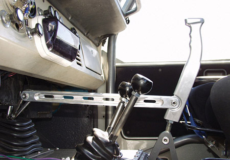

I was thinking the same thing. I've seen the reverse done when trying to clear the dash using an NP435 in 66-77 Broncos. Figured you could do the same under the bench seat. I only knew it by manufacturers name (gearbanger). Remote shifter makes sense now.
http://www.wildhorses4x4.com/images/popup/8305.jpg
That is exactly the sort of thing I have been looking at.
