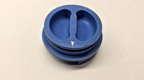

Has anyone come up with a proven process to eliminate the chalkiness on the plastic blue OEM K/5 K/10 Spicer hub dials? Mine are in great condition except for the 53 years of exposure. I do not have plier marks or other defects.
I was thinking of bead blasting or chemically stripping a mediocre spare dial if nobody offers up any info.

I ended up refinishing the dials I have. I experimented with a dial that had plier marks on it. The fading goes deep into the plastic, so milling the surface proved futile. I went with code 523 dark blue paint for a 1972 Chevy truck. Looks authentic enough for this build.

Thanks. Mine were 100x worse than what he started with. Mine were almost white.
