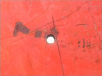

70STOVEBOLT 09-18-2025 10:40 AM
Re: What would you do?
4 Attachment(s)
Here are some pics of the holes and obvious bondo on the door. I think the holes are actually from a previously mounted mirror, as there are only two and they are not in line with where the trim should be. They are pretty good sized holes, 3/8-7/16" diameter. I think I am going to get the DA out and strip the paint and see what I am actually working with.
Chaparralman1974 09-18-2025 01:56 PM
I would give it a try.....
You don't need to be a certified welder. Even a cheapy HF welder can get the job done. You can alway go to the home store and get a cheap piece of 16 gauge sheet steel to practice on. I have been welding since high school and it is a valuable skill to have. Remember, you are not building a structural building or anthing....it is just welding up some holes that you will glaze over with filler.
Also, don't get all wrapped up in how thick the filler is....sure, most shops like to stay under 1/4" thick....and the professional resto shops try to get it even thinner.....about 1/16" due to pride in thier work and ability to master metal working. I spent way too much time worried about the latter and in keeping my filler too thin and confined to smaller areas, you can see those areas under the paint (especially in the bed) where the metal is now too wavy for my liking.
It is only metal......I say, weld it and filler it....then enjoy it. You will have pride in knowing you did it yourself even if it isn't perfect. Just go slow with the welder. It is easier to run the spot welds colder at first and then turn it up vs. starting too hot and burning through the steel. Same goes for grinding....don't focus too much on getting it all ground down at the same time. You have to let the metal cool a bit in between cycles, or you will make it too wavy. Time and patience is your friend here.
Clay

Lost in the 60's 09-19-2025 07:47 AM
A 125 amp mig welder is plenty of power for what you are going to do. The flux core makes it more challenging, but that is where all the advise about practicing comes in. You can get "good enough" for a repair that will get final shaped with filler. It doesn't need to be perfect...;) When welding, let the metal cool naturally and absolutely do not use compressed air to cool hot metal. The pressure can stretch the metal and cause warpage all by itself along with the metal cooling too fast.
The cracks in the old filler actually look like shrinkage from age, which is natural when the filler gets applied too thick i.e. 1/4" is 3-4 times more than you want.
The bubbles are, most likely, rust under the filler/paint and will need to be removed or neutralized before further finishing over that area can be considered.
Yes, sand the entire door panel to bare before making ANY repairs or decisions. I've seen too many people work on just one area of a panel and then move on to find a nightmare they don't want to deal with and all the time spent on the small area repair is wasted, except, it can count for practice...:lol
Post some pics once you have the entire door sanded for us ogle.

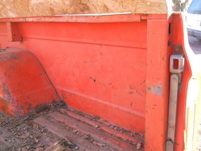

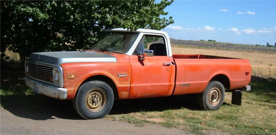

mr48chev 09-20-2025 04:31 AM
I'm late to the party but back when I couldn't weld I would get stuff already to weld up and then take it to a guy I knew who could weld pretty good and he would do the welding and some of the grinding it down and send me home to do the finsh work. I don't suggest learning to weld welding holes in your doors up.
My 71 was my uncles truck for a lot of years and one year my dad bought him an electric drill for Christmas and that poor truck has something like 57 holes drilled in it that shouldn't be there including about 20 on the top of each bed rail where new holes were drilled every time somethign different was used on the truck be it camper shell or cattle racks. I've got replacemen doors because my cousin's kids hit brush and everything else with the mirriors when they learned to drive in it.
https://hosting.photobucket.com/c5e8...720&fit=bounds
This one he mounted a tool box at the back corner of the bed and drilled though the inner and outer panels of the box side.
