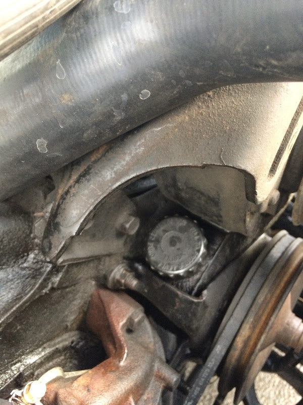

I want to take this bracket off - I'm not sure what used to be connected to the top portion, but it seems to be mostly excess at this point.
There is, however, one spot at the bottom where the PS pump is bolted to it. My question - is this supporting the PS pump, or is the PS pump used as a mounting point for the bracket?
If it is supporting the PS pump, does anyone know if there is a lower bracket for the PS pump that doesn't have all the extra that this one does?
It doesn't look like the PS pump bracket kit from LMC has it: http://www.lmctruck.com/icatalog/cc/full.aspx?Page=150
Thanks!

You are missing some of the rear compressor bracketing parts and the main rear cylinder head-to-compressor brace is being used basically as just a P/S pump bracket.
Here are some images that should help you figure it out:
With non-AC, brace 10 takes the place of all the other parts in the lower RH corner (first dwg). Here is what the P/S pump bracketing for a non-AC truck looks like:
So, if you remove that main rear AC brace you will have to find a brace as above to anchor the outboard rear P/S bracket.

Leave it all there and use spacers under the brackets between the brackets and the header flange. Works fine that way.

That bracket you referenced is for an A6 type of compressor, which was the type before your R4 compressor.
http://documents.holley.com/10925-6hkrrev1.pdf
All you have or do is remove the bolts and slide the exhaust manifold down and out, then slide headers up in place and cut two little spacers to fill the gap between the header flange and the current bracket.

I kept the bracket and cut away all of the extra stuff on it for my stroker engine. I put headers on and still use the bracket, I just don't use a header bolt in that spot, I have the original bolt with spacers under the bracket to keep everything aligned.

Looks like you're only missing the rear compressor bolt and spacer. Power steering pump has three bolts, one pivot and two slotted. As long as there are three bolts holding it you have everything. Those bracket diagrams don't look right to me. This is the best pic I have of what is down there:

You only seem to be missing a couple bolts and the spacer (compressor takes metric bolts btw).
