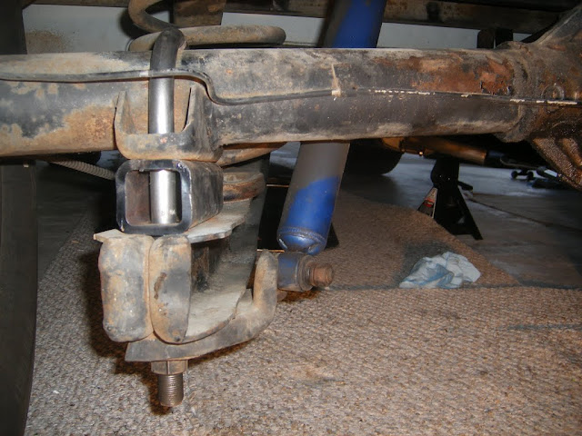

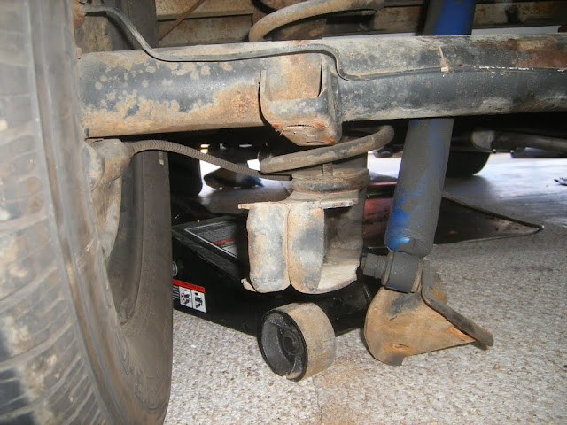

here are the pics of the rear Blocks.
After it was all said and done, it took more time to drill the holes in the thick wall square blocks than it took to do everything else.
Project time - 5 hours
New and Old
New U-bolt - 10 1/2"
The guy who made these for me had to use this length because his machine
was hitting the thread on the 10" bolts I was requesting, I plan on cutting .5" off after the install
Old U-bolt - 7 5/8"
Block - 6 1/2" x 2 3/16 "
Block 5/16" thick
Here I have the old U-bolt sitting on the new U-bolt, you can see the difference in length - 2 3/4"
This is what I used to drill the holes..... I should of never sold my drill press
This was the most painful part... but it was still doable.
The Aftermath!
Stock mounting
U-bolt Removed, I used a floor jack to slowly let the trailing arm down.
Blocks installed!
One thing to note:with a 15" rim these bolts will hit the ground if I get a rear flat So, I'm on the hunt for 18" rims & tires.

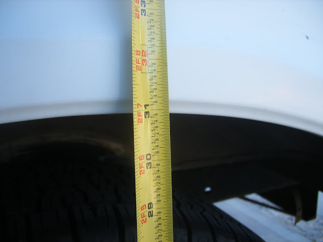

As she sits after the rear drop. she was 32.5" off the ground before
And now she is sitting 30 7/8"
