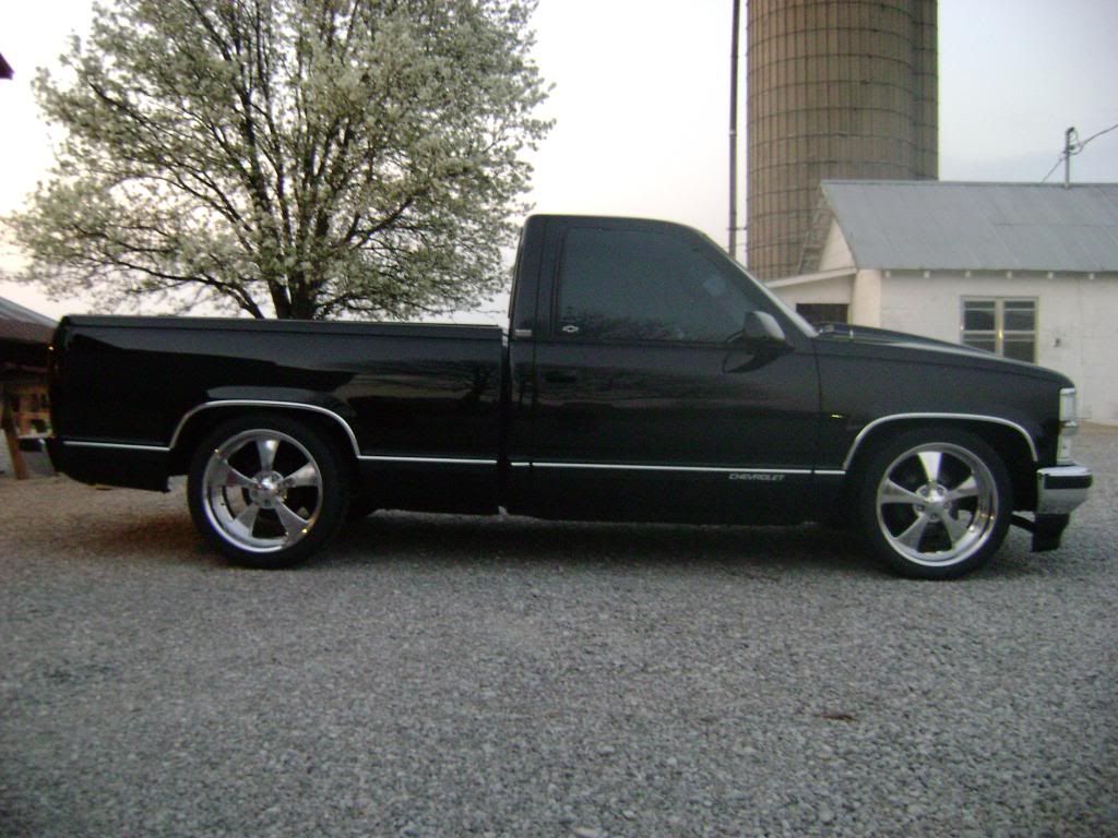

I recently dropped my truck with a 4/6 drop. Spring 2"/spindles 2" in the front and 4" leaf and 2" shackles in the rear with C-notch. For some reason the rear is still higher by about 2" or so. If I am correct do they make hangers that can lower the rear 2" more. If this is true how hard are the stock ones to replace. I would imaging it's grinding of the rivets and putting the new ones. What height is the top of your fender well's for front and rear for those of you who have put a 4/6 drop on your truck. I would like to see how mine compares to yours. My front is 28" and the rear is about 29 3/4". Also what kind would you all recommend?

Heres mine with 4" springs and 2" shackle
and here with flip kit

Thanks 910506chevy Mine looks just like yours with out the flip kit. Nice truck by the way. What kind and size of rims are those on your truck?

Thanks 1badgmc. I didn't know the hangers were the ones in the front I thought they were the ones in the rear. My best bet might be to get stock springs and a flip kit. Or just leave it. It kind of gives it that Hot Rod Look.

Eagle 225
20x8.5 fronts
20x10 rear
