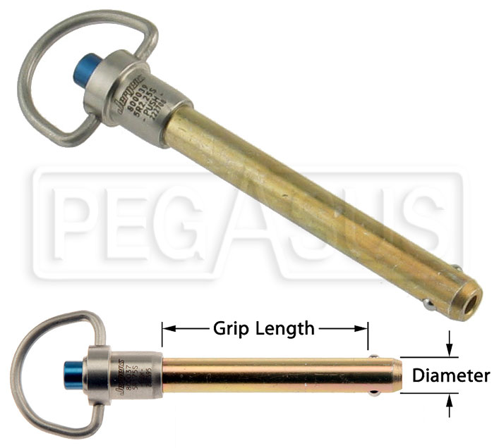

I am thinking of going with some design using these: https://www.pegasusautoracing.com/pr...p?Product=3050
I would put a tight tolerance washer under the tub below the threaded mounting hole. I could weld the washers to a piece of steel, and weld it to the under-body. Then, just drop the pins through the mounting brackets below the seats, and through the bed. When i want to remove the seats, just push the button on the pins, and pull them out of the brackets. i will take a look when we get a day with no rain around here.
