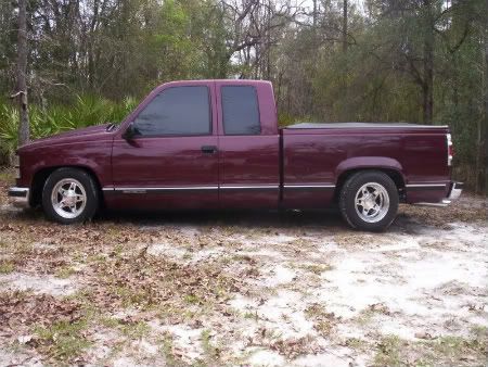

Nice truck Restrorob. What kind of drop do you have on your truck? What I am trying to figure out is if my truck acutally dropped 6" in the rear or if I went more then 4" in th front. Right now my truck sits higher in the rear then the front by about 2". I have 4" drop leaf springs and 2" shackles in the rear but many have said that the drop leaf springs don't really drop it a true 4". I am wanting to possibly get stock springs and shackles to do a flip kit. I just wanted to make sure that I am not already at the same height as what I would get with a flipkit. There was another member that had the same issue and went with a flip kit and then the truck acutally sat level. I guess every truck reacts to a drop a little different compared to the next truck. Thanks for all your help.

Thanks !
What's your measurement on the back now with the drop springs ?
About the only way to know for sure how much drop you achieved would be to measure before and after drop components have been installed.
My rig has a Beltech kit under it, 2" spindles and 2" springs with a 6" flip and C-notch. But..... Mine had a 4.3 before the BB was installed so may be lower by a inch or more from stock ride height, It may be a little difficult to get good idea with my altered rig but hopefully the info has helped a little.....
