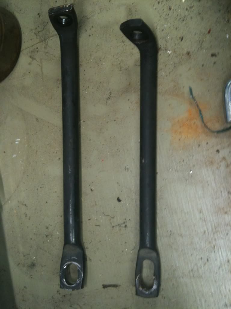

Hey, I'm using the serpentine set up off a '92 on my '68 project. I can't figure out how these braces go. Can someone snap a pic of them on the truck so I can see? Thanks.

Photos of a 1993 from this thread:

Well, I think I can make the one that goes behind the alternator work, but the one that goes straight back from the compressor won't work with my edelbrock intake. Maybe I can modify it to make it work. We'll see.
Do you know where I can get an intake bolt with the upper threaded part to attach that brace to?

I would go to the local U-Pull-It the get the studs you need, especially if I can put together a shopping list. If I needed no other parts I would try the dealer for the studs.
