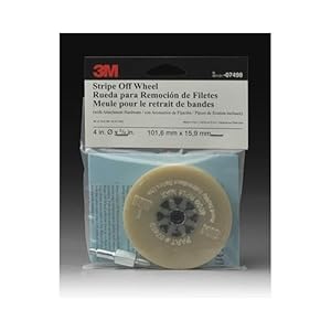

An eraser wheel like this one
Amazon.com: 3M Stripe Off Wheel 07498, 4 in x 5/8... Amazon.com: 3M Stripe Off Wheel 07498, 4 in x 5/8...
is the quickest and easiest way I've found to remove the tape residue left behind after taking off moldings & emblems. Works great for removing vinyl pinstriping tape too.
They zip that molding tape right off without any hand rubbing or chemicals and won't damage the factory paint. Shouldn't damage a repaint that was done with base/clear or urethane either, but you might end up with an area of factory paint showing if the molding was just taped off during the repaint. I've never tried using one on a rattle can paint job but I have a feeling it would damage that type of paint.

...its rattle can with no clear, if it gets damaged, its as easy as "shake n paint" to fix. thanks for the link!
