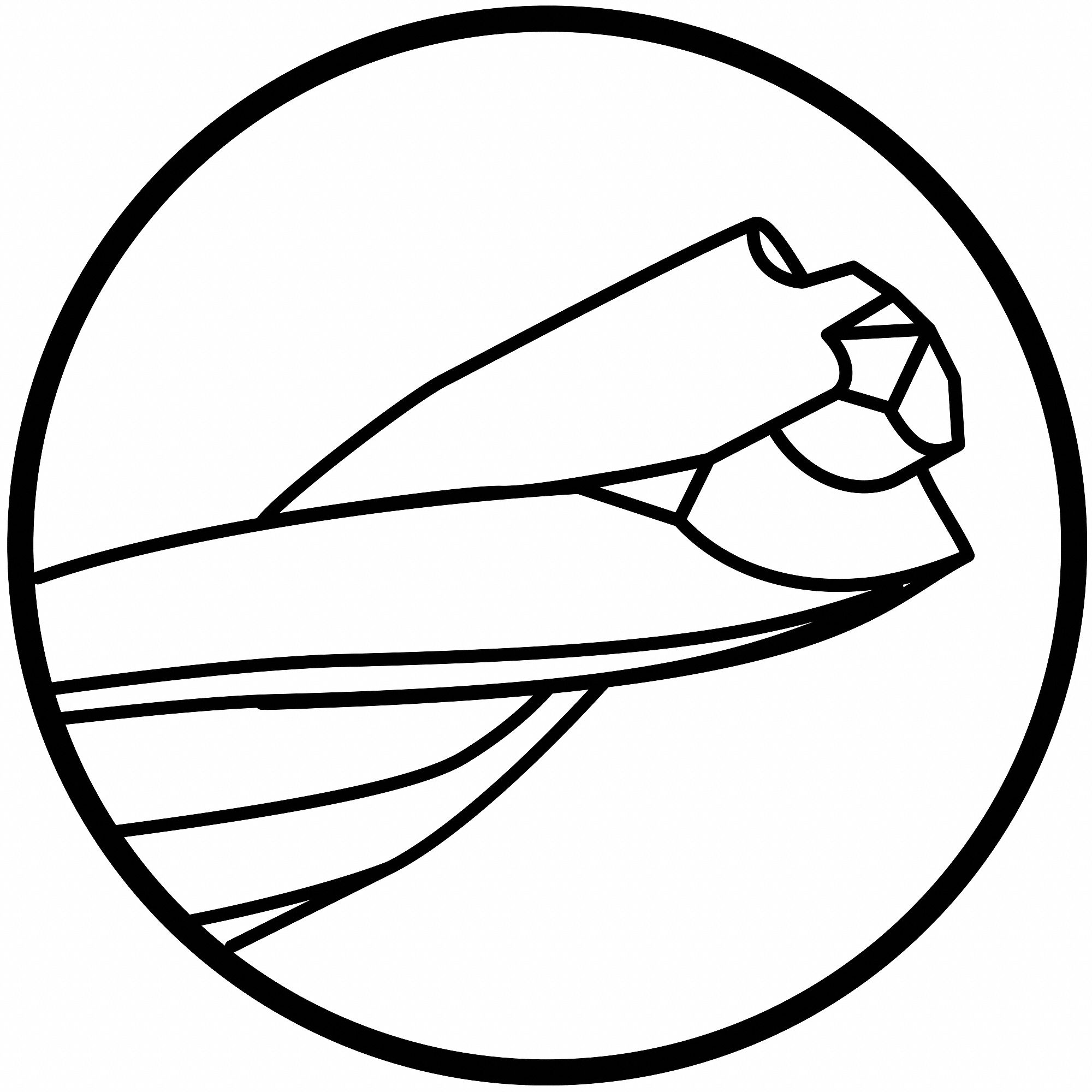

Cobalt Pilot Point drill bits work for this purpose too. They are a bit like an end mill with a small drill bit in the center.
They require a bit more care and slower speed than a spot weld cutter but they leave no, or almost no, metal to be ground or removed.
