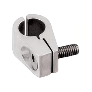

How are you guys attaching the air line to the frame? I want a clean looking install and don't want to zip-tie crap to my frame lol...

There are some nice clamp options, but they will take some work. Plastic clamps would be cheap and easy, but billet clamps are sweet.
I used a metal version of that plastic one with a rubber insert to avoid chaffing on my '69. I drill/tapped all the holes.
Ditto...got mine from Home Depot and used some stainless allen heads to bolt them in.

I perfer nutserts with a clamp similar to those billet ones.......
However, it seems my personal rigs always just get self tappers with the rubber coated generics...
