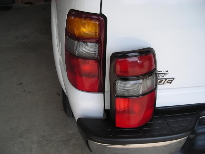

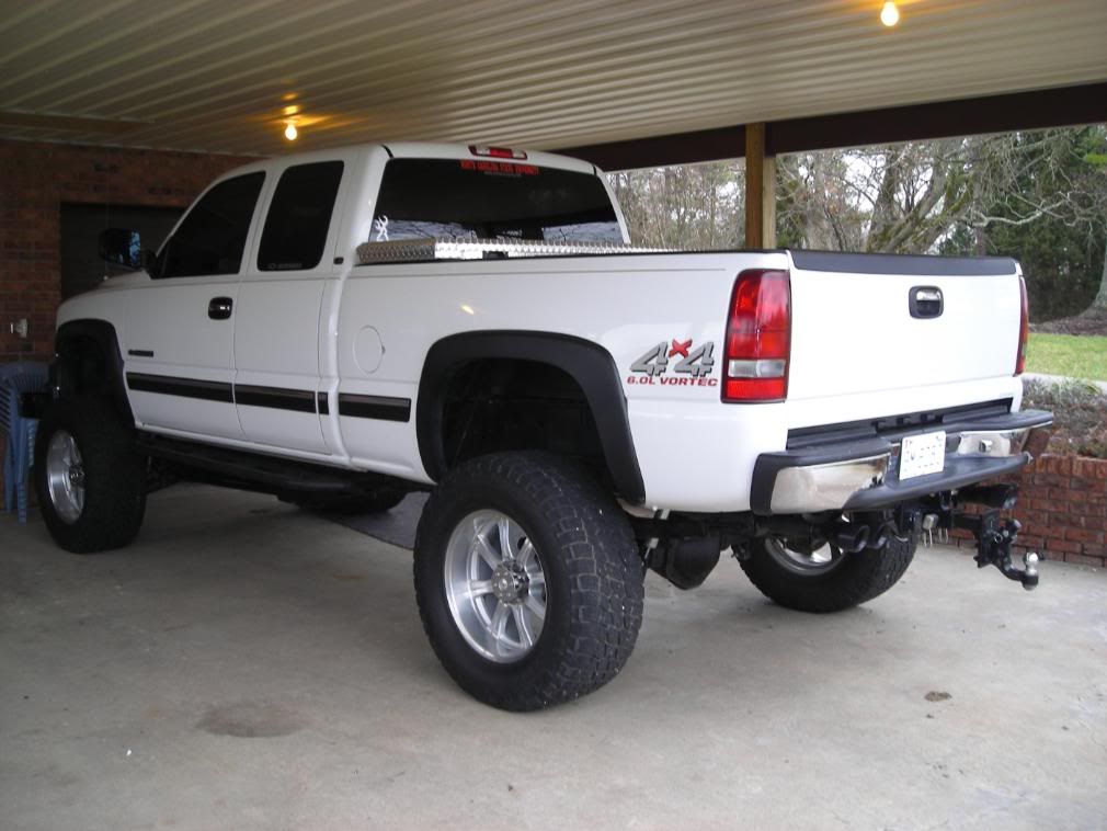

I have candied and smoked several sets.
A set I candied on my 01
Candied and smoked on my 89 Mazda, these weren't buffed, I kinda liked the matte look
The front running lights were also lightly smoked
A few more sets I did
A set I smoked
Some Tahoe tails I candied
Another set I candied

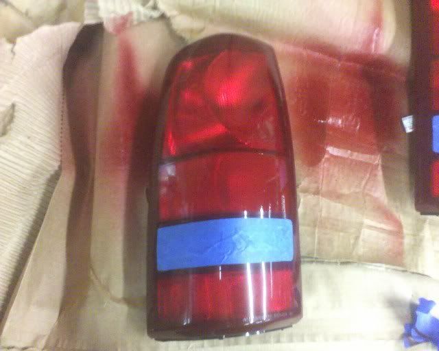

Send me some pics of what you are working with, I might can help you out with it. I'm just not sure after paying to ship them both ways, and my supplies that it would be worth it for you. I have never done a set for another individual, I'm not real sure what to charge, I simply had some extra tails lying around and used them to practice on, then sold them.
The process is really simple, and you could have them done in an afternoon, minus waiting a few days for the paint to fully cure and then buff/polish.
My process I have used is to scuff up the tail light lightly with 800 grit, mask off the areas you don't want coated, use Bulldog Adhesion Promoter to ensure a good bond to the plastic lights, a couple light dustings of that, then for "candying" I use Testors Candy Red transparent paint (available at any hobby/model car store). What I did on the lights with the amber portions, I did 3-4 light coats over the amber portion to get it "close" to the red of the rest of the light. The Testors paint levels nicely, and doesn't build up heavily so masking lines weren't a big issue. Then I removed the masking from everything but the clear reverse section, I allowed it to dry for an hour or so, then wetsanded with 1000 grit to get rid of the hard edge of the masking line. Then I coated the entire light with the Testors red paint a couple coats to make it nice and even, finishing off with a final heavier coat. Now I removed the masking over the clear reverse, again let it dry an hour or so, and wetsanded with 1000 grit again. Then I clear coated them with automotive clear from a gun. Let them dry and cure for several days, then went back with 1000, 1500, and 2000 grit wetsanding, hand polished them and waxed them. Every time I wax my vehicles, I wax the tails to keep them shiny and protected just like the paint on the truck.
If you want smoke, I use the same process, but I take automotive clear and basecoat gloss black, and mix it 10:1 clear:black, and spray it out of a gun. If you do it this way, more clear is not needed after the smoke process. I have also done a set using the "night shades" rattle can stuff found at any parts store, and then followed up with wetsanding, then automotive clear from a gun with good results.
I didn't take enough in progress pics back then, but this is how I had the reverse light taped off, this is after a few coats on the amber signal portion, but before coating the rest of the light to even everything up. The end result is in my posts above.

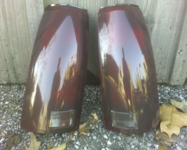

I picked up some Rustoleum "Lens Tint" at Wally's place last nite, tried it out on an old set today. I only did one, and they were real rough to start with. I didn't spend a lot of time on them, just hit the lens with 1500 dry, shot some adhesion promoter, then the tint (2 coats), then 2 coats of clear. You can see the lens was still rough, I think this would work well on a nicer lens. This was justy a test run anyhow, but I think it turned out OK, gonna let them dry a couple days then sand the clear and shoot a couple more coats and see what I get.

I dug out a nicer set and tried to do a decent job on them, finished them last nite and installed today. The pics ain't that good, they look way better live. But I like 'em.

Good job and my thread has been motivational. I looked in wal mart the other day for the tint and did not see it. It need to wet sand mine and buff them the I am going to try and tint them as soon as I get the stuff. Good job on the tails.
PT
PT
Thanks! It's in Auto with the bondo and such. AutoZone has it too. I scuffed with grey Scotchbrite, wax/grease remover, adhesion promoter, couple coats of tint, scuff, 3-4 light clear coats, level out with 220, then 400W/D, then 1000, 1500, 2000, 2500 wet/dry, rubbing compound, polishing compound, 2 coats car wax. I also filed/sanded all the raised DOT stuff off before I started to give a smooth surface there. It was easy after the 220. Post em up when done, and thanks for getting me started
