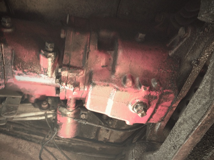

Ok... I have searched and searched and cannot find what this thing is. I am hoping someone has some insight.
It is a 3 speed manual that looks to have a factory overdrive. I know that is not the stock transmission. On the driver side there are these numbers:
GM
10
3743368
B108
On the passenger side there is this number
RIOH-8
Here is a pic. I can climb under and try and take better ones if needed. Thanks in advance for any help!

At first looks, due to the drainplug on the trans it looks like a muncie 3 sp w/overdrive. Can you count the number of bolts on the side plate? If 4 its a muncie mc318 w/overdrive, if 7 bolts its the saginaw. 1st 2 pics are of a muncie (borrowed from a member) and the 2nds pics are of a saginaw
At first look you look to be exactly right! Thanks so much!
I was Googling something fierce but just couldn't track it down.

no problem. its a nonsynchronized 3sp w/overdrive. if you want a synchronized 1st gear on a 3 speed, the saginaw would be the choice. if you dont mind it, the muncie is a good trans, and its the only trans ives ever run in these trucks. i do have a borg t-16 for the big block im dropping in.

I don't mind the non syncro. Just takes some getting used to.
I am finding that parts for this thing aren't easy to come by anymore. I know they make the seal "kits" for the transmission but it looks as if nothing is really available for the OD. No hard parts for either...
After some more research it looks like the OD is a Borg-Warner R10. I gathered that from the R10H-8 stamp. That sound right?
Now I have to contemplate refreshing this guy or finding something new to put in as I would be worried about putting money into with no chance of repair in the future...
