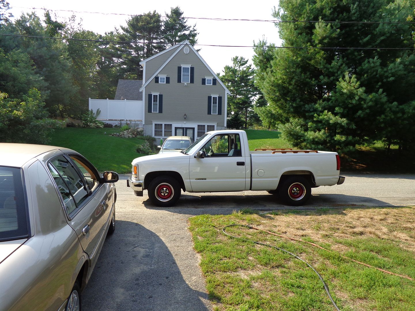

Toonman this is my truck with stock shackles
And with the 2" drop shackles
The truck is going a little downhill in both pics but you should be able to see the difference between the tire and wheel opening.
