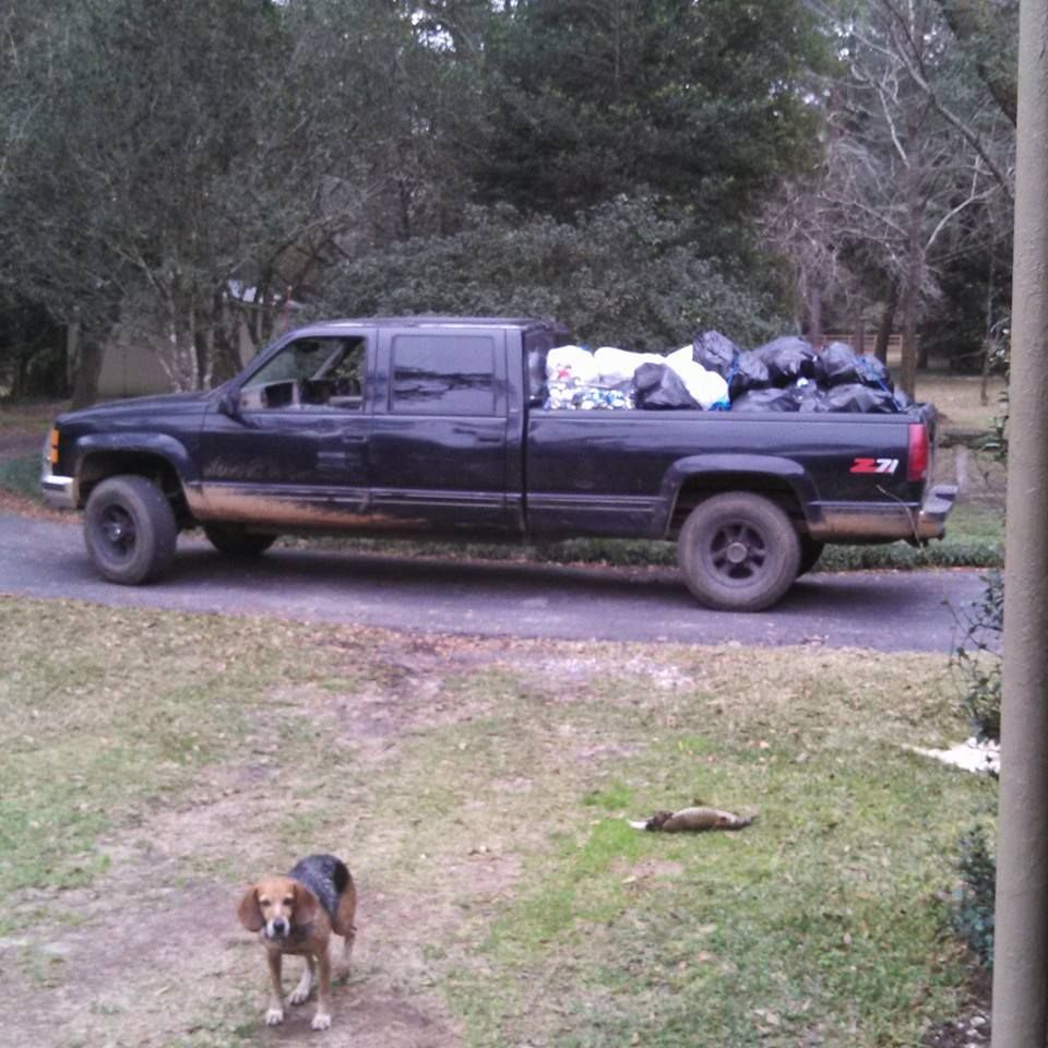

I have a 98 gmc 3500 and the 4wd won't engage in it. The 4wd stopped working about a few weeks ago when it first started to get cold around me. I crawled under the truck and i know the transfer case is engaging, and i also know that no fuses have blowed in the fuse box. I've did some research and I found that the 4wd actuator is a common problem with some of these trucks so today i stopped by the parts house and got one and swapped it out in a parking lot up the street because i was planning on taking it offloading today and the 4wd work…..WRONG lol. I ended up going any was lol. I did some more research on them when i got back and i've come to the conclusion that i just want to bypass it and leave it engaged some how all the time. I found a post somewhere from years back about a guy that did it on his truck. I realize there may be some concerns here with it being engaged all the time but i'm not worried about it.
here is the link- http://www.fullsizechevy.com/forum/g...ld-thread.html
If you scroll all the way down someone says you can do this by putting a 14mm socket on the actuator, I'm wondering is this true? And has any one else built there on 4wd actuator like this?
Here the truck is its self if any one is wondering
98 sierra 3500 crew cab long bed single rear wheal 454 z71
