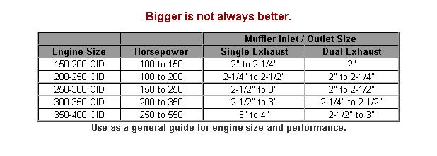

Re: quick exhaust question
Try youtube for examples. I don't know about better, but different for sure.
Bigger isn't necessarily better, either. I think the size you've got is just right for future upgrades.
