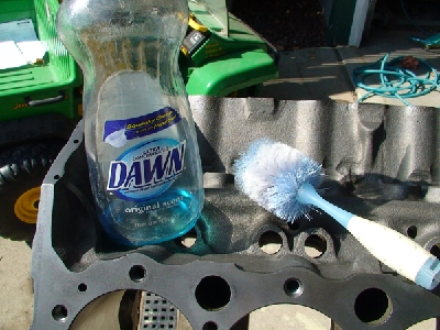

Posts: 3,016
Re: Engine primer and paint
"Dawn - Takes grease out of your way!"
project: "my happy mess"
