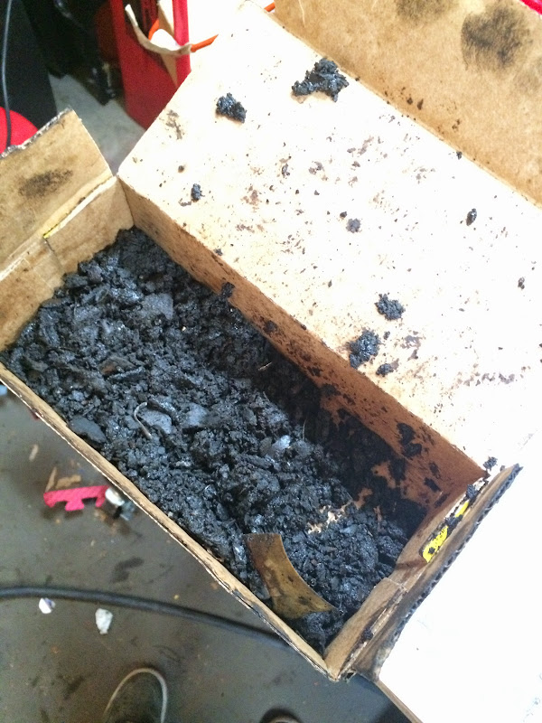

While the paint was drying and I had the truck up on stands, I decided it would be a good time to tackle the huge amount of grease and grime buildup under the front end (particularly on the drivers side as the PS gear had been leaking for evidently a LONG time). I had tried attacking it with degreaser and a pressure washer - didn't make a dent.
So I went at it scraping away all the filth - it was everywhere - core support, front cross-member, frame rail, leaf springs, axle and differential, etc...
Here's some of what came off - horrible -
After a round of scraping I sprayed on some degreaser and let it soak in. Then I went at it with a bucket of warm soapy water and a scrub brush. What a mess. But, it really helped. I'm going to go at it again tomorrow - should come out a lot better.
