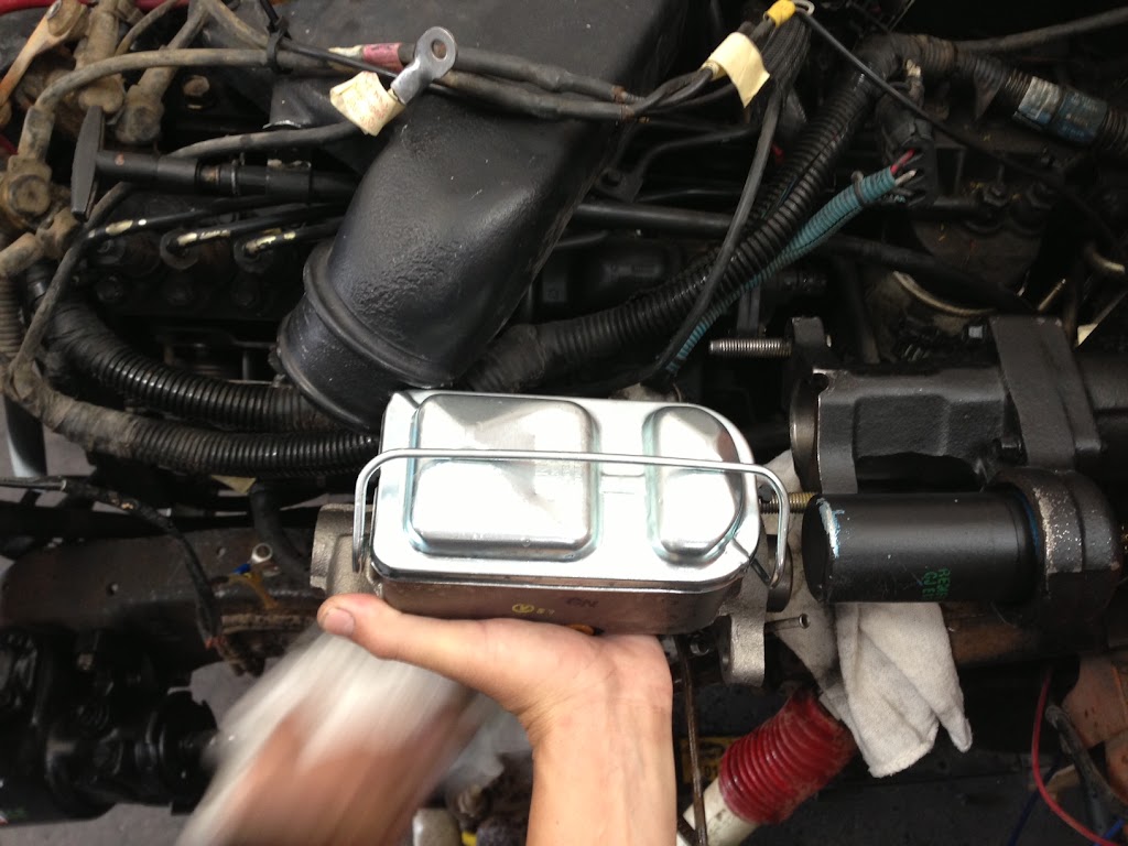

Reaching back in my memory, I don't think you can as it actually hits... The other problem I ran into was that the original intake hit my master cylinder.

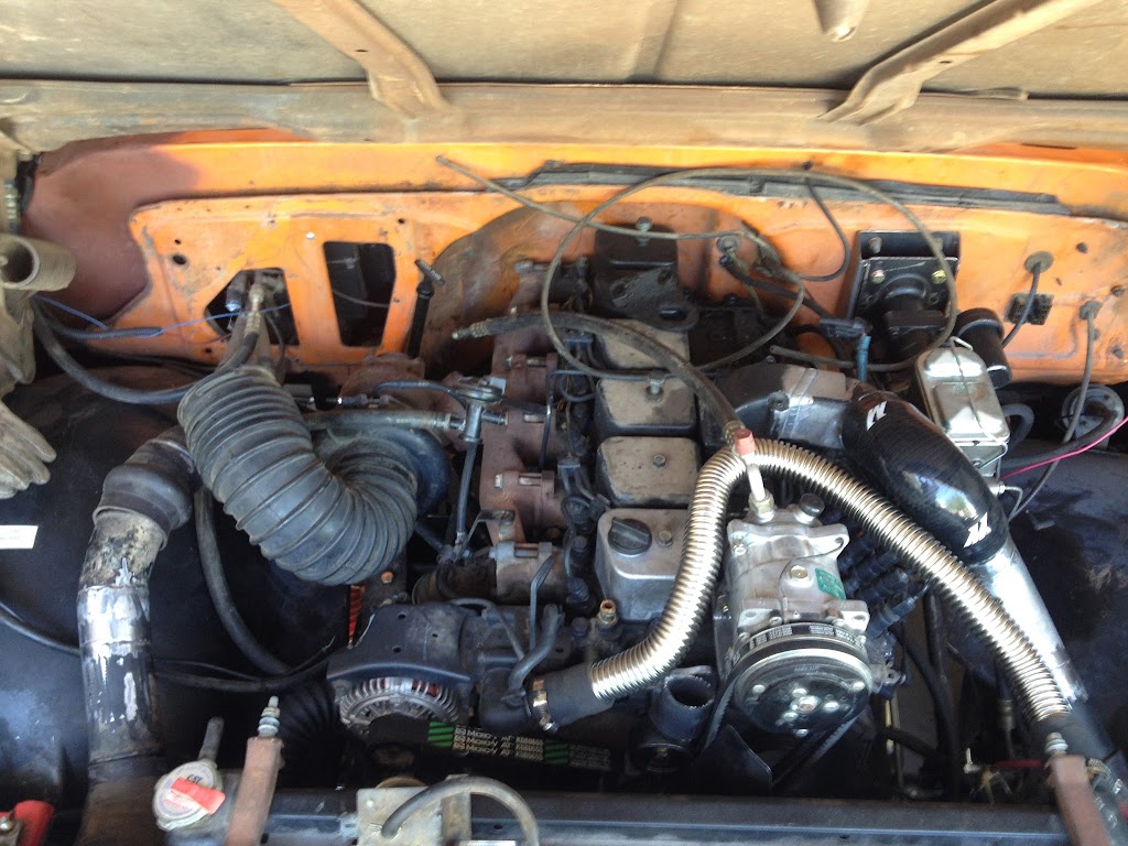

Build a new upper intake if you have to. I've got them in there with the factory booster. With a p-pump engine it's a lot more difficult. That isn't with an autoworld cross member and the intake on that one is from an industrial application.
