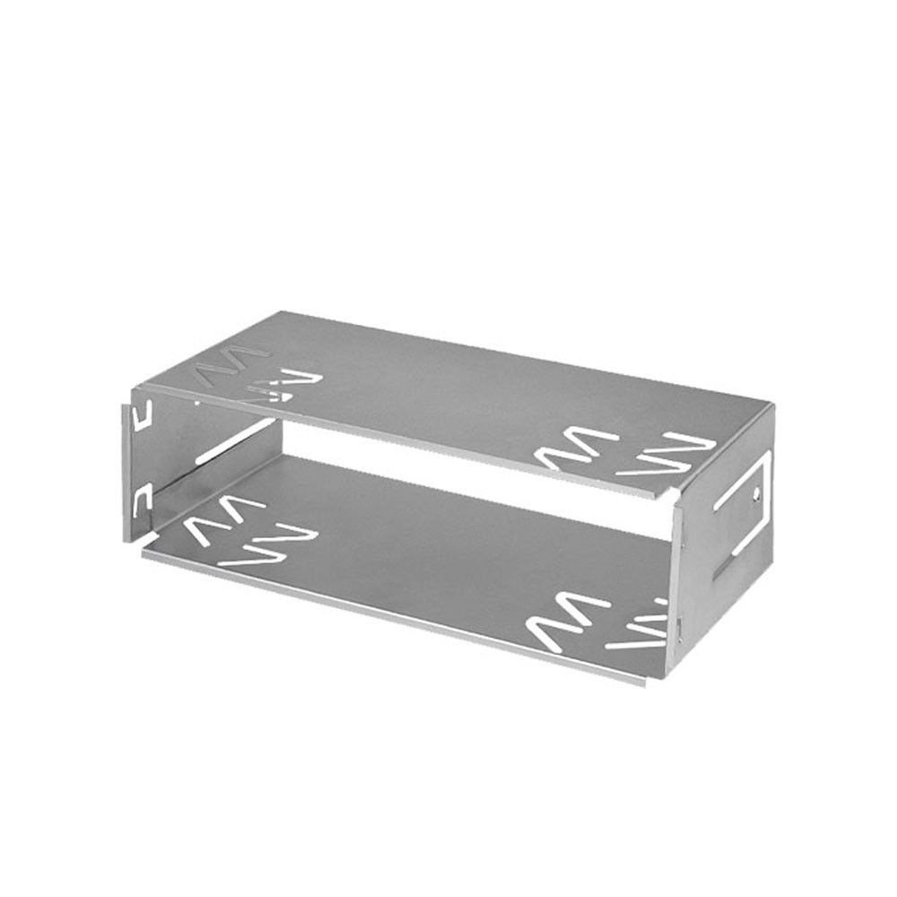

When you buy an aftermarket stereo, it come with a metal sleeve that goes in there. Then the stereo slides into the sleeve. Those little "V" shaped cutouts get bent up behind the dash to hold the sleeve in place. You can get just the sleeve from Amazon or your local stereo shop if you already have a head unit.

there will also be a stud on the back of your stereo head unit for a hanger strap
be sure to use it

Like Ogre said, use that strap that comes with it, these trucks can shake a CD to death, plus it helps with the grounding. Your hole looks about the right size, at least it isn't all butchered up like my 69 i had. The PO of it carved it all up and stuck a Chrysler infinity with a CD out of a 98 Caravan in it. Took me a month of fabricating, and painting to fill the hole to put in a single din CD stereo.

I think you want something like this so you have some options for fitting a head unit:
Amazon.com: Metra 89-30-0900 Din Trim Rings, 4... Amazon.com: Metra 89-30-0900 Din Trim Rings, 4...
If the link does not work, go to Amazon and search for this item: Metra 89-30-0900 Din Trim Rings, 4 Pack
