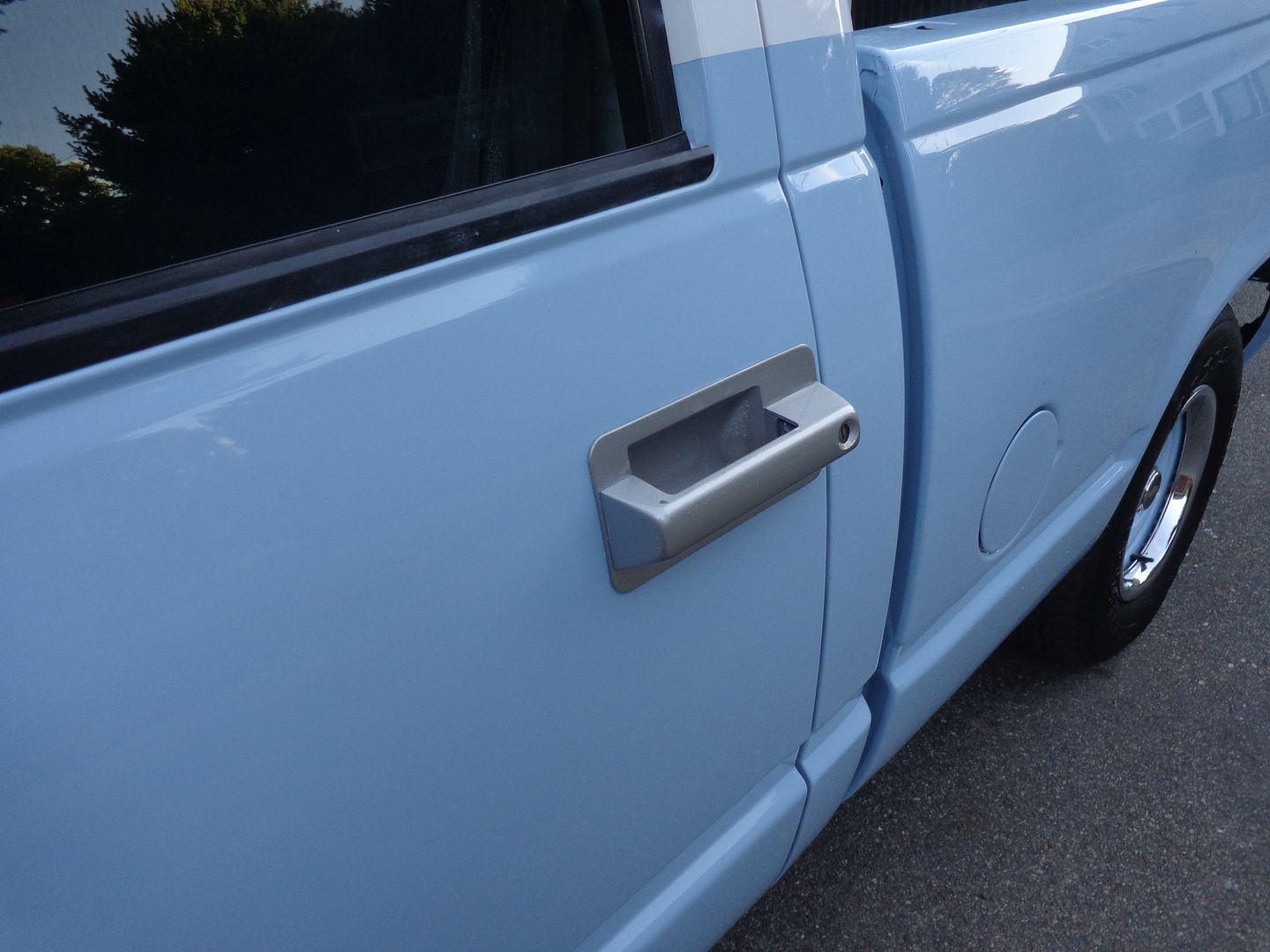

This will solve the outer handle problem forever.
Info?
I just put an aftermarket outer door handle on. Horrible fit.

Sorry for the long wait to reply my notifications have been routed to my spam folder somehow. The handle in post #9 is from a 3500 HD also used on the kodiac series of trucks. The lock from your original handle will work but I had to cut the arm off the lock and weld it on facing the other way. You can most likely just switch the locks left to right but I did the doors a few weeks apart so did what had to be done. I love the way they work ,just pull no lifting.

Where did you get that door handle? Thats really bad ass!

Mine came from a 1999 3500HD my brother had in his back yard. It has a reefer box and he just uses the truck for bait storage for his lobster business. Truck hasn't run for years. They also came on the Kodiac & Topkick series of trucks. The bigger trucks used them as they are higher and it is hard to use the lift handles when the door is so high.
