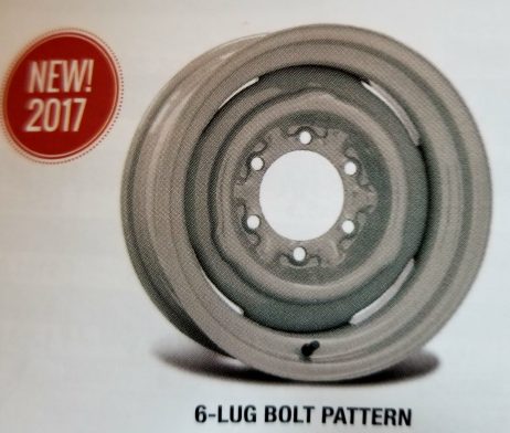

I found a source for brand new 6 lug OE rims that fit disc brakes (not trailer rims)

Re: I found a source for brand new 6 lug OE rims that fit disc brakes (not trailer ri
Oh no!!! The K5 wheels I’ve been hoarding have just plummeted in value!!!
Don't get to worried-
The center hole is 2.75" and the originals are 3.5". They may work on front disc conversions, but will not fit on a rear axle.
The backspacing is 4.25" vs the Military wheels which are 3.875". For those with drop spindles the increased backspacing will not help at all with clearance to the LCA. The Military wheels require LCA trimming as it is.
They're 7" wide, not 8".

If the center hole is only 2.75 then the picture is not of the wheel they are selling. Also the 4 1/4" back spacing would be a no go on my 66. The 4" back spacing wheels on my 66 took a lot of trimming to get to work. Would not feel comfortable trying to make room for a 1/4" more. Now this is with 2 1/2" drop spindles so with stock height applications they would be OK.
I was just notified that the wheel specs on my website were incorrect. The center hole specs were wrong (they were specs for a smaller bolt pattern). And a couple had the backspacing listed wrong. Sorry for the confusion. All the specs have been corrected. Center hole for the 5 lug truck pattern is 3.125 and for the 6 lug pattern is 4.25" Backspace was also corrected to 4.125" for the 15x8's.

Here is a picture of the actual wheels. 15x10 on the left and a 15x8 on the right.
