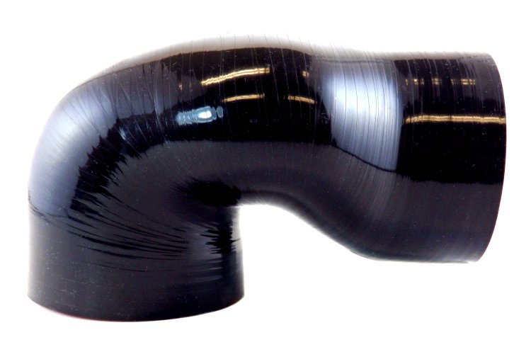

Cobra head 90?

Re: Air intake clearance
Originally Posted by BR3W CITY View Post
Cobra head 90?
Where do you find this??? Just what I need

here's the cobrahead 90 brew is talking about....
https://www.maperformance.com/produc...xoCO80QAvD_BwE
and some more.....http://www.intakehoses.com/mm5/merch..._Code=CobraSil
