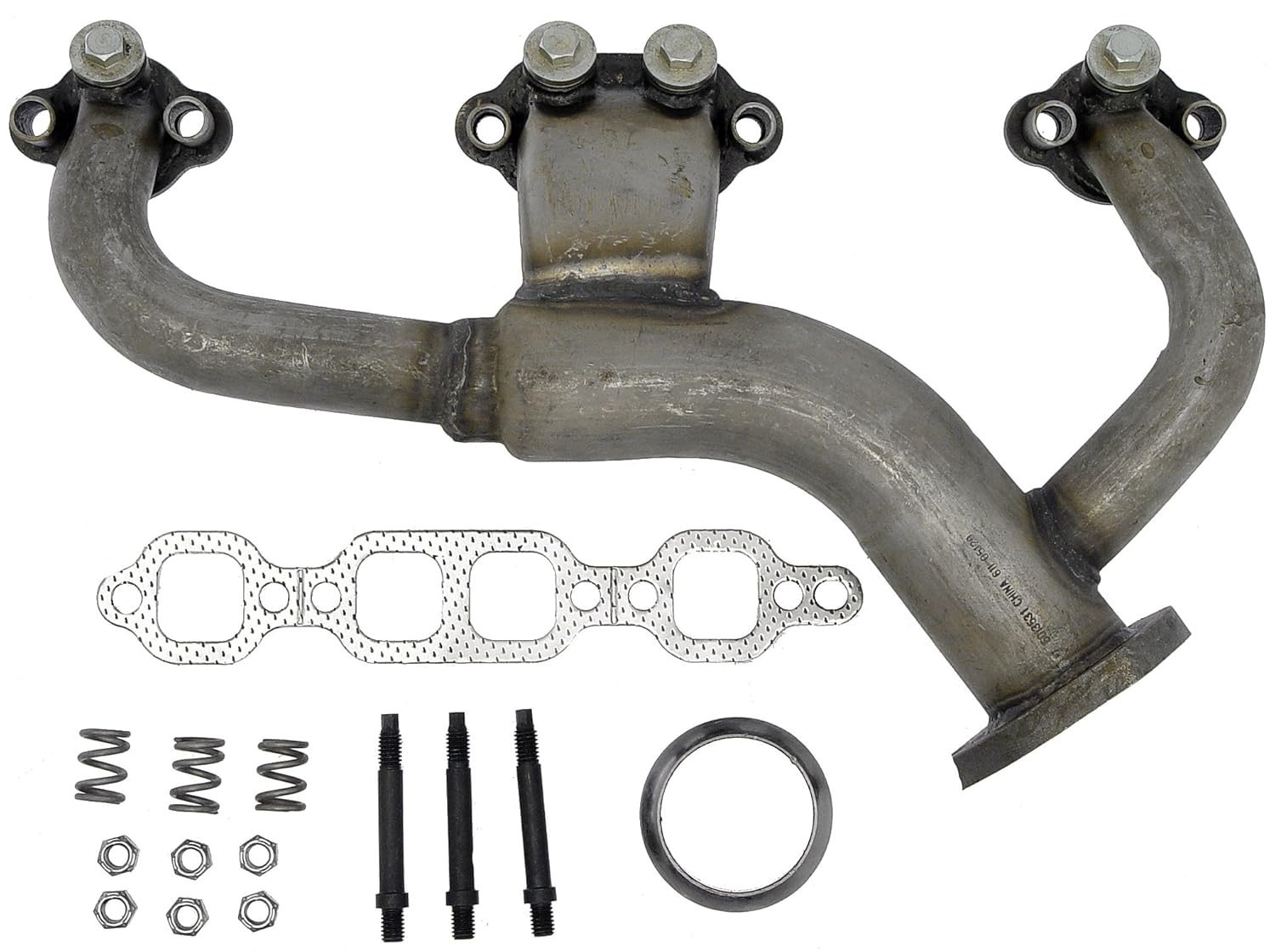

Check out Dorman 674-530 and 674-531. They are a copy of a factory tubular manifold on late '80s trucks and do have ports for AIR injection.

Might as well run headers....those are the same style steel with flange vs the oem cast iron that doesn't warp.
As for something different- nobody makes one that I'm aware of because if people are going to spend full aftermarket part price for something they want aftermarket performance from it not just slightly more then stock, at least that's how I see it.
