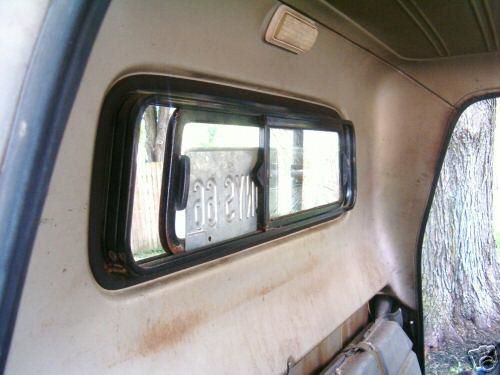

Now I've got an original slider. Two panes of glass in a metal frame that juts into the cab. The 63 never see's bad weather. Picture is from another truck that I tried to buy just the slider. The glass was cracked and the spring loaded knob was missing. The guy refused $600.00 on it. Ya should have seen the rest of this truck! It was finished but he wanted to keep it together. Wanted $6,000.00 for the whole thing! Found mine on Ebay for $175.00 USD. plus shipping. Dirtydonnys didn't want to sell to international buyers, so we ended up finding a guy here in Montreal, who's father lived in Boston. We had him buy it, shipped to Boston, then transported to Montreal 2 months later. My life changed then because I'd been looking for a slider for 24+ years, thought I was going to die when the Ebay advertisement displayed No International Bidders!
