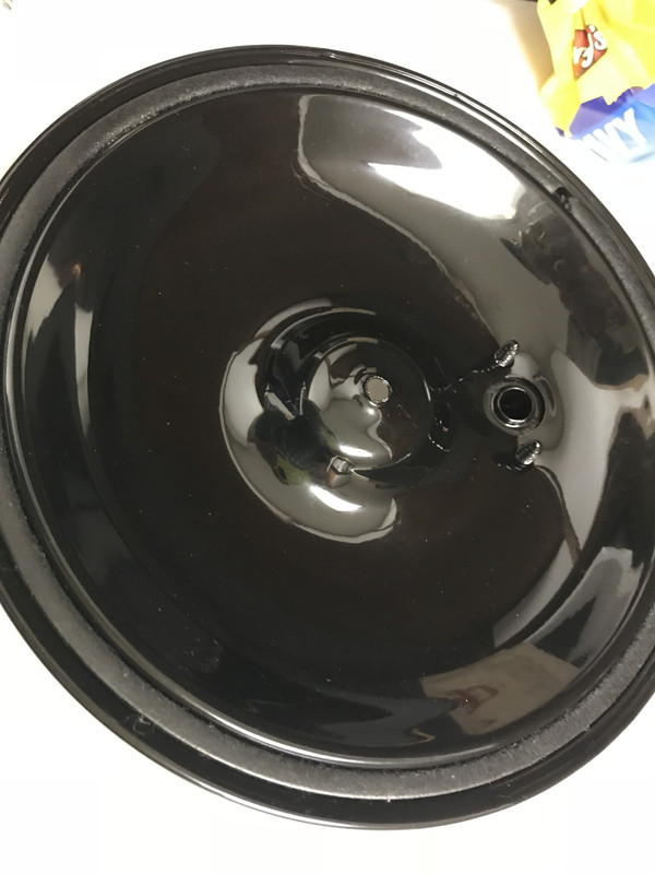

The top of the air-filter that sits on to of the bottom case holding the filter, where can I buy that rubber round "O" ring gasket that seals to top cover (on bottom of top of the lid cover) to main bottom case which houses the actual air-filter.
I called LMC truck and no one knew its almost 7"3/4 - 8" inches in diameter, I did a search online and did not find anything.
Anyone know?

Here is what I did tonight, I flipped the older gasket around and used pliobond and reused it. There's a small gap due to shrinkage, do you think this will work? There's a small gap there.
dolphans1 is offline   Reply With Quote

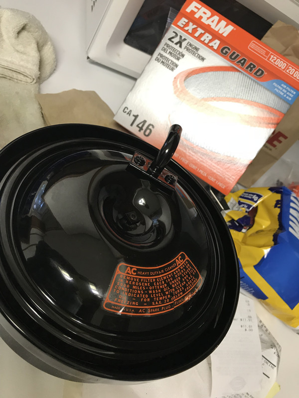

Here's my set-up.
