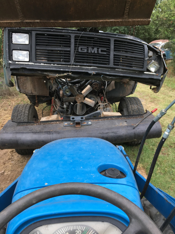

Looking for advise on a potential body swap I’d like to do. Had both of these trucks (with titles) sitting around for some time.
The 84 has a rust free trashed body but a great 54,000 mile, 350/400? running drive train.
The 1981 is a rust free 2 wheel drive 454/400 that are gone.
My question, is this a straight up swap? No modifications?
Thanks!

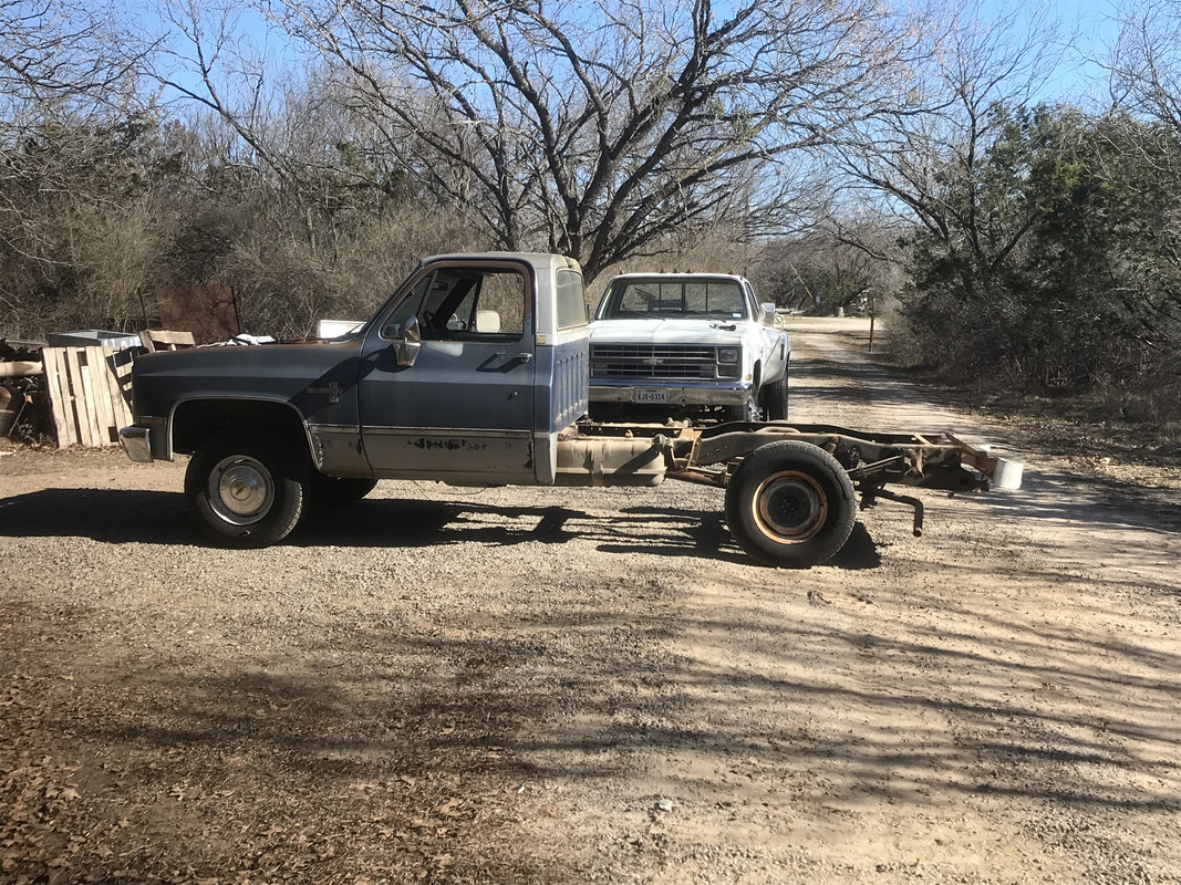

Old 01-06-2020, 02:01 PM   #14
Re: I’d like to swap 84 4X4 frame with 81 2X4 body, easy?
Just reviving this ol’ thread to see how everything worked out....finally started my swap.
