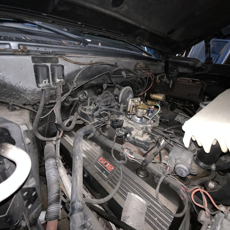

Reviving an ol’ thread,
I’m struggling with my original 88 V30, 454, no start.... fuel issue. Ran great until I filled up at the station and then no start. Bed is lifted, pump replaced even thou the old one worked. Took off the tank selector cover on the frame rail and unplugged the electrical connector, with key on I get about 7.4 volts to only 1 pin. Switching from one tank to another makes no difference. The fuel pump relay on fire wall energizes after about 2 seconds of turning key on. I suspected a bad oil pressure switch behind the distributor but can’t locate it. I only suspect because of reading the service manual. I’m very weak with electrical stuff and schematics.
Old 12-08-2020, 07:34 PM   #11
Re: Stock location - oil pressure sender?
The previous owner put the valve covers on, it’s a stock 454, 22,000 original miles.
