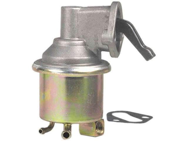

This it? Picture looks the same.
1972-1974 Chevrolet C10 Pickup Fuel Pump Carter
https://www.partsgeek.com/gbproducts...QaAtS6EALw_wcB

Hi Andy,
That is what I am more or less looking at on RockAuto (and other sites) for a 3-line Fuel pump for a 72 C10 350. I am pretty sure that lower can is longer than what is installed on my C10 with a 3-line hookup.
On my 72 truck (the way I got it) it has a Short 3-line Fuel pump but all the short ones are 2-Lines (for a C10 72). Parts store list only a Long Fuel pump for 3-lines. Sticking with Delphi, this is a part number of MF0055 on RockAuto.
Since clearly they make a Short 3-Line Fuel Pump and I found it on RockAuto for a 72 Nova but it is also called out for a 73 C10. This Delphi part number is MF0002.
I looked at my Chevy manuals and I only found one place about the Fuel Pump and it was only a few pages long and only showed the short two line version.

The 71-72 had the emission stuff on them that maybe what the third line is for.

Summit has them. For all small block motor no matter what the vehicle is. They all will work.

that is one big photo!
Yep, I can see how to get one for sure and I am 100% sure you are correct about the emission stuff with the 3-line.
What took me down this rabbit hole was ordering from GMCPauls the correct hard fuel line between carb and fuel pump. He has quite a few options for a 350. Long, Short, with or without A/C. The thing is, Paul doesn't have one listed for Short Fuel Pump with A/C.
I just clicked away and ordered a "Pump To Carb Stainless Steel Line SB V8 W/Long Pump & A/C listed for 1971-72". Then I thought, wait, my pump didn't seem very "Long" how could it be shorter??? So this is where I am at now.... Get the wrong line, it will not route right and be too short.
Anyways, I am fussing about getting the correct pump and hard line - might as do it correctly (is what I been thinking).

Yea that is correct you will need the right one. Are you going hard line all the way to the carburetor? If not just cut the top off and put a half flare on it and rubber gas line with a in line filter call it good.

Yes, hardline from Pump to Qjet 4BB.
So it seems if I get the one that I actually ordered from GMCPaul's (hardline that is), a 72 3-Line Long Fuel Pump is in order... or at least that is how I am reading the tea leaves.
Really wished I knew how it got a short fuel pump or if there was some last moment change with the 72 C10 Emissions (fuel vapor canister lines) where they sub the 3-line long with a 3-line short. They are surely around for 72 (on the Nova, Monte Carlo and then starting for the 73 C10).

Another note, if going to a 3-Line Long Fuel Pump, it would be about 1 1/2 longer (closer to the ground). That is going by Delphi dimensions of 4.5 x 3.5 x 6 inches (Short MF0002) and 4.2 x 4.2 x 7.5 inches (Long MF0055).
Also the Short is 9 PSI (Average Flow Rating/GP of 40) and the Long is 8 PSI (Average Flow Rating /GP of 65)
Not sure if the PSI/GP is any kind of factor at all. I guess these are not 5 PSI since they are 3-line (I swear I read the carb was suppose to have 5 PSI).
Lastly here is a photo, the lines from the fuel take (hard to soft) appear to match up at the correct level for this Short guy. I'd image there would be a downward slop with the long.... maybe my soft lines would not reach properly?
