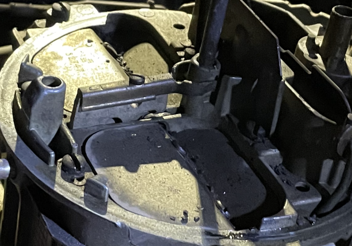

Think this may be the problem No tellin home much got sucked in

Just discovered the charcoal canister sent crap into the carb. Saw all these, what I thought were mouse turds, turned out to be charcoal hah! Hopefully on the road soon, we’ll see...

Back on the road, made it to Blythe. I found a real cool guy within walking distance of the truck, he took carb off and rebuilt it this morning. It had all kinds of charcoal inside. Runs like a top.....so far. Slept ( not much) in the cab last night, bailing early today.

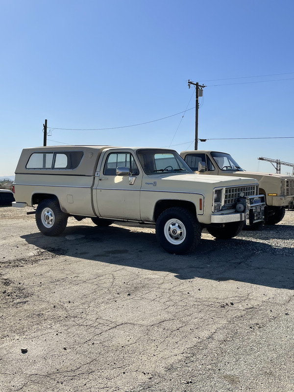

Re: 1980 K20, 350 with a Quadrajet has left me stranded....

Oh, that's nice!
(but it's probably an automatic...?)
Nice truck

Wow, sweet truck. I'd say it is worth the journey.
Turbo 400, I have a couple of trucks with the SM465, I don’t mind an automatic now and then

Original paint, darn near all original except for the 350. Zero rust, ever...135,000 miles.

I like it. Is the winch an 8274 or 8074?
