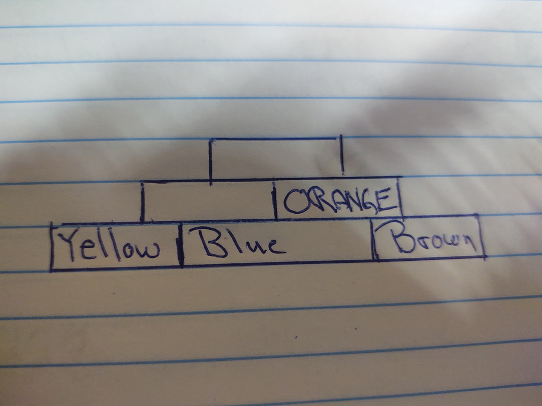

Could someone tell me the correct wire placement on this connector? I can't quite figure it out by the picture above. Correct my diagram below. This would be looking at the back of the connector.

This is correct.

Yellow on top,orange,then brown,blue on the inside as per my picture

Which is as my picture shows, thanks for your help. I just swapped my wires and the blower now works on all 3 speeds.
