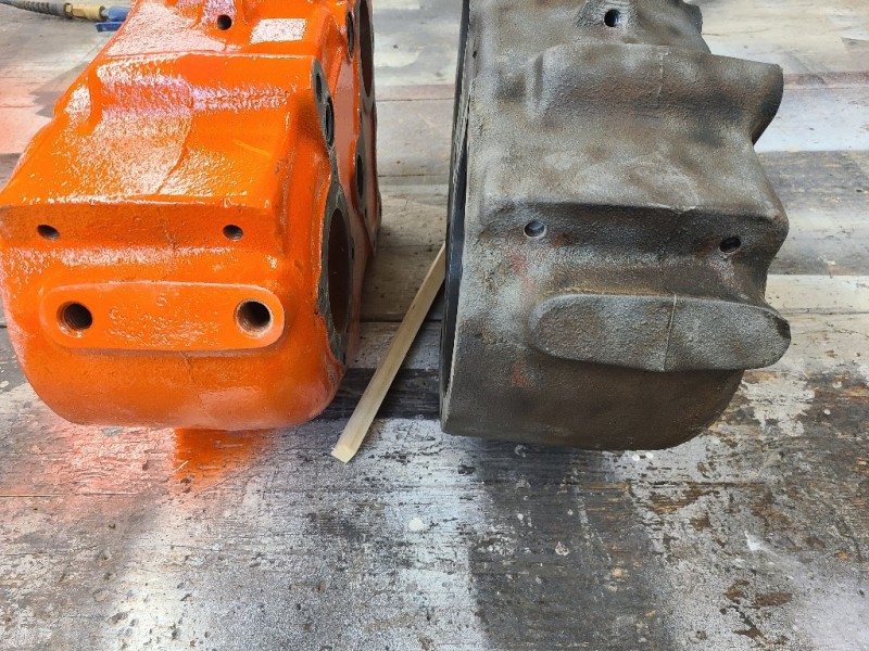

I purchased a case on ebay to replace my cracked one. Everything seems the same except there are no mounting holes for mounting bolts..what am I missing here ?

That's not really a "mounting point". A support brace goes from there, up the side of the engine block and across the starter. Most of them get removed during the first starter replacement and never reinstalled.

Those holes have a bracket that bolts to them and the frame with bushings. That bracket can be a heated topic amongst 205 lovers. Some associate the bracket to causing cracked transmission/transfer case adaptors and pitch them asap. Others swear they would never run without them because it’ll crack the adaptor… I’ve run them and not run them and never broke an adaptor… go figure. Point being those holes aren’t necessary if you don’t mind not running the bracket.
So there is enough support with it just bolted to adapter ?

Yes alot of people say do not put the bracket on

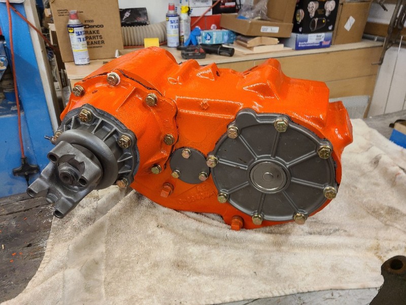

Johnl48
Join Date: Jun 2021
Location: West milford nj
Posts: 360
Re: Transfer case question

Originally Posted by Johnl48 View Post
Hell yea man that looks awesome.
