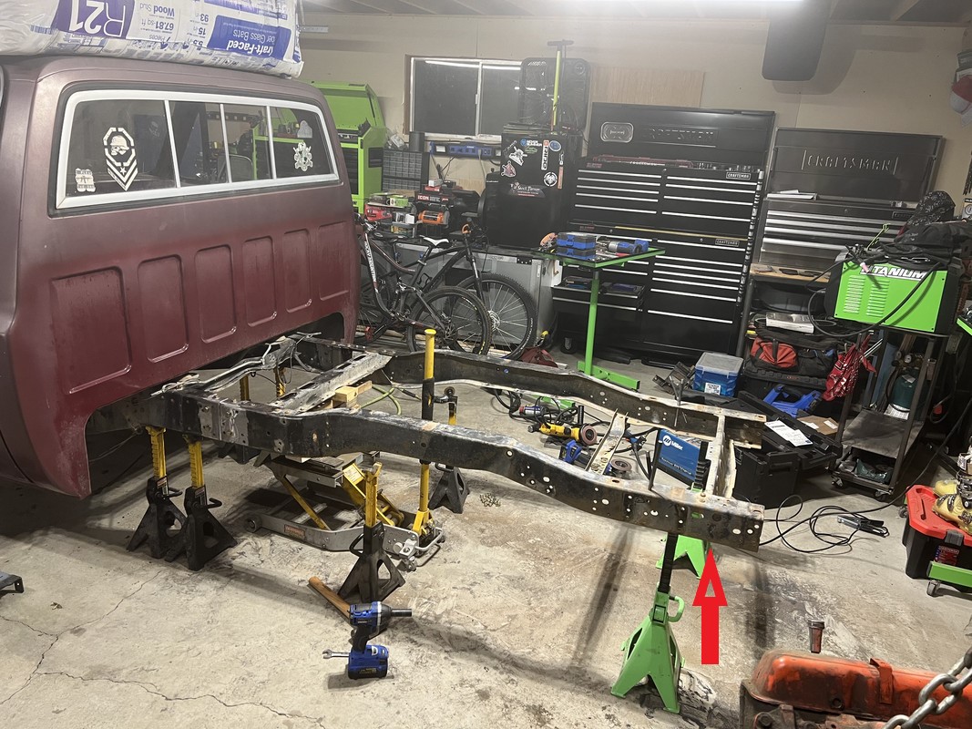

Greatly appreciate all the info man, could I bug you for one more measurement? At the rear, to the bottom side of the frame at the crossmember behind the rear tires (arrow in pic)

I measured in line the the two rivets on the underside of the frame that hold that rear cross member in place. Height is approximately 17.5"
I'm just sitting in my garage which is by no means a perfectly flat surface, and I don't have the same amount in fuel in both tanks.
