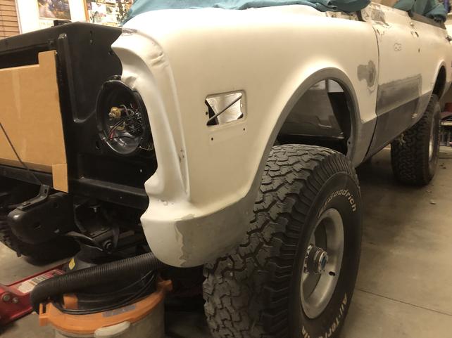

NDM is offline   Reply With Quote
Old 01-25-2024, 10:41 PM   #274
7D2N
7D2N's Avatar
Join Date: Aug 2007
Location: Morgan County Utah
Posts: 812
Re: My winter project
Originally Posted by NDM View Post
Do you have a photo of the cracks? I want to see it it is the same area as mine.
I'll have to look, this is the finished repair of the cracks.
Just for the fun of it
7D2N is offline   Reply With Quote
Old 01-25-2024, 10:55 PM   #275
7D2N
7D2N's Avatar
Join Date: Aug 2007
Posts: 812
I started the filler and sanding.
