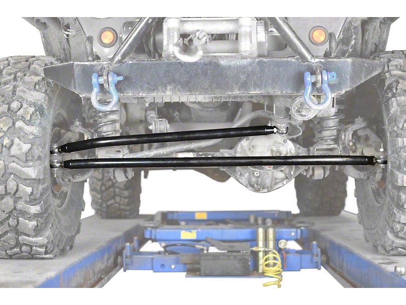

Generally the steering box is connected to the knuckles through linkage that has minimal length change as the axle moves. One way to do this is to connect the steering box to the RH wheel through a long drag link then use a long tie rod to connect the LH wheel. Jeep used this scheme in multiple vehicles.
This kit provides an aftermarket improvement for vehicles with more suspension travel and lift:
