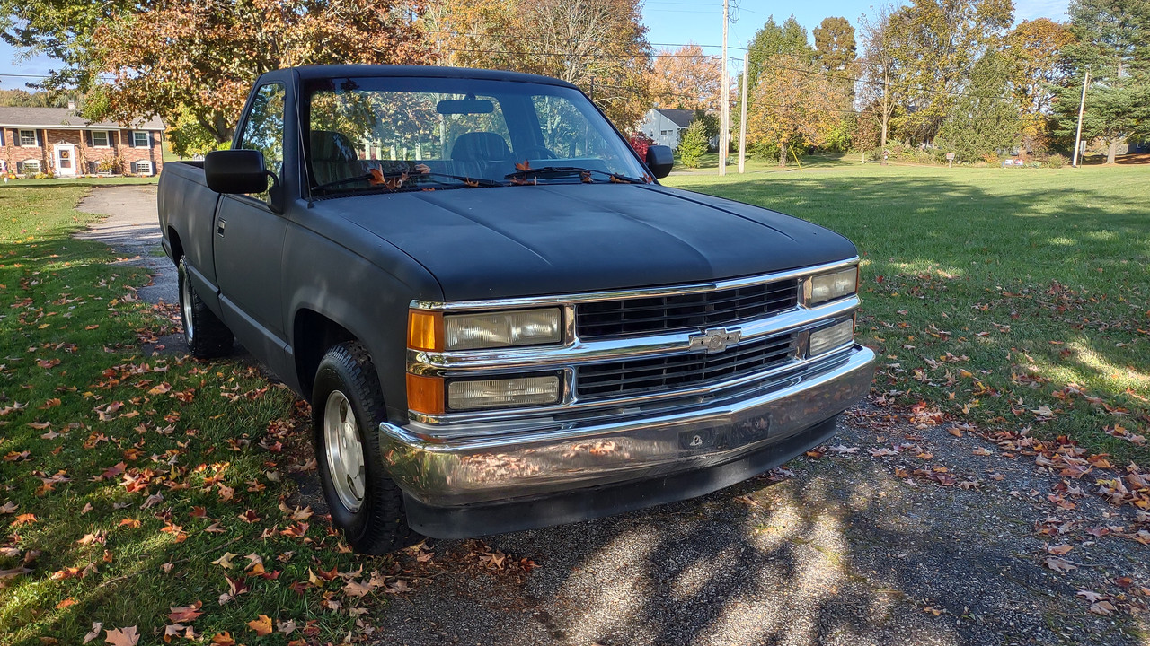

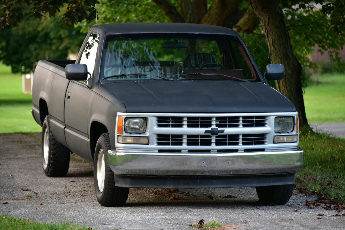

I put on a used grill that came with head lights and all.
Here is the old and then the new...

Yes that looks fantastic. Hopefully your conversion was straight forward. I did the same conversion and for me it changed the entire look of my truck also.

I am a fan of your original look, but it does look good with your new(ish) grill and all!
